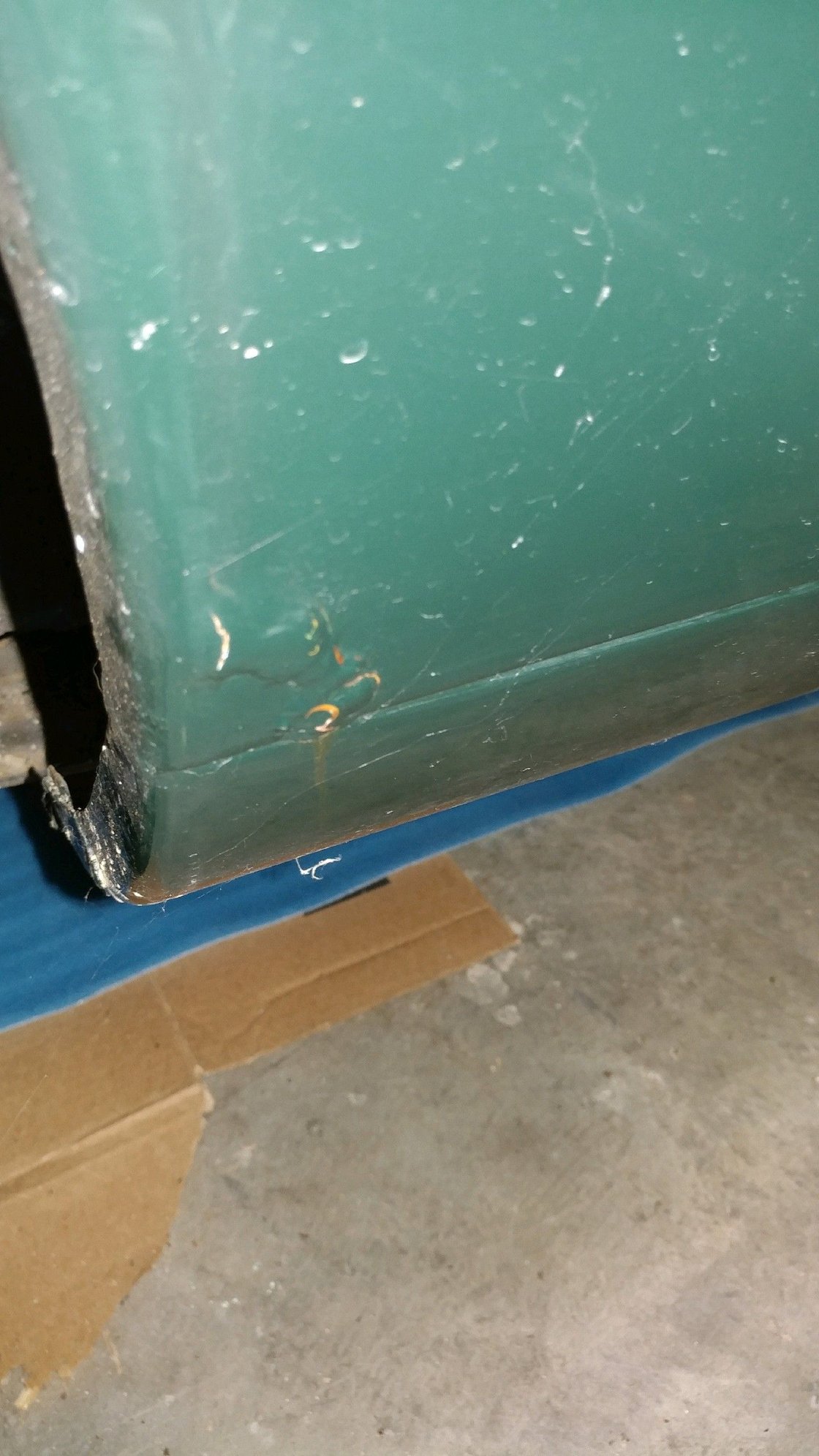

The only spot of rust I could find, other than just surface rust where a bolt that tightens something down had scratched off the paint under and right next to the head of the bolt, was one little spot about the size of the tip of my thumb by the passenger side rear fender well. Could probably be easily remedied and patched and re-sprayed. At such a low position on the car, it'd be harder to see the spot that was painted.

Sorry for the long post but I wanted to try and be thorough to get some good accurate opinions. The pics are his that he snapped, from his ad. The rust bubble is what I took today, because that's the only rust I could find.

Ski slope is the center console plate which is normally finished with wood veneer. Price looks fair. Since I'm not a body man the rust spot would be my major concern.

That bubbling on the front corner of the rear wheel arch is potentially serious, and not that easy to repair nicely. Pull up the carpets inside the car and take a very good look at the floorpans.
Can you do the refurb work yourself and do you have a covered space to do it in? You will have about $3000 worth of mechanical parts to get this car right and lots of work: New suspension rubbers all round, new shock s, full fluid change, new tyres, renew brakes, renew fuel system rubbers throughout, full fluid changes throughout, lots of electrical ground and connector plug cleaning, full ignition system refurb (dizzy internals, vac capsule, vac tubes, plugs HT leads, etc etc).
I think the inside looks good, and the paint, and if no rust apart from the wheelarch (and you can attack and fix this yourself) and your long term hobby is going to be looking after this car, then somewhere around the $2000/2500 mark is reasonable. But do not be under any illusions, these cars are wonderful but need constant looking after!
