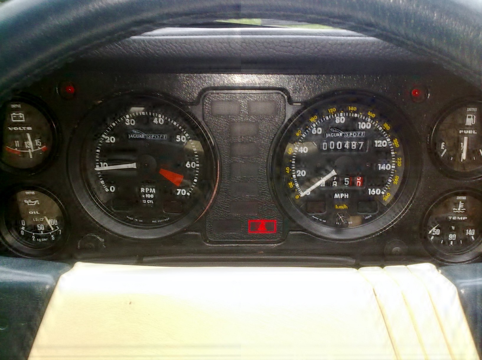

I fitted d a banham dash years ago and have a light and a proper oil gauge if you zoom in on the pic it shows the capillary tube for the oil pressure gauge
Attached Thumbnails 'The Ice Princess' No Oil Pressure! Help!!!!-wp_20171224_20_37_38_pro.jpg   'The Ice Princess' No Oil Pressure! Help!!!!-c__data_users_defapps_appdata_internetexplorer_temp_saved-images_26122014012.jpg

Hi rgp
Very nice but I do like the barrel gauge dash, though an under bonnet/hood Oil Pressure Gauge would seem a good idea
And Thanks to your Pic, I think I can see how it goes
