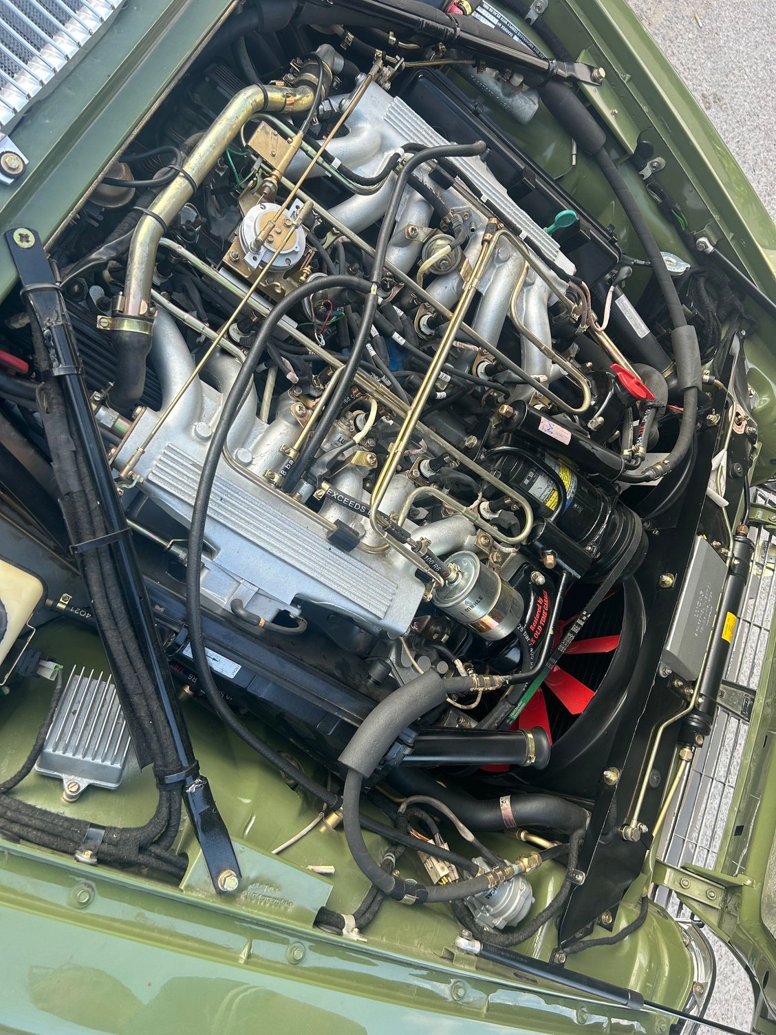

Dear all,
We have problem with starting engine after changing all injectors.
The new one are Bosch 0280150163 (EAC7875),
the old one Bosch 0280150035. We did it as regular maintenance, before that engine run quite well.
the only way to start engine is with unpluged vacuum from manifold presume sensor Lucas 73163A, but engine don’t work well on high Rpm.
Maybe manifold pressure sensor needs some adjustment? Or just injectors are not the right one?
Best regards,
Stan

I think that you have fitted injectors for the HE verion of the engine. The correct ones, I think, for the pre HE are:
Bosch 0280150035
Nice new set on UK ebay:
https://www.ebay.co.uk/itm/335481130...Bk9SR4TUqKezZA
Your engine and engine bay looks superb!

Stan,
Just wanted to say that your engine bay looks great!
Well done!
Paul
