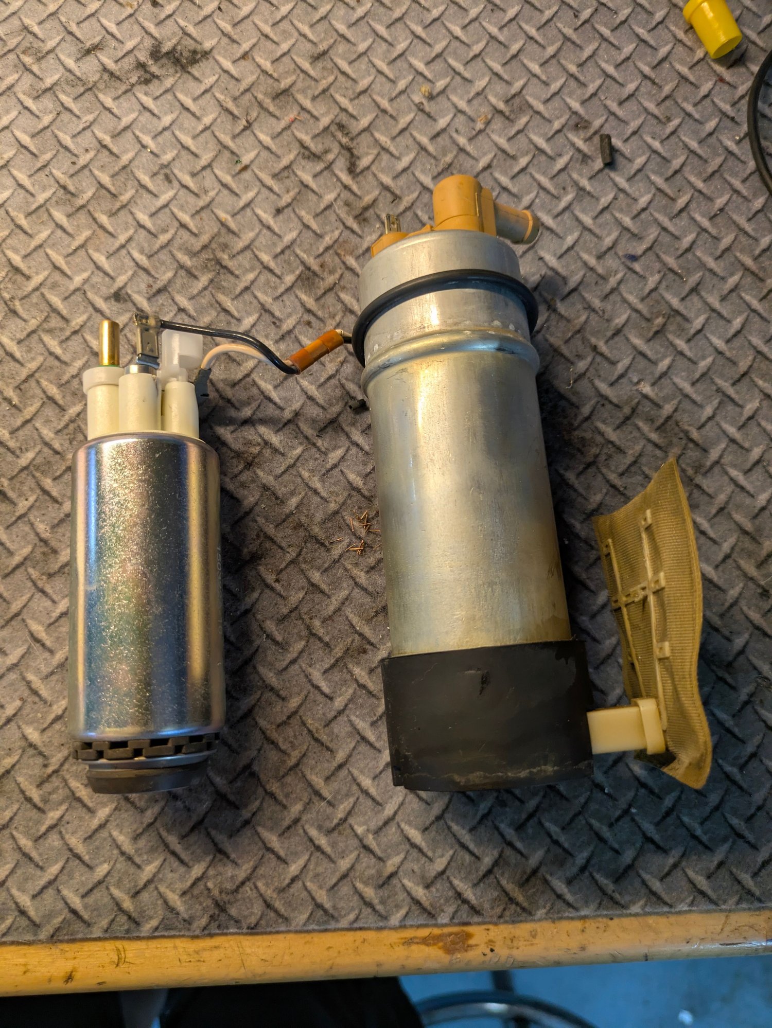

I agree, Steve. Although I don't need to worry about the wiring in the car I'm working on, as the Pump problem seems to be resolved; the flylead on "my" one went direct from the Multilocks in the top right corner of the boot, direct to the plug shown in my photo without any joins or that taped connection that yours shows, kansanbrit. I might politely suggest that you want to undo that tape and see what's connected in there, as I don't think there should be any wiring connections prior to the plug on the tank.
Paul
Paul
Standard pump on the left, XJR pump on the right.
