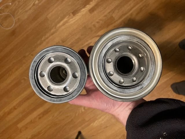

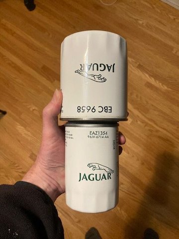

Since the last engines to use that one are now 23 years old, youngest, and demand is down, they are dearer.
Not quite! Rolls Royce used the same filter up to 2002, Bentley to 2010. The later Jaguar V8 filters can also be used on the earlier V12 and 6. The filter OD is smaller, but the thread and gasket size is the same.

V12/6 filter vs the V8 filter:
