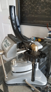

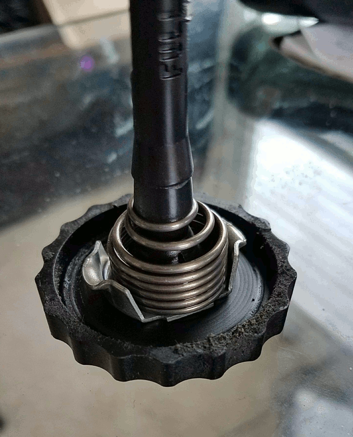

Anyway, the modified cap is complete.
The photo tells most of the story.
The cap/dipstick combination, as it turns out, is hollow, except at the very top where the dipstick meets the cap. I bored out the dipstick just to give a little more room for adding fluid, and of course bored all the way through the cap.
I had a 90 degree brass bend in the garage, so I bored into the top of the cap about 5mm. I then "threaded" one end of the bend, just using a file to put some diagonal cuts in it. I then heated the cap with a heat gun, then put the bend on top of it, pushed down and turned. As hoped, my *threads* cut into the plastic and seated fairly well.
Next steps were to cut the dipstick off just below the "Full Cold" mark, and attach a piece of 3/8" ID fuel hose to the bend. Not shown is an aluminum tube that is stuck into the other end of the fuel hose, and which ends near the oil filler cap. I put a rubber terminator (similar to what is used to block vacuum ports) on the top of the aluminum tube to keep dirt out.
The epoxy is to stop any air leaks.
Operation is pretty simple. To determine the fluid lever, I simply blow into the tube. If I hear bubbles, then the fluid is very close to the "Full Cold" mark. If I don't hear bubbles, the fluid is below the full cold mark. If so I pour a small amount fluid down the tube, go do something else for a few minutes, come back and blow into the tube again. If I here bubbles I'm done, if not repeat step 1.
The caveats are that I can't check the fluid hot (which is no big deal), and that I have to be in a fairly quiet place to hear the bubbles. Since I garage the car for various maintenance tasks 3 or 4 times a year, I can just check it then.
No, it's not very elegant. But it is very cheap, has no moving parts, no sensors or electronics to mess with, and took all of an hour to put together.
Not a modification most would need I know.
Thanks,
John
