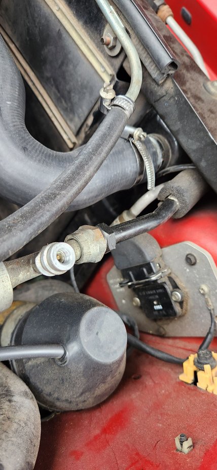

so I got home today and popped the hood, saw a retrofit placard on the hood, but nothing written on it...but are these not the 134 ports?
Old May 14, 2025 | 04:33 PM
motorcarman's Avatar
Posts: 13,646
Likes: 9,583
From: Wise County,TX
Already Refrigerant 134a fitted to your car.
Diagnose your A/C problem and get it going!

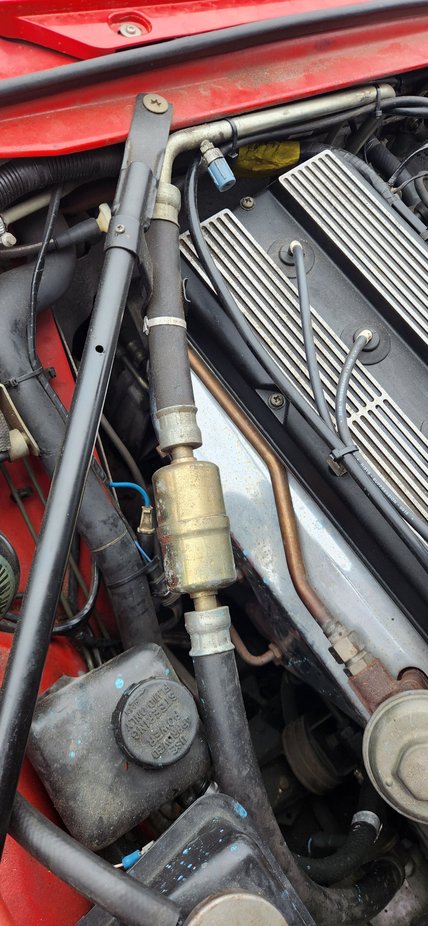

well that's good news...I don't see the clutch engaging so I'm guessing its just low on refrigerant. Waiting on new gauge set to arrive tomorrow to check that. Is that metal tube on the low pressure line the dryer? the replacements seem to be long black tubes.
edit....it's a muffler...dryer is in the front of the radiator.

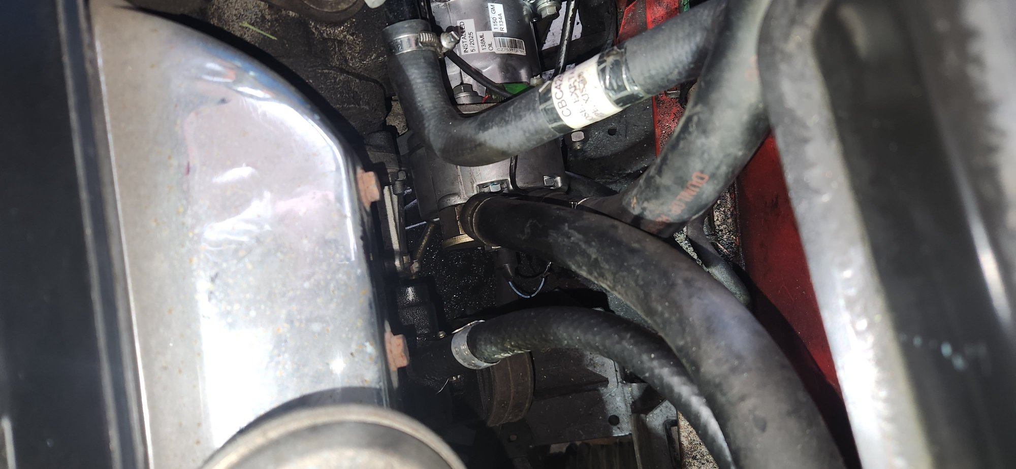

So I installed a new compressor, dryer, and the ever to be cursed at...expansion valve. Can someone confirm I have the two lines to the rear of the compressor connected. High pressure line is on the bottom, but the picture is sideway...so on the right as well Thanks...
