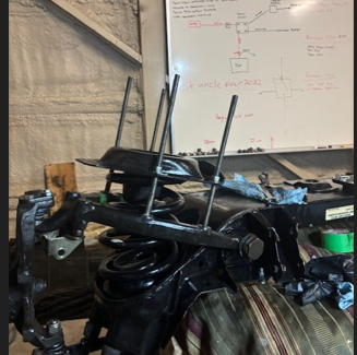

Just jumping on to share my frustrations as I'm sure I'm not the first one to despise the removal and install of the front springs on the XJS.
I've been very excited about the front sub-assembly rebuild and, candidly, found the removal of the springs to be a tedious process. For me, I found the rod method worked and, although slow, allowed me to work through removal and installation without being killed by a flying spring.
The installation is a horrible process with those last two inboard bolts being extremely hard to insert as the holes don't line up exactly as they should. So imagine my joy when the installation was done...it was short lived. My helper (17 year old) went to torque some bolts and misread/lacked common sense and tightened the lower ball joint bolts (x4) to 62Nm (of course one broke before I saw what he was doing). So I removed the spring, extracted the broken bolt, and put it back together...painful.
Then (and this is the mistake I own), as I'm cleaning up the shop area I find two spacers from the RHS......sigh...I remember installing 3 on the LHS and only seeing one for the RHS and thinking (that's odd, but maybe that's just the way it is). Now that I found the other two in the shop I realize I'll be pulling a spring again...At least I'm getting really good at it!
Sigh..anyways...just sharing my joys.

In my experience, much easier to install/remove with assembly installed and the car on the ground.
floor jack under spring seat piece, lift car, remove bolts, slowly lower car.
putting it back, i used the threaded rods to keep everything aligned, used the floor jack again, put bolts back, job done.
i know this wont help you now, maybe put together as is and add the spacer later.

Great advice and I think I’m going to have to take care of it. On the side without the shims, I’m noticing the part that rotates on the ball joints (not sure of the name but the hub attaches to it) seems very tight. I’m thinking that without the spacers it may be pinching just enough to restrict movement?

Floor jack method is well tested, standard floor jack fits into the recess on the spring plate. Ive done it a few times, there is zero danger.
all tension is off the spring very quickly(maybe a few inches below the A arm).
i was worried about it going “boing” too, it was much less eventful than expected.
you can run without any spacers, shouldnt affect anything, they are there to adjust height, mine had 3 per side(2 top, 1 bottom). I think I removed 2 per side, maybe 1…i need to count the leftover ones in the garage

If the assembly is off the car, you will need threaded rods or the official tool, this is obvious,
but if you simply want to change springs and the assembly is on the car, use a floor jack and save yourself a lot of time(you will
still need the rods for alignment on reassembly)

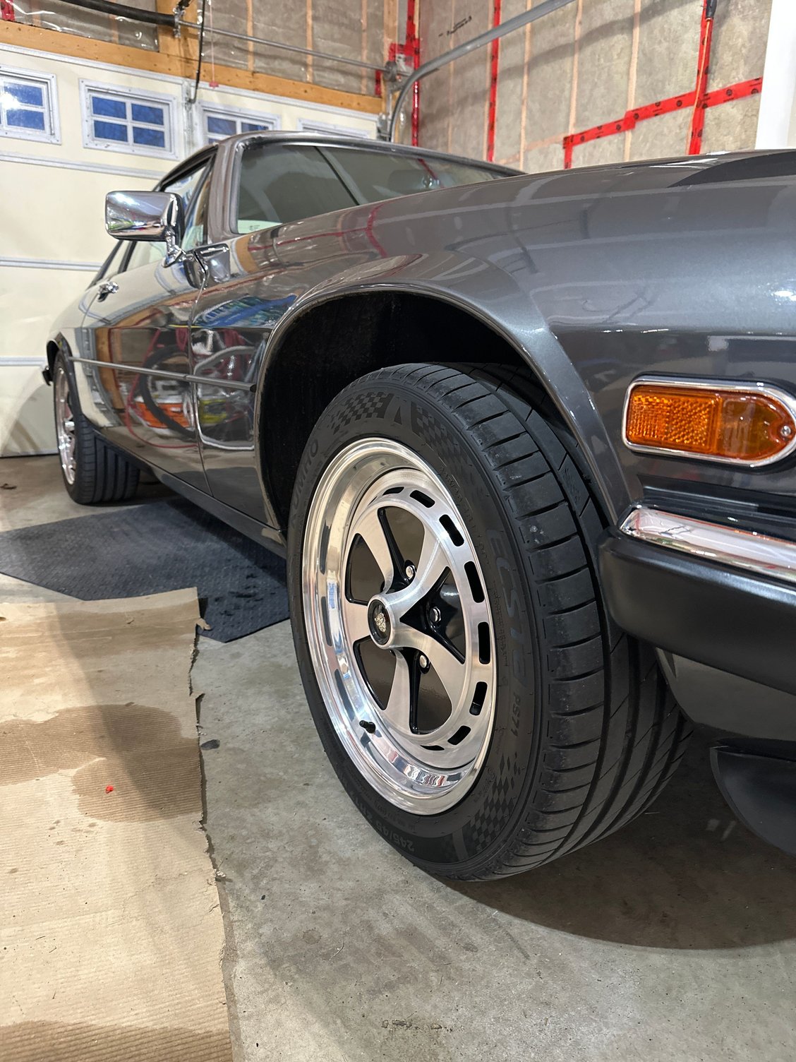

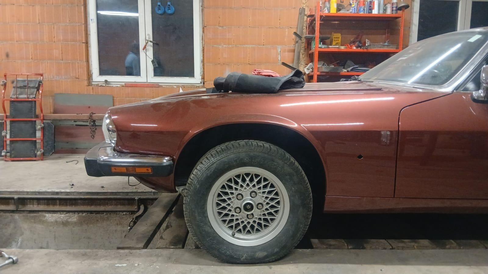

1. So I defenetly can confirm the method Nick shared. It works flawlessly, nothing snaps, nothing shoots out in the garage. You only have to put first under the the car`s jacking points (or at least under the front ones) some woods or anything else to lift the front about 20 cm, in order to have space for the jack to get much lower down than the normal sitting position of the car, when you fully decompress the springs and change them.
2. Unfortunately for me I didn`t get the result I wanted, which was the REASON I wanted to change the front springs, so if anybody knows the answer, pls tell me cause I`m going crazy on this !
When I bought the car the nose was a bit to high ... I presumed the late owner might have mounted V12 springs, so on a lighter car (mine is 4.0) it`s obvious they won`t compress to the normal level. So I ordered at David Manners those "DB7" Eibach springs, mounted them today ... THE NOSE SITS EVEN HIGHER !!! I understand it will set down with 2 cm ... but I need at least 4, if not 5 cm ! If you look at the picture attached, it looks like a "off-road XJS", the gap is HUGE !
Does anybody know the cause ? Is there some "trick" I don`t know ? Could it be possible I put something in a wrong position when I reassembled back the front axle ?

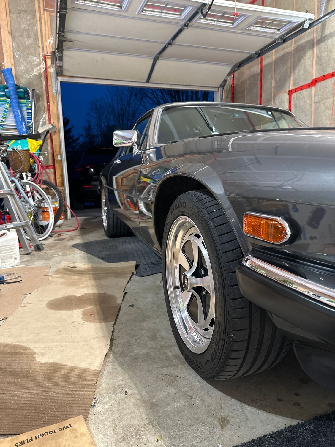

Go drive the car. See how far it comes down.
When you lower the car, the suspension kind of jams its self against the tires until you drive.
just lowered mine off the jack, look at that wheel gap lol. It wont sit like that once I drive it a few metres.

Just moved it back and forth a few times,

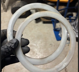

Did you use any of the nylon spacers at either end of the spring?
