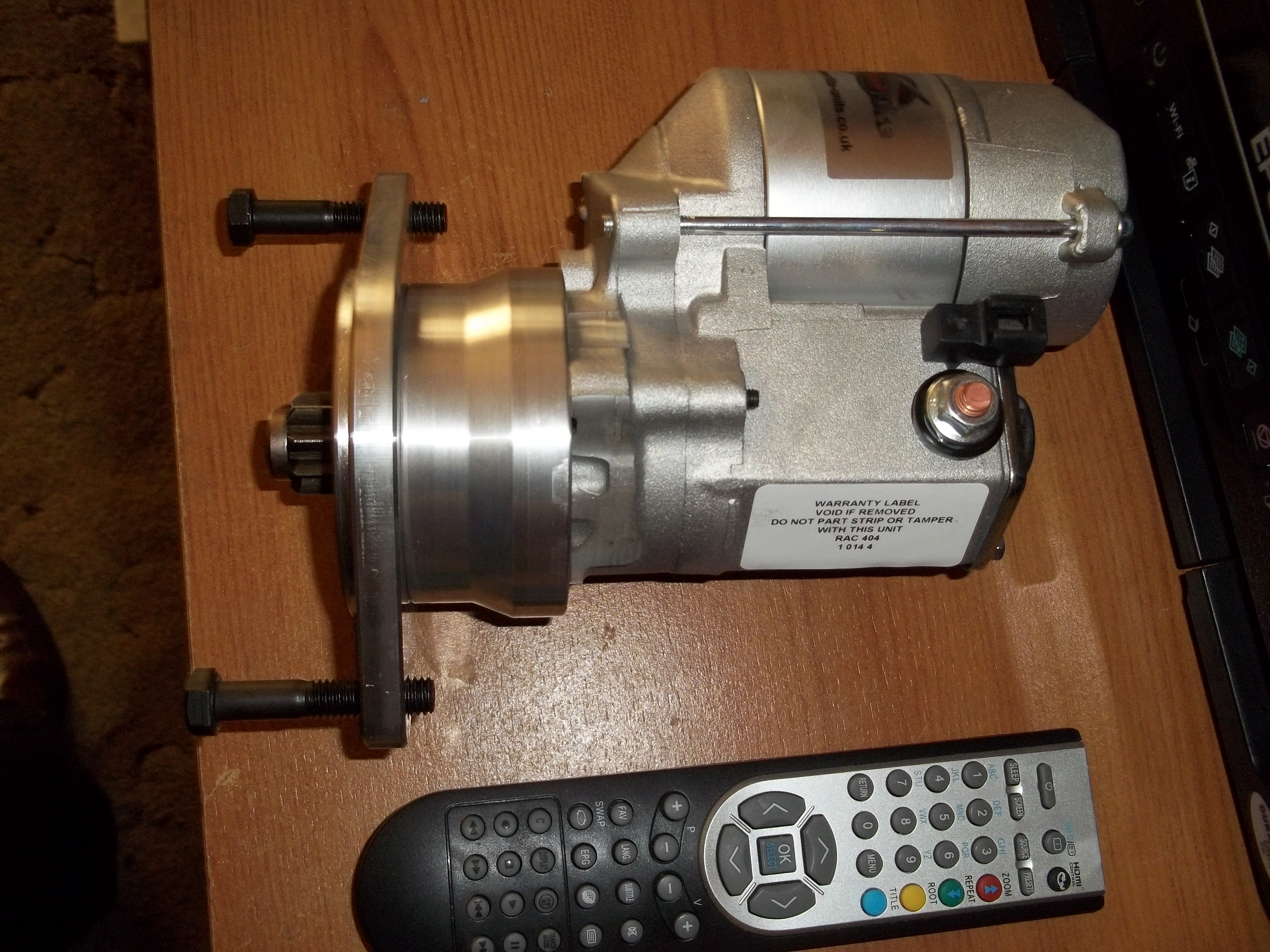

could be the starter solenoid not throwing in the pinion I had the same years ago and fitted a high torque starter motor to it, sound proper as well and weighs a lot less,
Rex
Which model did you buy, please, from which source?
Greg

Hi Greg
That Hi Torque Starter Motor looks like Model RAC404A from motorsport-tools.com
(UK) Company https://www.motorsport-tools.com/pow...ter-motor.html

I think it was this lot
https://www.autoelectricsupplies.co....5/category/242
or
https://www.autoelectricsupplies.co....3/category/242
they appear to have changed the look of them

Originally Posted by orangeblossom
Hi Greg
404 rings a bell but not 404a I think its all about pinion size
