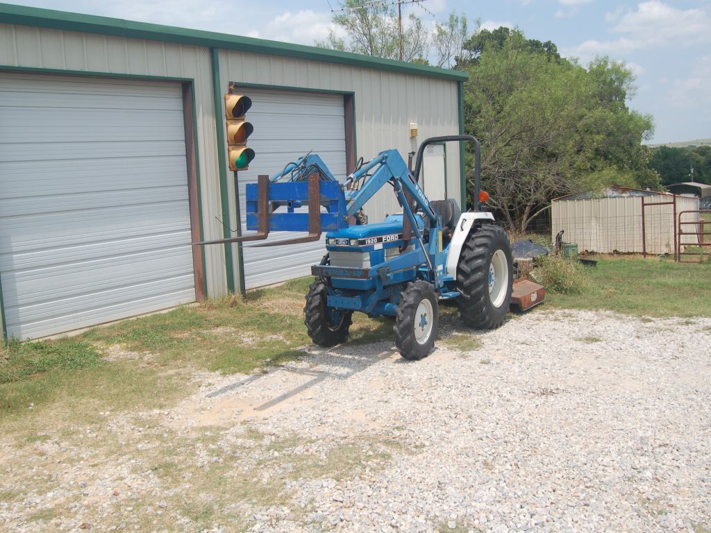

If a large truck shows up I can load the crate onto it.

Great tractor Bob! And again Tha KS for the offer, though I can't get shipping to be in a usable area. So I'll have to unfortunately pass on your transmission...
