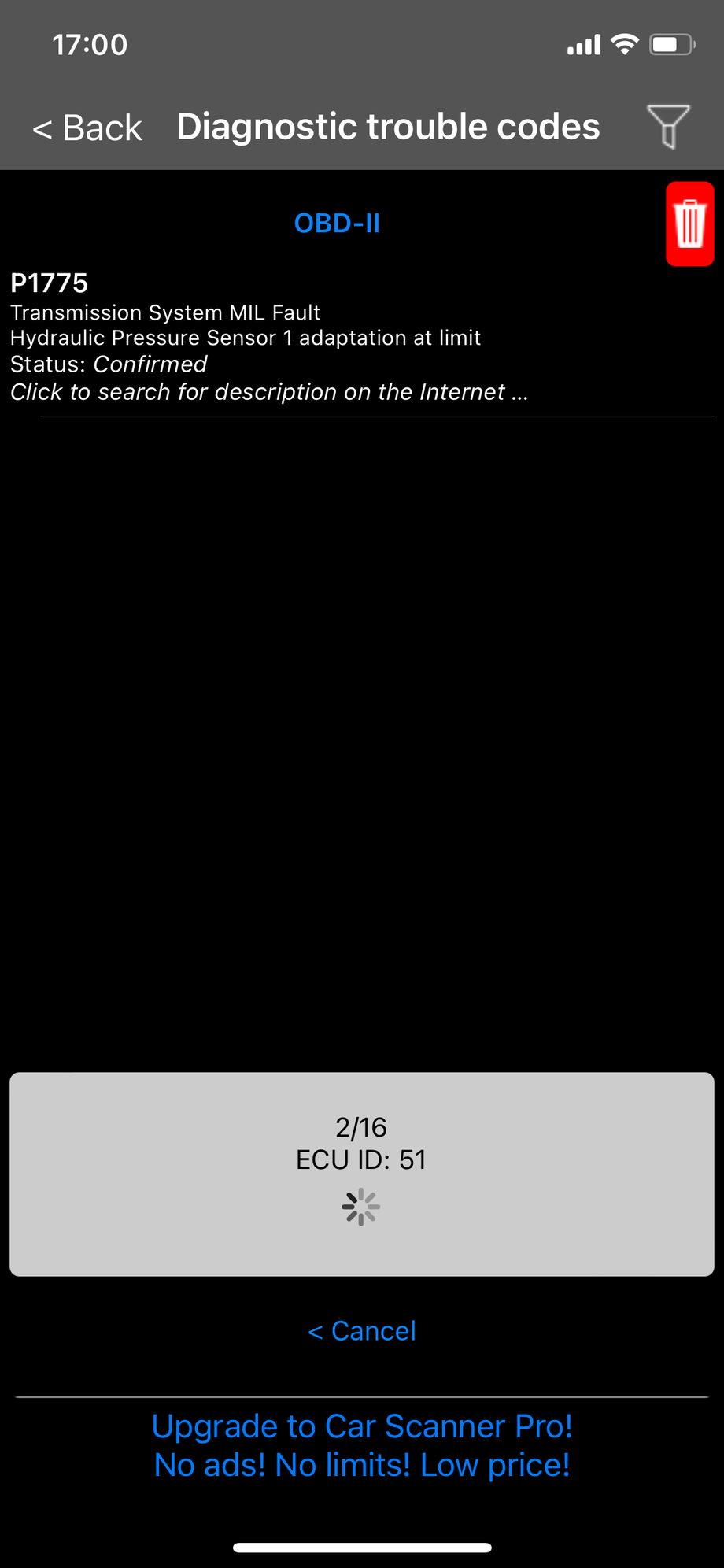

my OBD app says its P1775. I guess it has to do something with the fluid exiting the hose near the transmission. Any ideas? shortage of some kind? are the connectors behind the valve head connected to the transmission? I disconnected them to get to the hose, but are connected again now obviously.

I forgot to mention there is also a 'hydrolic pressure sensor 1 adaptation at limit' message in the app. No idea if and where such a sensor should be.

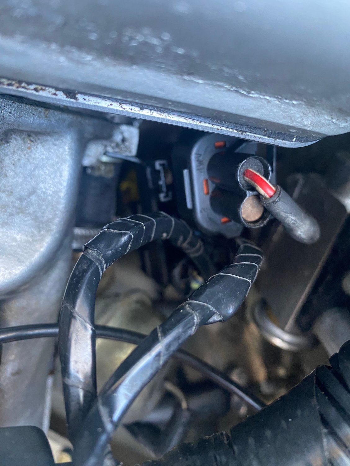

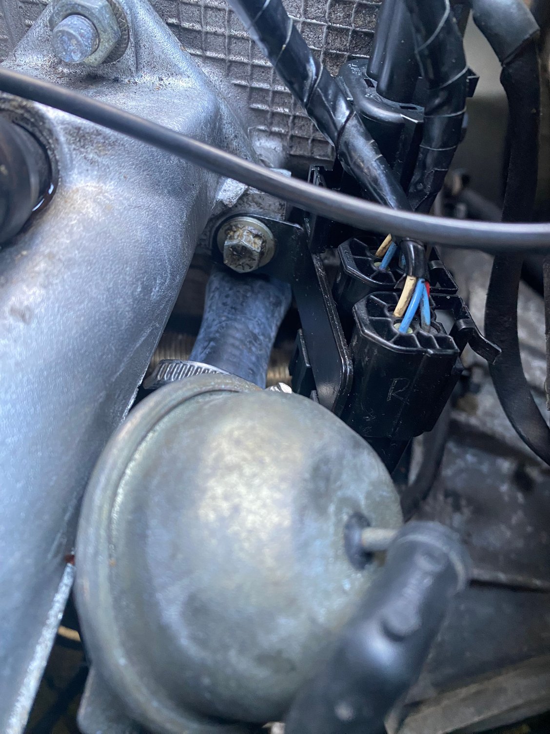

hi thanks; I can't seem to find this connection; where should this be? Left side when in front of car or in the car? I did clean some contacts next to the broken hose but I think these are for measuring exhaust gasses...
These connectors are next to the broken hose
I cleaned these connections; but are connected to exhaust pipe

The connections you cleaned are for the oxygen sensors.
I’m not sure what the other one you showed with one wire is, but most likely not important to this problem.
