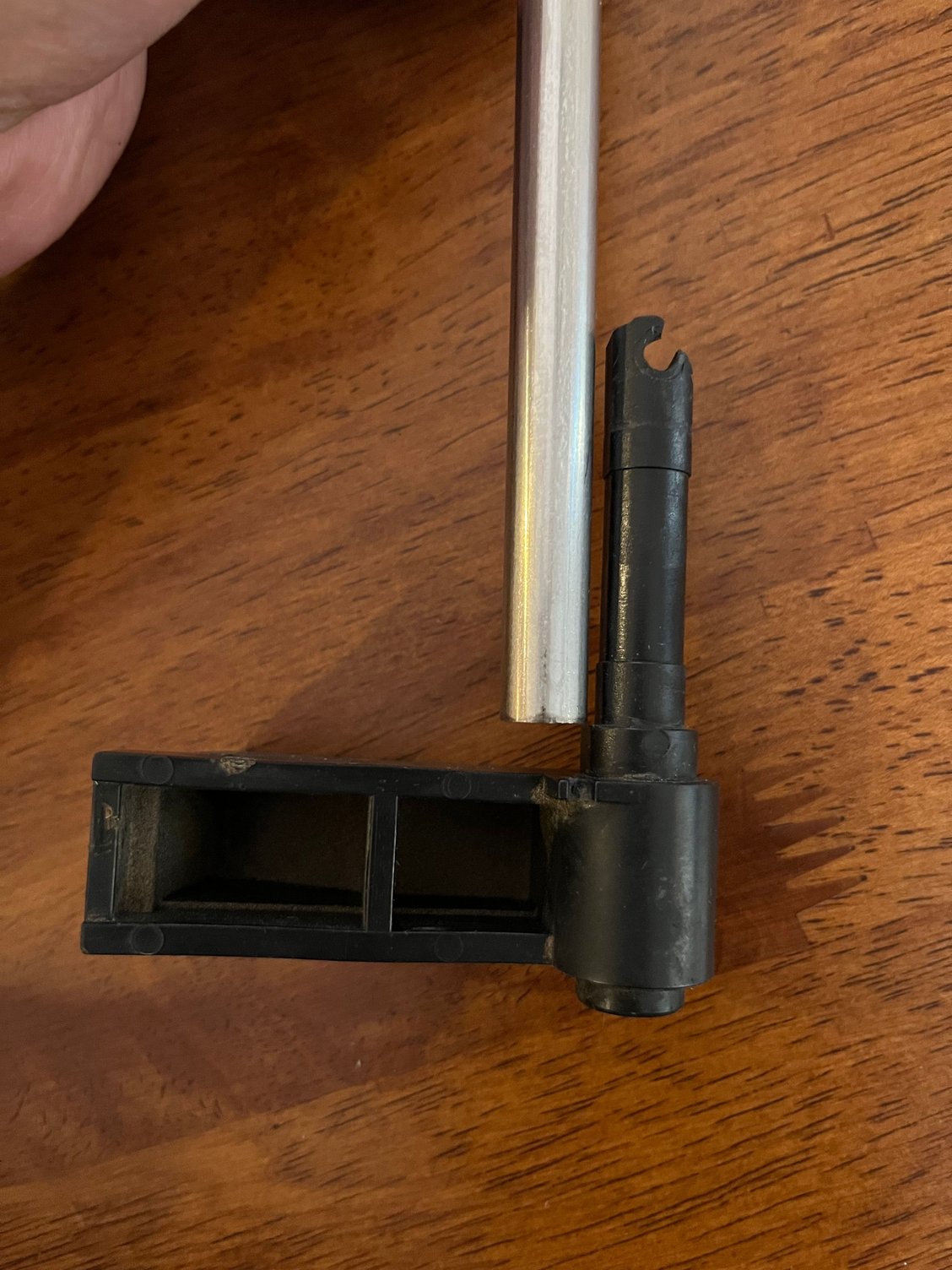

Some clarifying questions for you Vee, did you grind the original shaft to make it thinner? Also where can I find that metal sleeve tube at the hardware store? What is called/used for? And last, I’m missing the original set screw/pin thing that you mentioned in your post, do you think a safety pin or a screw would be a suitable replacement? Thanks a lot!

I found the steel tube at a hardware store that carries craft supplies too. You could certainly find it at any hobby store as well, or an art supply store.
I did grind down the shaft, but I can’t recall if o was able to re-use the broken one or if I came across a good used part.
I reused the original pin. It’s a split spring pin, like this:
uxcell M6x45mm Stainless Steel Split Spring Roll Dowel Pins Fasteners 10Pcs https://www.amazon.com/dp/B019ET21PY/ref=cm_sw_r_cp_api_i_RZ40HZVQ2WQMGAYMQBPP?_encodin g=UTF8&psc=1
Not sure what the size was, but the hole I sized is made for what came with the original part.
It hasn’t given me any trouble since.

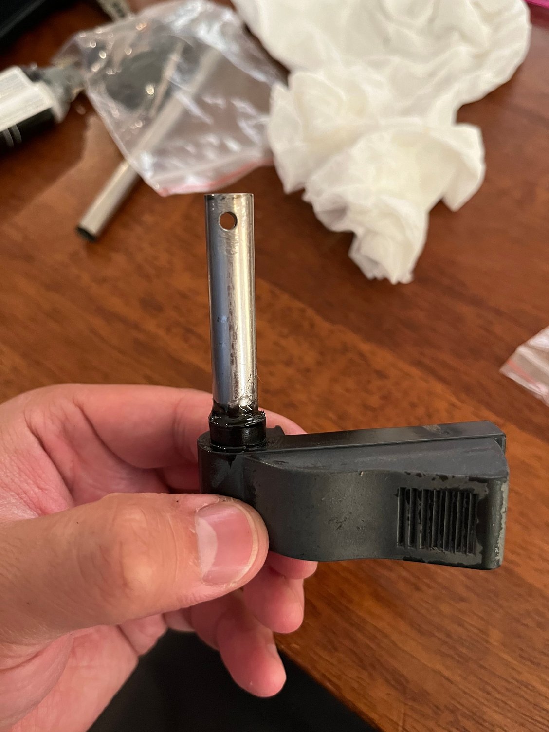

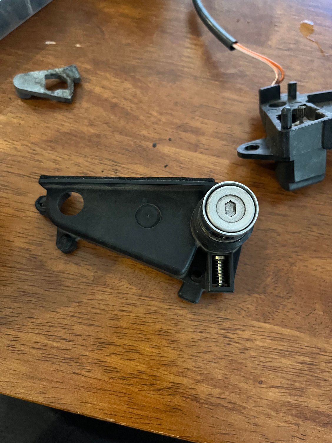

The fix seemed easy enough but after taking a look at the boot today i didn’t see any obvious way to take the trunk release handle out of the car.
Two bolts were already removed that secured the handle but the handle didn’t budge at all. Will have to do some more research
Old May 17, 2022 | 07:04 AM
Vee's Avatar
Vee
Posts: 5,352
Likes: 1,749
From: Arlington, VA
With the bolts off you have to kind of push the handle and the lock cylinder in. Tough to explain, but I think you start by pushing the plastic release latch up into the trunk. Then the key cylinder will be holding it somewhat in place and you have to push that in to get it to go. You'll figure it out.
Lastly you'll have to disconnect the handle assembly from the latching mechanism. There's a rod or something hooked into the steel stick with holes in it....again, should make sense looking at it.
By the way, now that I thought about it, I did use the broken handle for my fix! It had sheared across the hole at the top of the plastic shaft, so there was plenty to work with.

https://www.jaguarforums.com/forum/x...sembly-174996/
Maybe these pics help?
Old May 17, 2022 | 10:33 AM
stran0020's Avatar
Joined: Apr 2009
Posts: 467
Likes: 69
From: Arizona
Those pictures help a lot. The previous owner had already taken pieces off so I didn’t have a reference on how it went together. Now I do! Will try to attempt in a week or two.

That's why using the old piece is useful. Pre-drill the hole in the steel tube and make sure you align it with where the hole was. I've given you the drill bit size and how far from the end to drill it, all you have to do is make sure the tube is oriented at the right degree to line up with the where the pin is supposed to be. Remember when you glue that thing in, you'll have plenty of time to rotate the steel tube to get it to the right place. Just make sure you can keep it in that position and give it 24 hours to cure.
The $200 part on eBay will break on you again, so this really is the only way to go.
Since you lost the spring pin, you should drill that hole in advance and go the hardware store any find the one sized for the hole. It should extend a little on both side, and it should take a little bit of effort to slide it in, it certainly shouldn't be able to slide out on its own, but don't force it too much. The spring pin I posted above was an example. I don't know the needed size. I'd guess M2.5x10mm - I might order this if you don't have a hardware store that will sell you one.

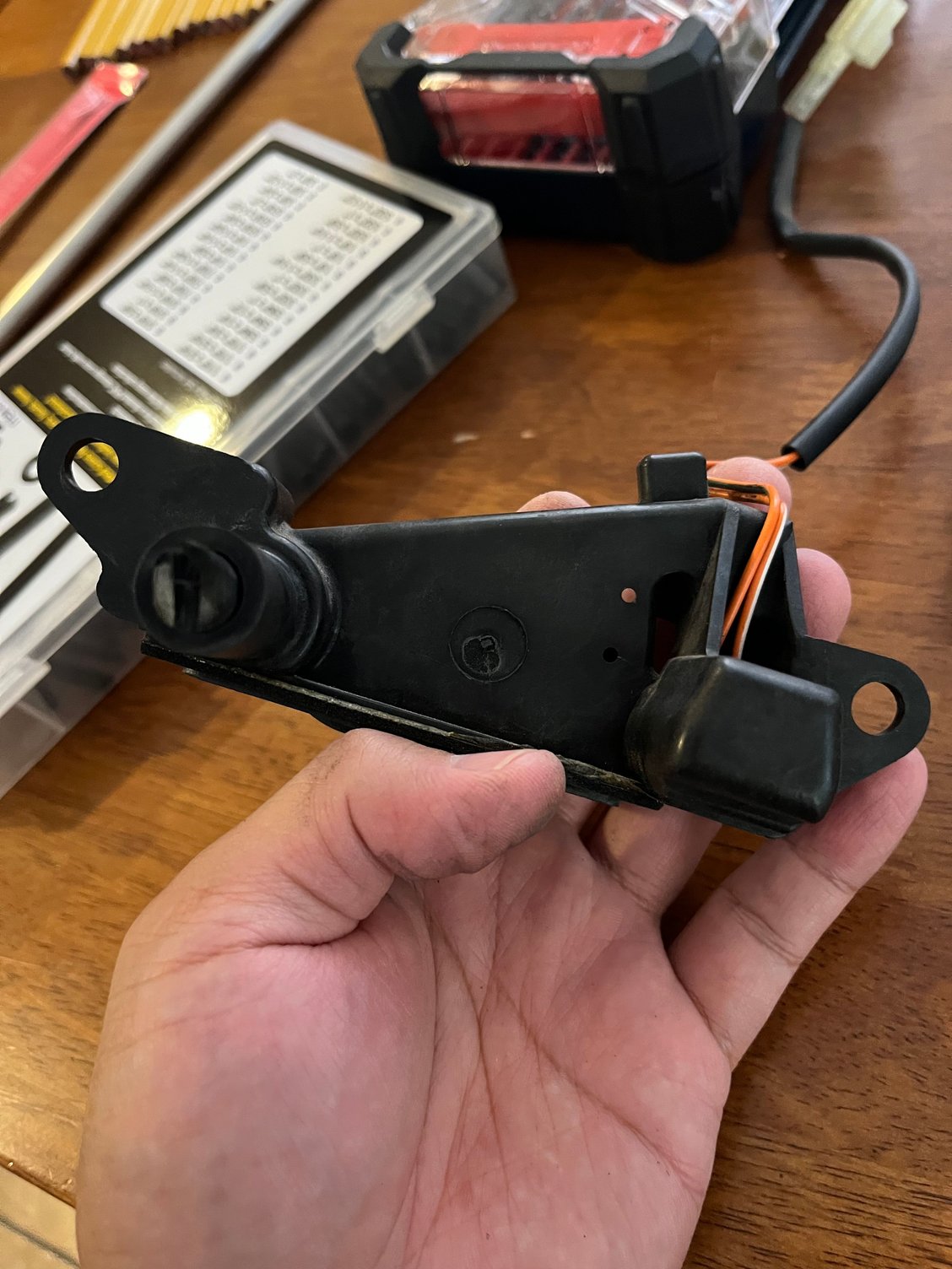

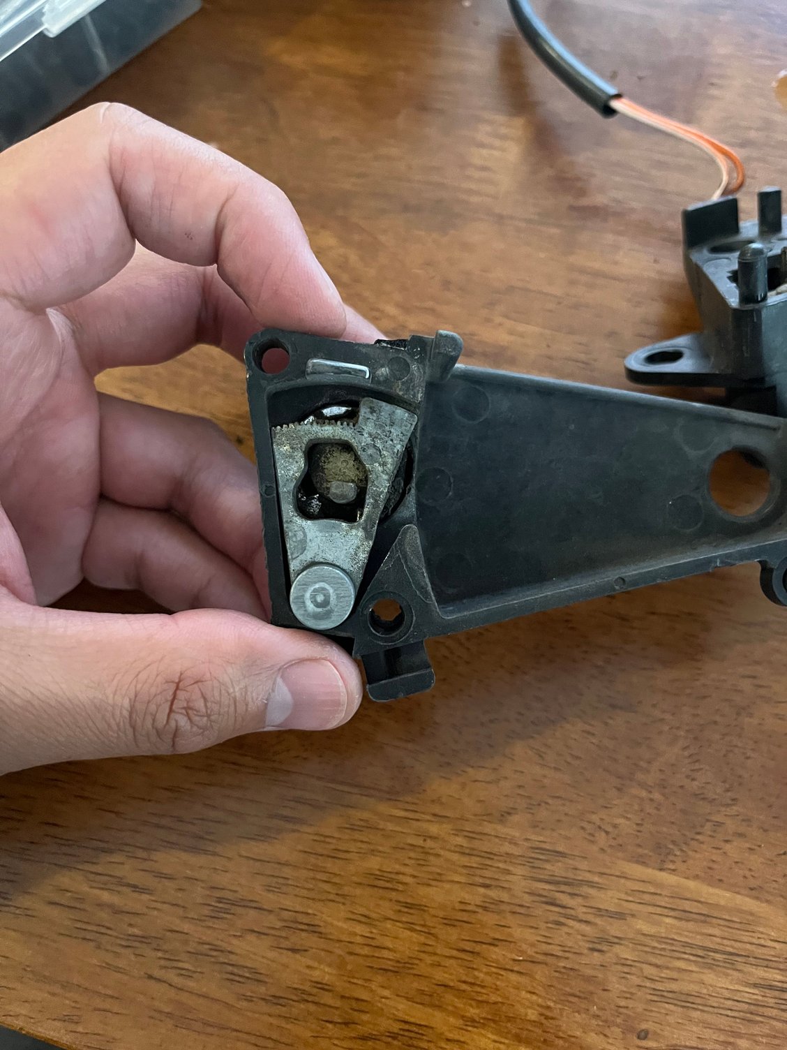

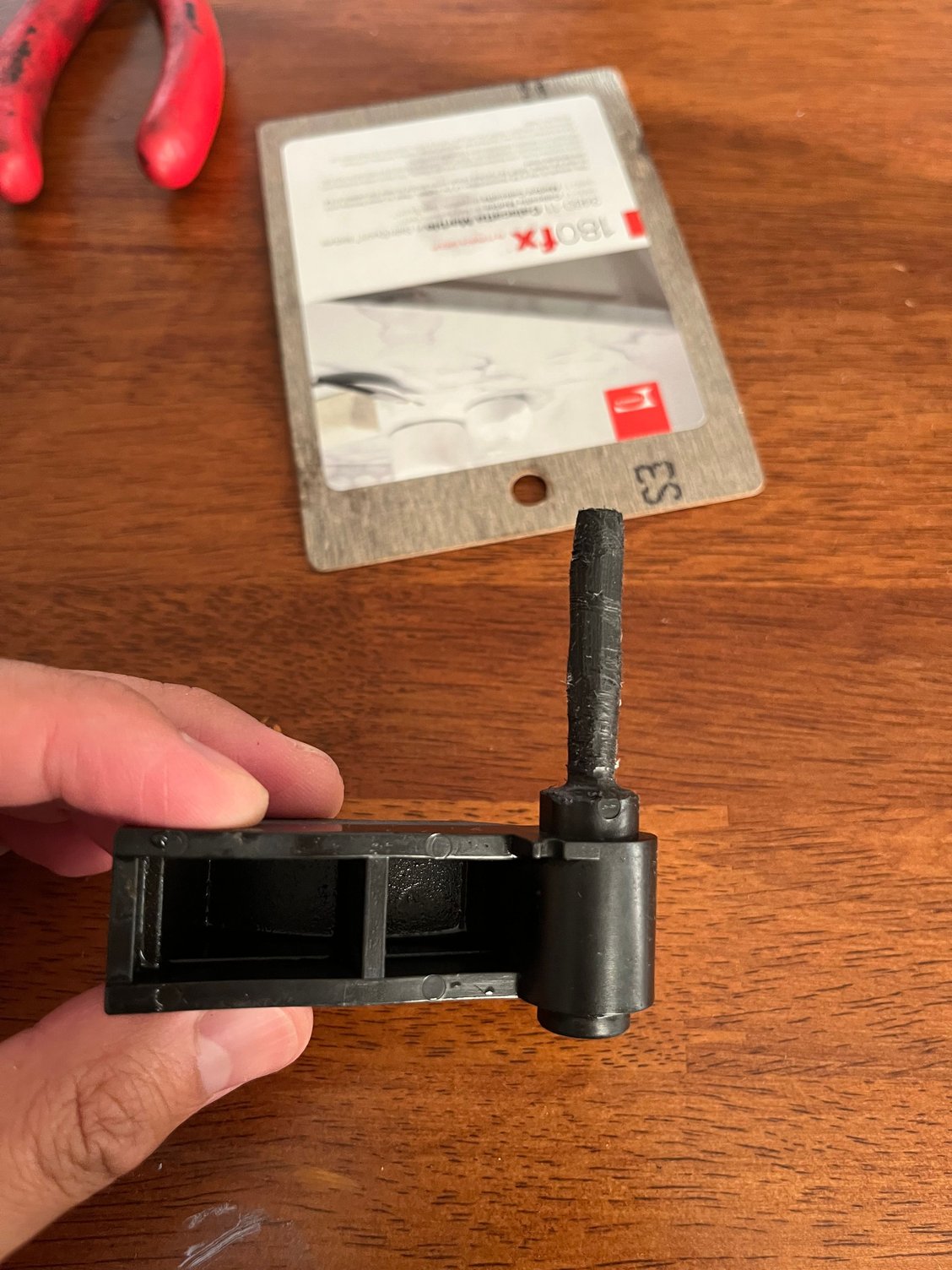

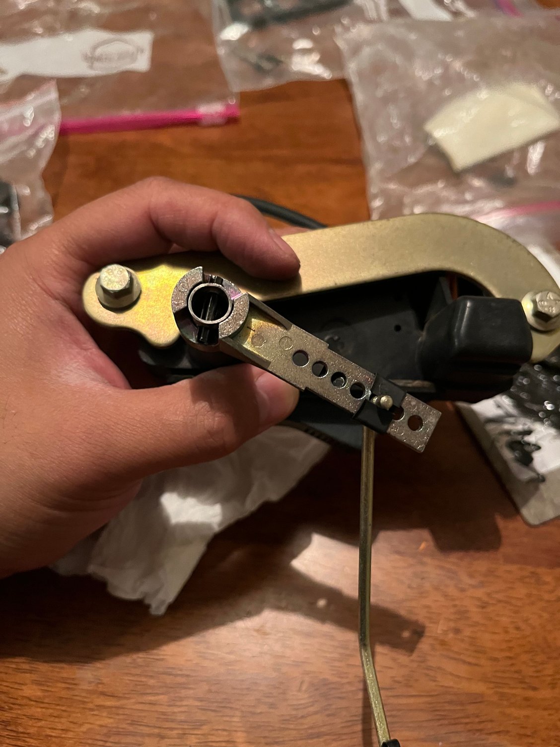

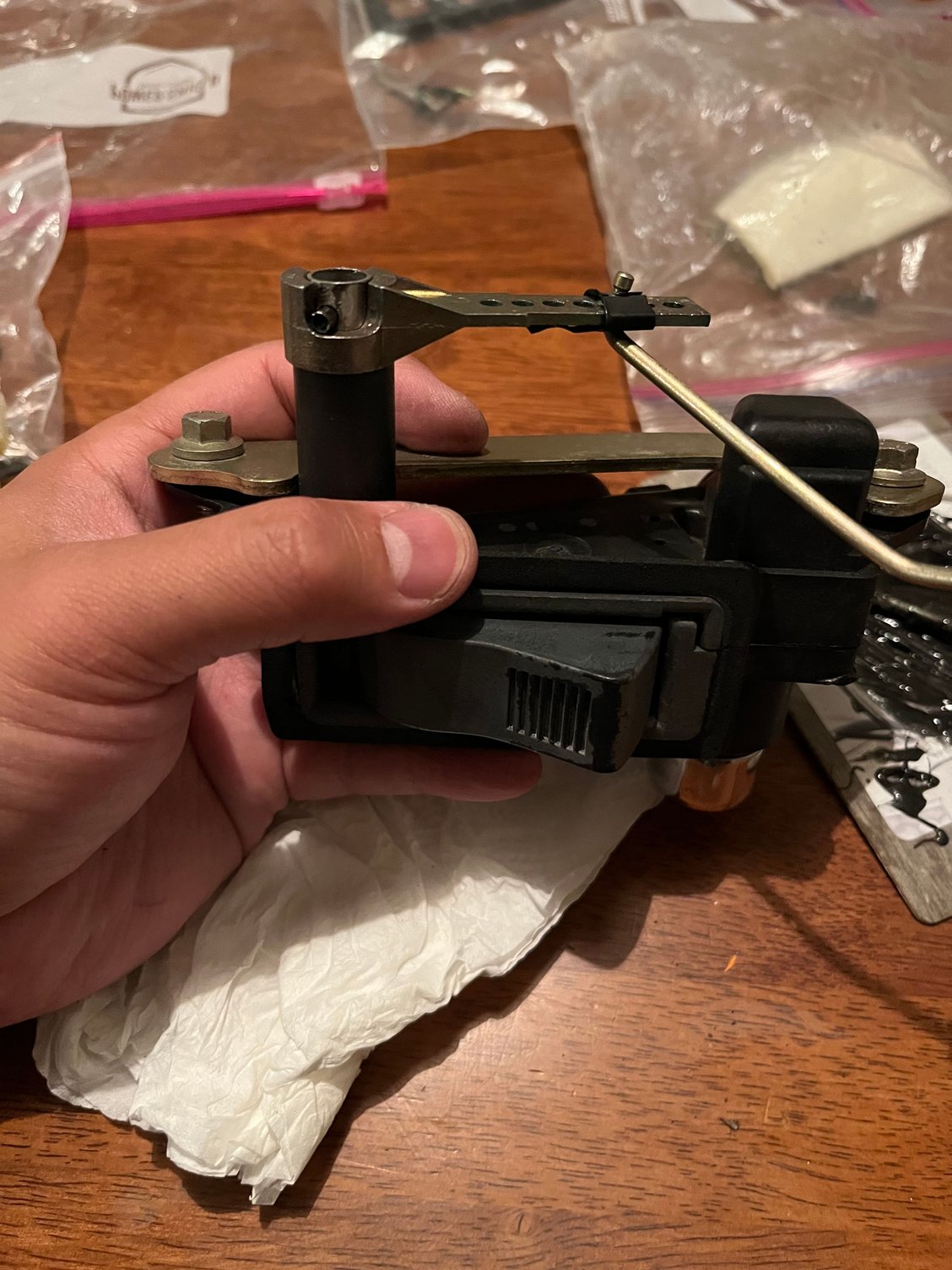

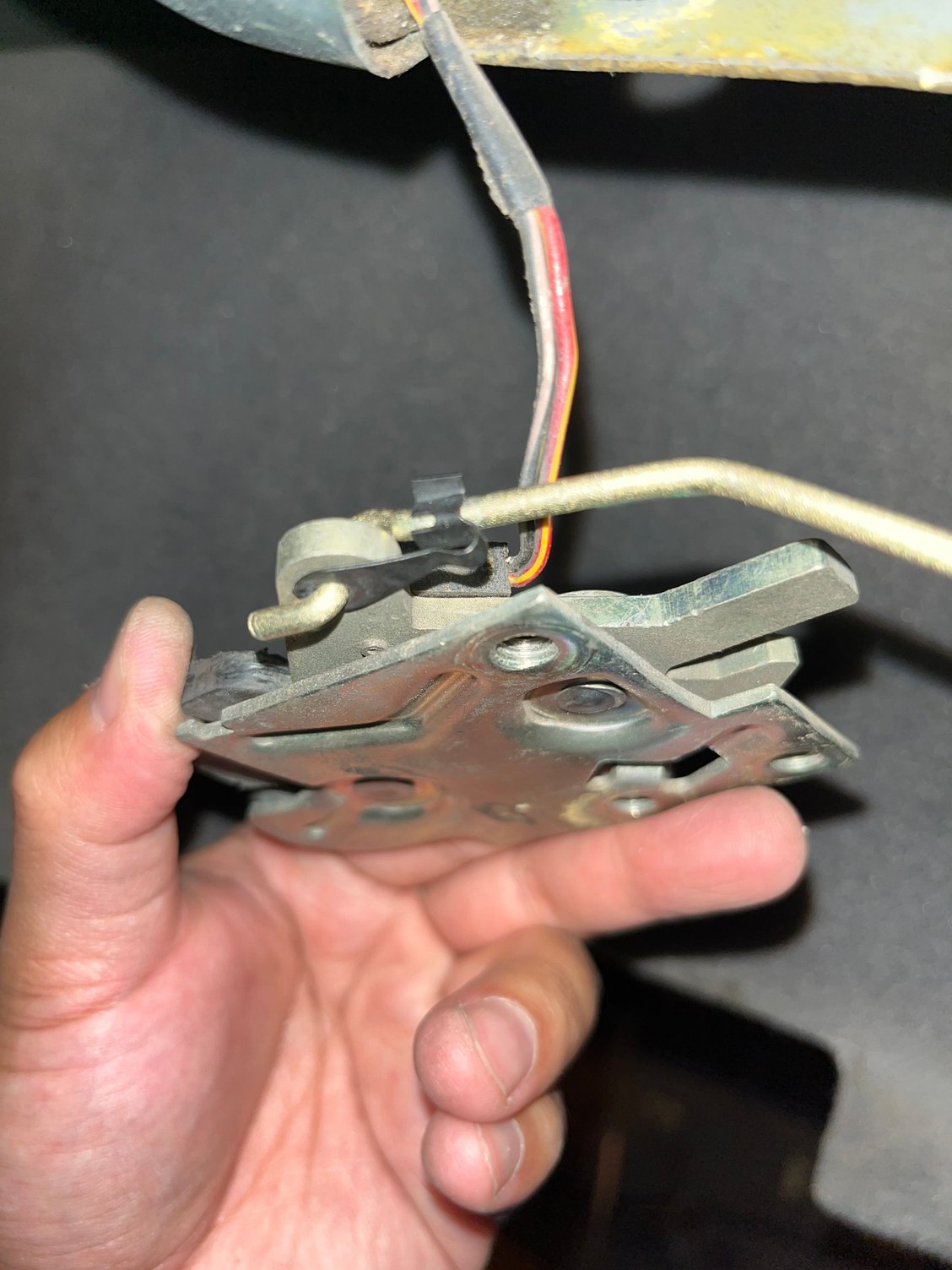

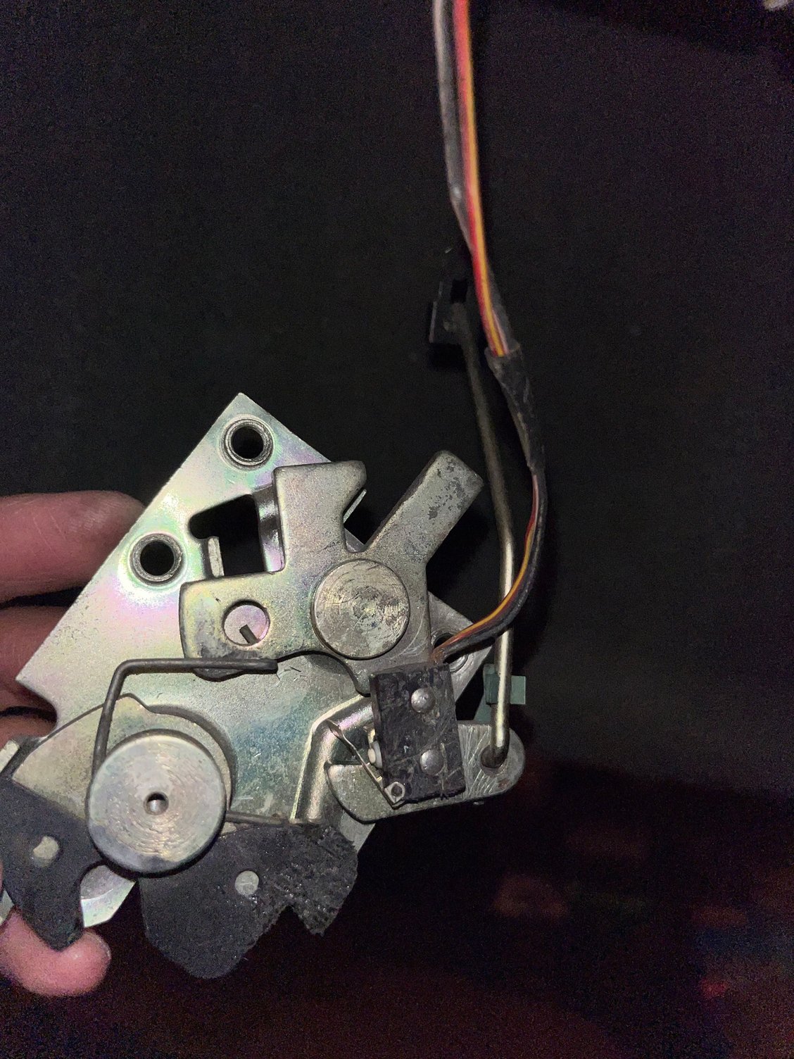

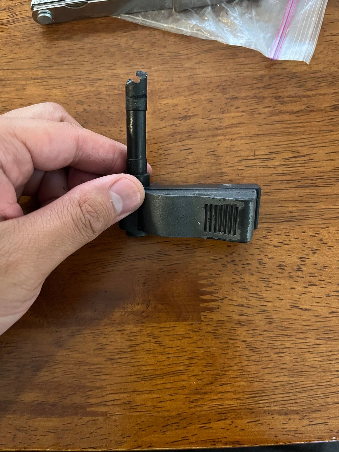

Okay thanks too Vee’s documentation I have almost fixed my trunk button. I just can’t figure out where to connect the connecting rod!? Can someone help me figure out where the rod goes too? Maybe I’m missing something.
here are some pictures of the fix thanks to Vee

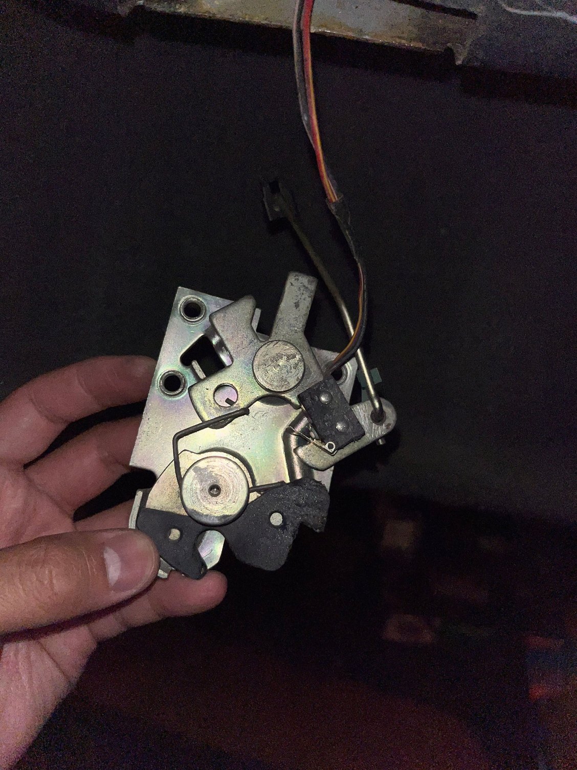

It’s this rod that you see in this picture that I can’t figure where it connects to! The one that’s almost point straight up and down

Okay figured it out, you have to unscrew the three bolts on the trunk latch and have the rod connect to that and then you connect the other end to the lever.
Old Jun 8, 2022 | 07:55 AM
