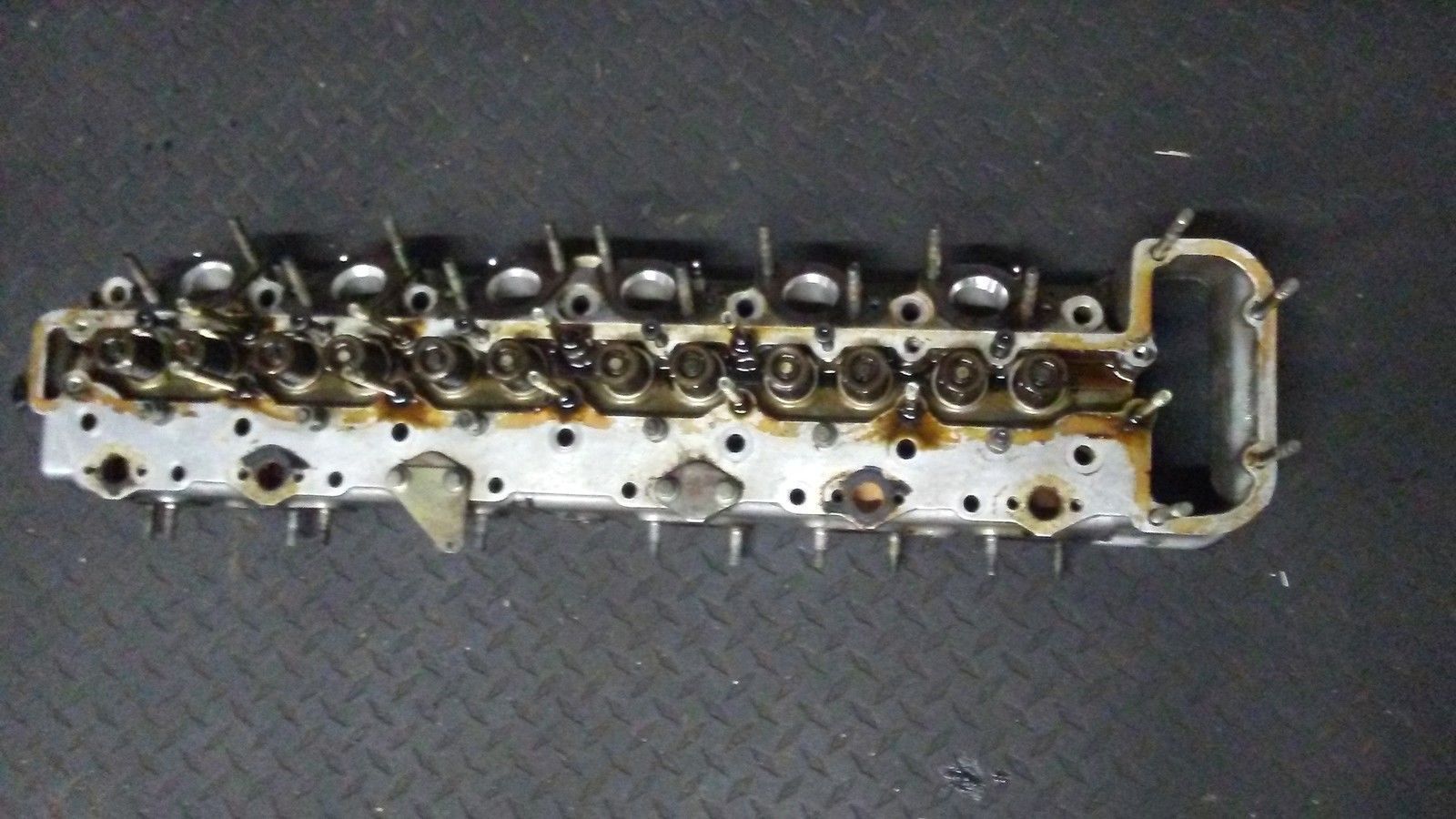

Ok... Even before people started replying - I went ahead - and below is what I got. For some reason I couldn't help myself (BUG - Greg)...
I quickly looked around for anything I could find in a quick search. Every comparable cost much much more! I see myself taking my time in setting new valves and (I don't know the correct term) compounding valve seats, new valves seals, springs, tappets(?) and then - eventually - setting them in - then what ever else the job takes. I'll learn.... Soon, later, I want to pull the intakes and the cam covers, give everything a good sand blast and powder coat and really spruce up the engine and engine bay... YES, I've caught the bug.

FIRST DUMB QUESTION...
Why are the bolts extending so far and high over the TOP of the cylinder head (CH) on the valve cover side? Do those bolts extend down and thru the body of the CH into the block? Clearly, I have a lot to learn here.
(edit) - no laughing - I now see that the the cam shaft housing and the cylinder head are two VERY distinct and separate components...
I may be slow on the uptake (at times),,, but slow ain't the worst thing in the worl... Is it? lol
Old Jun 29, 2018 | 09:02 AM
Greg in France's Avatar
Posts: 14,583
Likes: 10,777
From: France
JJJ
What you have NOT got here is the casting that goes on top of the head that carries the camshaft. This bit is called the tappet block, and the long studs secure it to the head. I would cancel, or ask for the tappet blocks and cams at the very least. I hope they were dirt cheap, because what you really have here is two castings that will need new valves and springs if you ever think of rebuilding and fitting them. Meanwhile, the heads on your car will be every bit as good as these, or better!

I SEE said the blind man. Writing them now for the tappet block and,,,,

Hey All.... Yeah, the heads are on there way, GiF. I tried to catch the seller after input, realizing the tappet block realities and rethinking - but they were already on the road. Yup, it was a lot of money I dont have right now. Perhaps I could resell, perhaps I could take a breath and see what I have, and eventually be very happy with what I've got. Now,,, I'm on the fence "happy-wise" but with the feeling happiness will come!?
I saw new tappet blocks here >>>>> could THAT price (with shaft caps) be right? If so,,, I will order from them. https://www.jaguarclassicparts.com/uk/part/JLM11897
I think down the line as I stash away a few more pennies, slowly gather the bits I need to make for 2 complete heads with tappet blocks, shafts, valves, buckets, shims, half moons and ALL ---- well, all of that might make me a very happy man. And then, down the line, winter maybe, I can take off the old and replace with the new. Not today, but for some reason I can see that being a very gratifying experience.
Yes that is the price, BUT they only have one side, the two sides are not identical. if you do rebuild your motor - which it does not need by the way - you can reuse your tappet blocks no problem. But of course you cannot build up a complete unit beforehand; but you can fit all the valvegear without the tappet blocks, and get the second hand heads al cleaned up and nice. Check then for straightness on BOTH faces, top and bottom, before spending anything on redoing them though.
