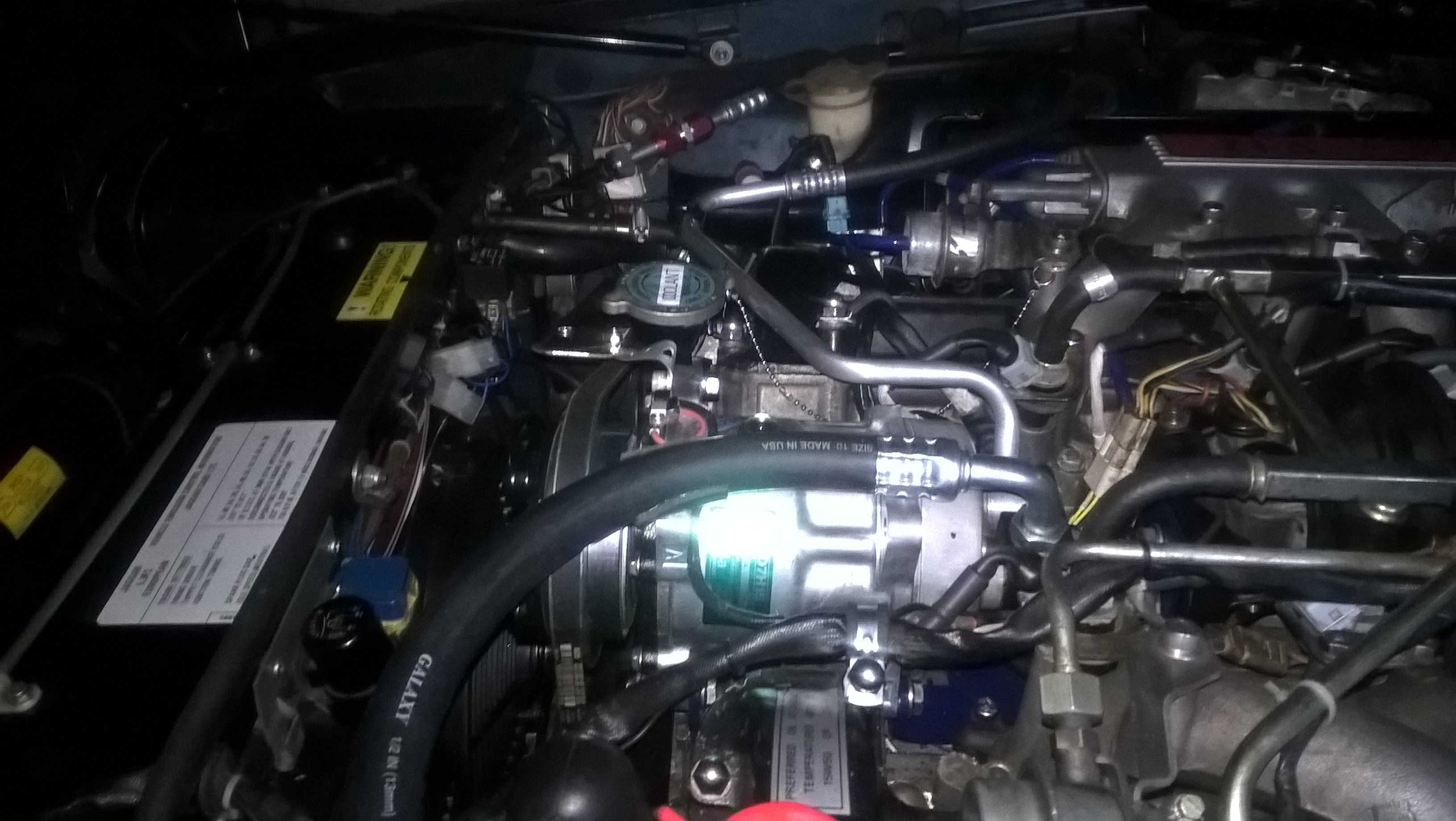

the Sanden air con is super, only drops 150 rpm when ticking over, 149 motorway miles and 21.7 av. but when I toe it at fifty in top I get a clunk from the a/c vac tank and the aircon goes off for the couple of second that my foots down, is this a problem with the one way valve would you think, the equivalent of a vacuum diode?
I would say that the one-way check valve is a likely culprit, yes

Thanks all. I will worry about the tickover drop when it suits to throw more money unnecessarily at it but I will say I wouldn't have known how much better the sanden was
(150 rpm less strain on the bottom pully etc) if the air valve was working correctly, and the fact it isn't working correctly must be economical.but thanks for pointing that out Paul.
DD I will source a new vac control. Asap

Very glad the Sanden worked out well. Mine was a huge improvement over the old OEM job. As for the one way valve, are you and Doug referring to the one-way valve that sits in the vac line between the manifold and the vac reservoir, and which is tucked up against the bulkhead in the engine bay?
If so, it is easily changed.

RGP
Greg
yes Greg
its behind the washer bottle on the rhd car when I blow through it I can actually make it do a raspberry sound on the direction it should be sealed, if you know what I mean,
