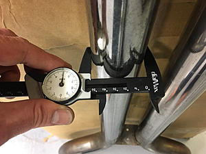

So yours is 2-17/100"? You're missing .08" somewhere if you have 2-1/4". I think you have 55mm. It sure is pretty though. Mine's all gold colored.

That measurement was taken on the factory 5.0L XKR-S center pipe I have here, it's all 55mm OD, as is the 4.2L XKR and the 5.0L XK, until you get to the pipes coming out of the rear muffler to the tips, these are larger, and larger again on the XKR-S.
