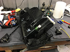

This is a RHD glovebox, removed from the car, LHD will be a mirror image.
The damper is the white tube on the back, there's a string which goes around and attaches to a clip, which always breaks. On this car I just hooked the string onto another spot, it's a bit too strong but works ok.
Both the upper mounting screw locations on this one were broken by someone previously.
There are five T30 torx screws holding the glovebox in, two at the bottom, two at the top (access from inside the glovebox) and one on the side, behind the plastic end cap of the dashboard which nests into the cutout of the door card.

Originally Posted by winstonsalemncxk
My XK either doesn't have a glove box damper or the damper is broken. Can you chime in on this? Do you have a damper on your glove box? Mine's an '07 (US model year).
Your damper is broken, or as Cambo says, the string coming out of the damper is no longer connected to anything.
Had the same problem on mine when I bought it. The wife said 'how come the door just drops down?'. Did research on this forum and found workable solutions.
Took out the box and repaired it (hardest part, for me, was getting the box reinstalled). Works great now.

Yea , the white tube on the back is the damper and if the hoop is good just drill 2mm hole and use a cotter pin .jaguar has a service bullitin on this .
