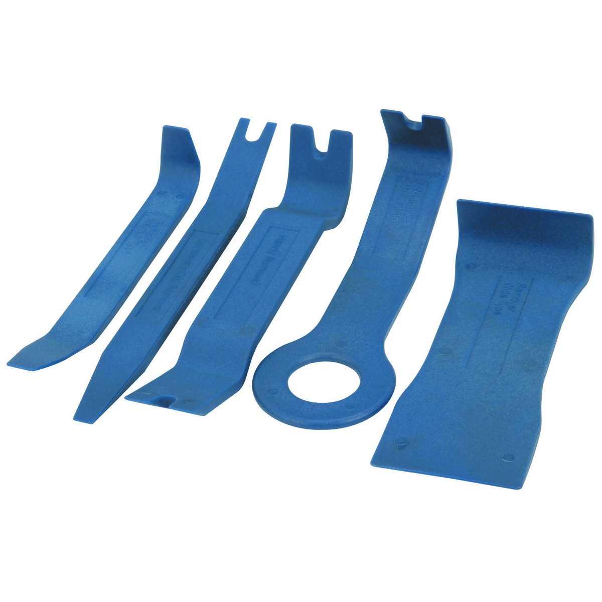

A nylon trim removal tool would come in handy. Very carefully pull up on the wood trim, the clips are underneath and come up with the trim. The shifter surround is also attached and will come up with it.

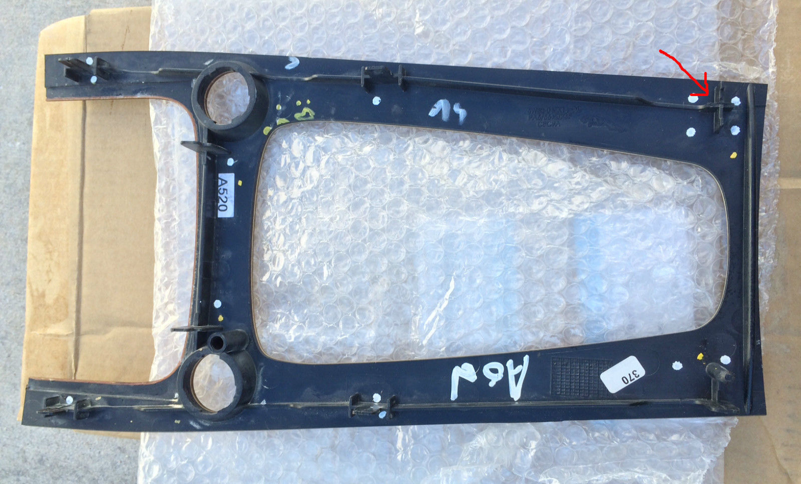

Yeah, Jag manual just says "Carefully release the 8 clips." So helpful.
If it's any help, this shows the location of the clips:

No, it is very easy to do. I did it myself, that is why I responded to this thread in the first place. As I said in the first response on this thread, post #2 you just pull straight up. I did it to my XKR when I changed the wood to engine turn. Here is a pic of mine on eBay.
It does not get any easier.

No, you have to pull the the trim panel straight up, no sliding. Using my picture above as a guide it will be easiest to exert pressure at each clip point and pull/push up. I started at the ashtray end under the control panel and worked my way back. As I mentioned before it would help a lot to have nylon trim removal tools to get underneath the panel and not damage anything. Jaguar is known for overkill on the quantity of clips they use and this part is no exception, 8 of them for a tiny part.
Old Mar 28, 2014 | 06:27 PM

Like this:
http://www.harborfreight.com/4-Piece...Kit-69668.html
5 Piece Auto Trim and Molding Tool Set

Gotcha - thank you ...! I've got those very tools - except they were $4.49 when I bought them ...!

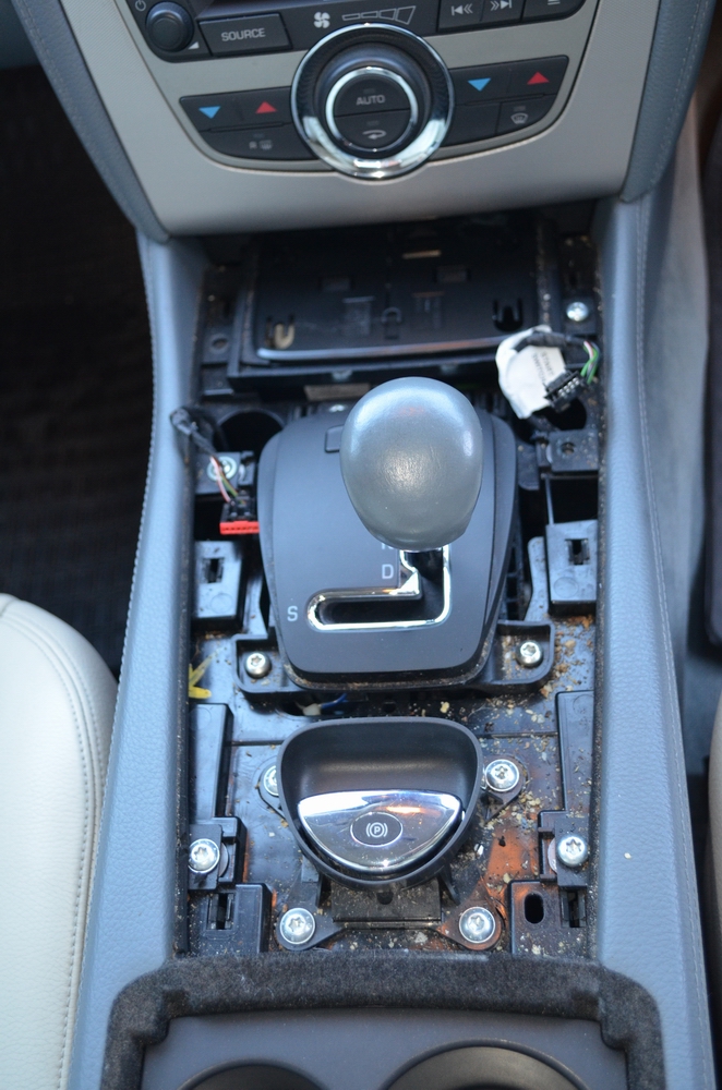

Old Apr 8, 2014 | 05:29 AM
Originally Posted by LA_Bob
S-U-C-C-E-S-S ...!!!
It took me just under an hour, from starting the car and backing it out of the garage, to shutting it off after pulling it back in. The project was a bit tougher than expected, but easier than I was afraid it might be .....
...... I'm sorry I didn't take pictures as I did this, but it's pretty straight forward ...
Thanks Bob - added to 'HOW TO' quick links:
https://www.jaguarforums.com/forum/x...k-links-20091/
I did take photos as I switched my veneer set so this one helps to illustrate your procedure:
Taken before I cleaned out the PO's crumbs!
