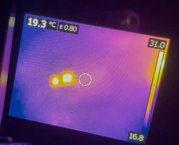

A little update for today. The battery was left on a recondition charge over night and was 13.56v when tested this morning. I tried the roof again with the diagnostic tool plugged in and I can see that the sensors are responding correctly for the luggage sensor, window open status, the roof latch status, and I can see the roof control module commands the bow in and bow out solenoids to trigger, but the roof refuses to move after the initial unlatch. With the engine running the lowest voltage shown on the diagnostic tool was 13.6, however reading the voltage at the battery shows it to be 14.1 – 14.3v.
I left a thermal camera in the boot / trunk to record the pump. When I first press the button to open the roof you can hear the pump kicks on for a few seconds, then two of the solenoid valves (forward most, then the one closest to the inside of the car) quickly get hot.
Is it likely that one of these solenoids has failed, maybe the one responsible for the initial lifting the front of the roof?
