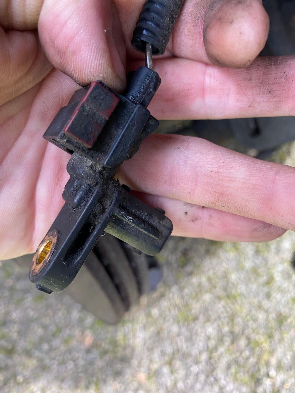

After a few month without driving my XK, I decided to replace the wheel sensor so ordered the part.
Took the rear wheel off and the sensor is just there right behind the brake disc so easy enough too unscrew.
My problem however is that somehow I can't unplug the existing sensor from its plastic connection! 😬
I am not sure if there is a clip or something that needs to be lifted in the connection casing and I don't want to risk ripping it apart as the connection casing is attached to 2 fine leads that seem easily broken.
see picture here:
Does anyone know if on the XK150 (I believe they were slightly different on X100 with a metal clip above) it is just a case of puling it or is there is a some sort of clip to be lifted to disconnect it?

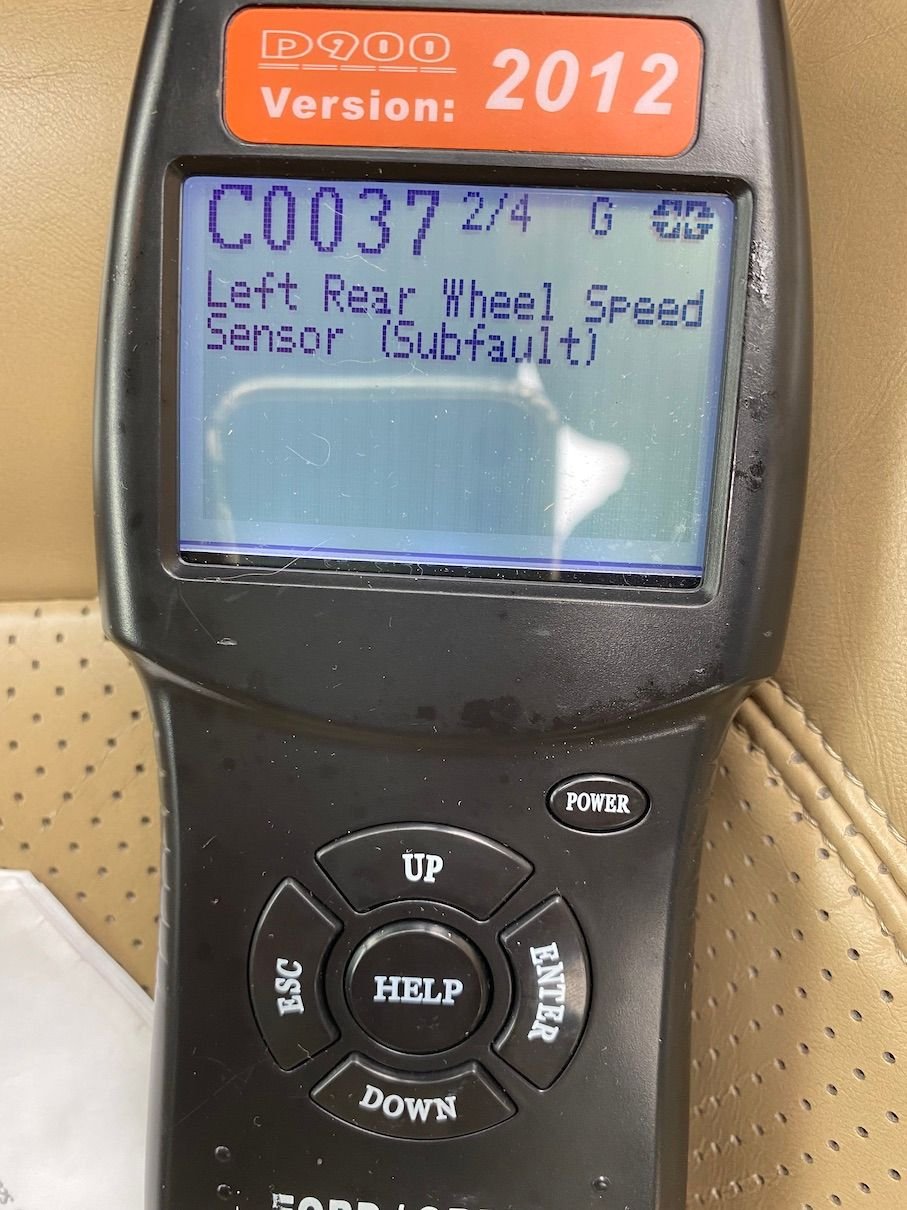

Here's the code I was seeing before I erased it:
If the battery says actually 10.2V then that is totally shot. It sound as if one cell has gone down and the car will never operate properly at that voltage.
