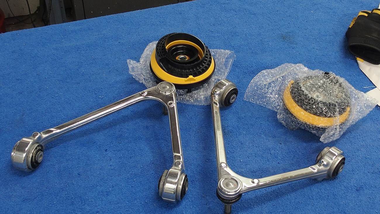

Getting things together for a little front suspension work, I was curious what a quick pass on the buffing wheel would do to the upper control arms I’ll be using.
(thanks again Mike for the donation)
Shiny!
wj

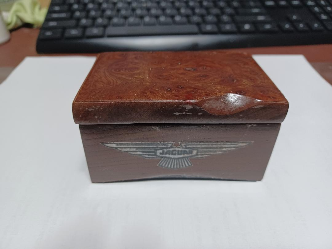

I completely understand the urge to do something to the Jag just because you can. Last week I put a matching burl overlay on my 2007 Jaguar cupholders. Being retired does leave time on our hands.

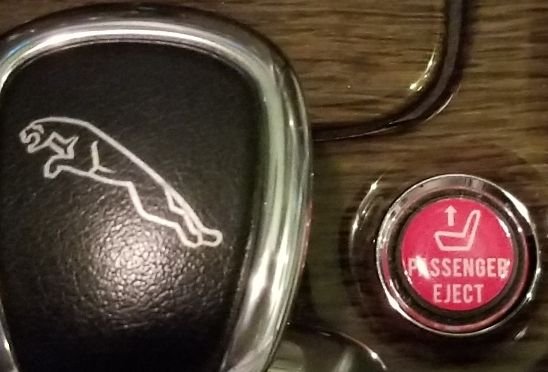

I like the button. Here is my burl ashtray that I put in front of the shift knob ( regular ashtray is covered with a little shelf).

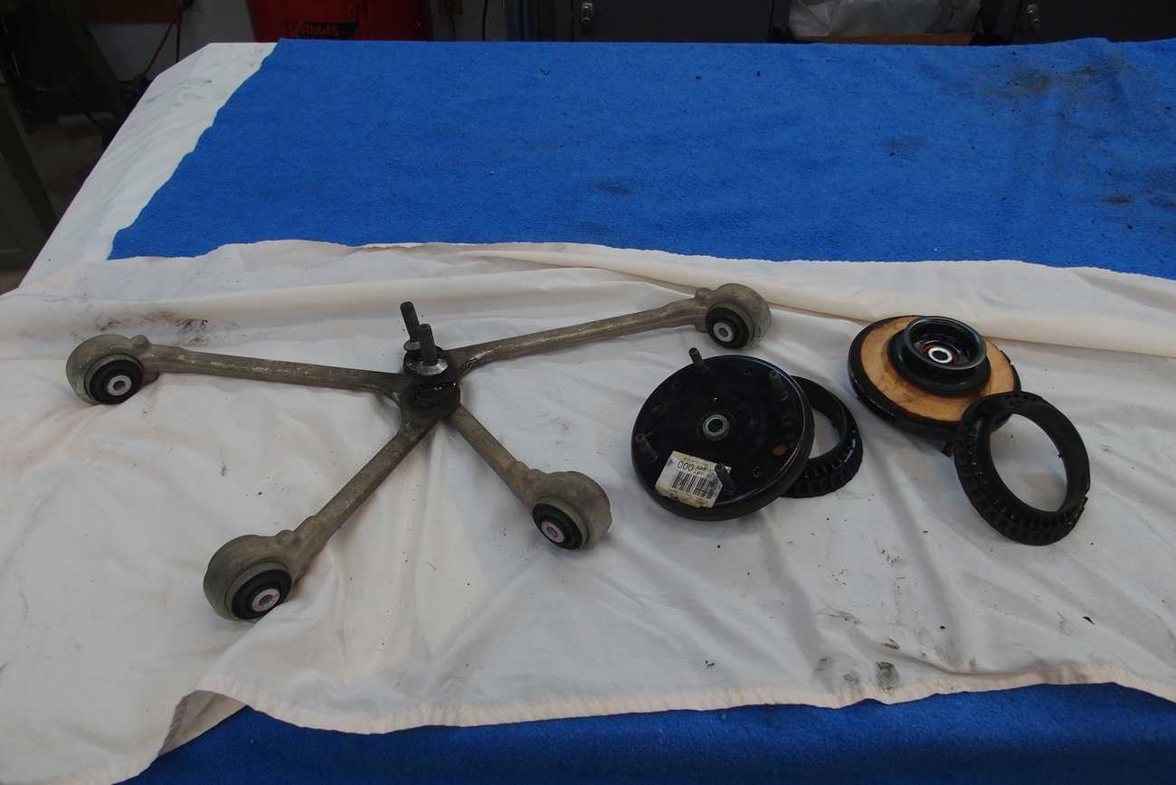

Bored no more!

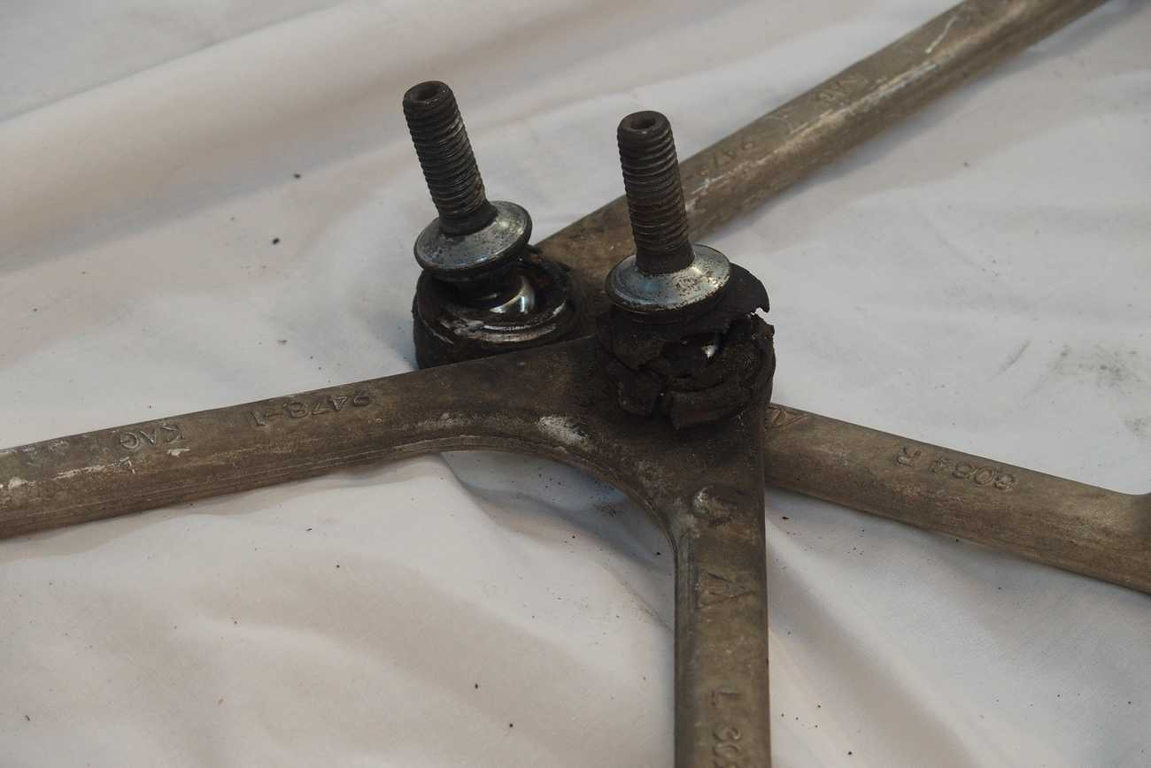

Looks aren’t everything when it comes to evaluating some components. I wanted to replace my original upper control arms due to 125K miles of usage and the fact that the ball joints had been exposed to the elements for many years.

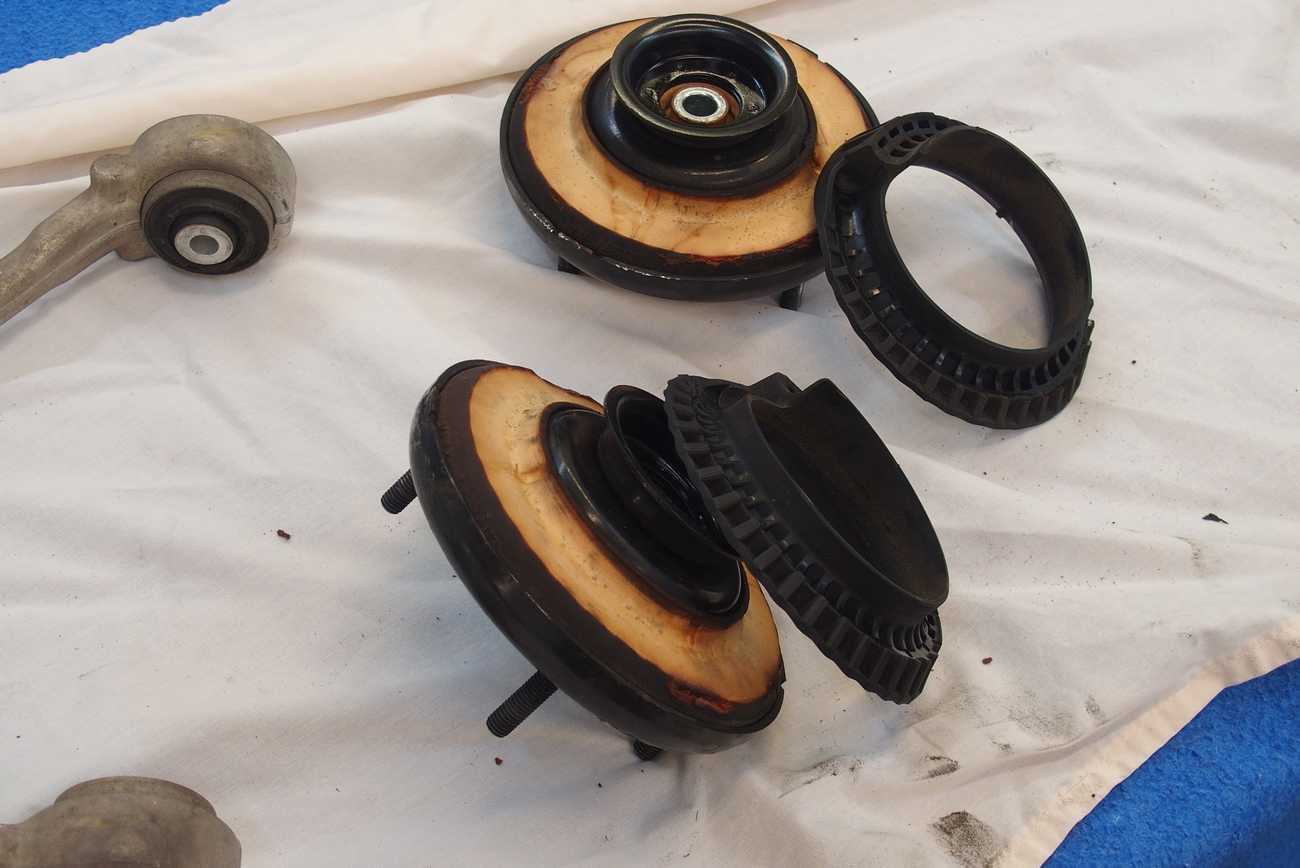

While working in that area I thought the ‘used’ (65K mile) xkr struts could use new mounting cushions.
So here are the pretty parts

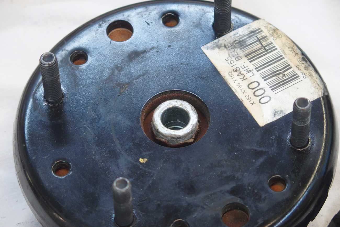

Here are the ones I removed
After my fellow Jag enthusiast and I finished up we were both tired and happy that this project was done.
The results: I can barely feel any changes what so ever. The ugly 125K ball joints didn’t display much play at all. The original shock cushions were ever so slightly compressed more that the new ones we installed.
The job is completed and I’ll rest up before getting into replacing the front seat leather.
Wj
And yes, these shock cushions are a proper fit for the xk-xkr. $46.00 usd for both, shipped (pre tariff) is a far cry from oem pricing!
@wymjym , I’m truly happy that the parts worked well for you. Even though it means I spent $300 too much! Aaaaaahh!!!
I guess in the future I need to do better research on parts cross match.
