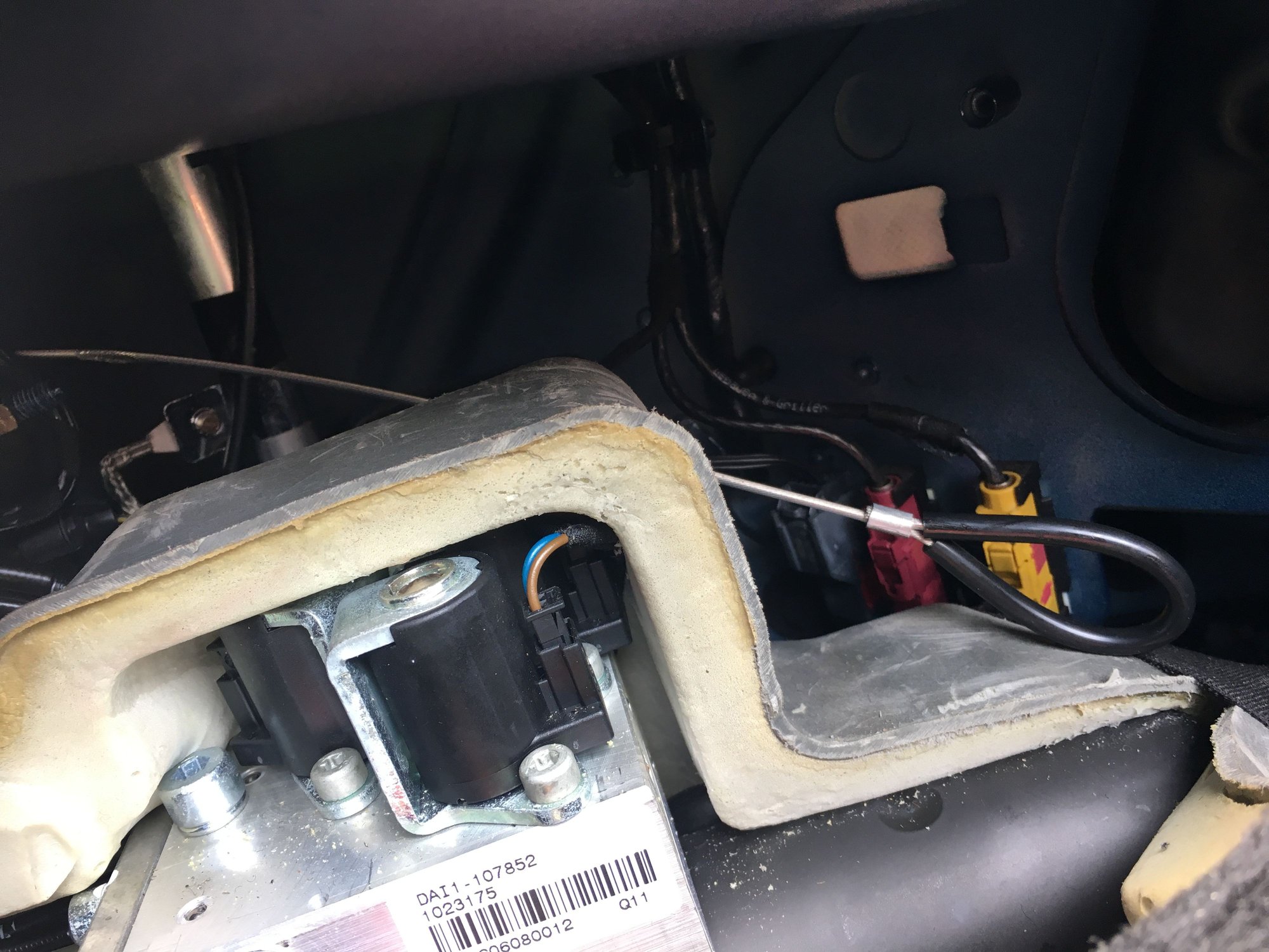

Press he button , top unlatches and then a squeaking ( almost struggling ) sound for the rear flap to open ... doesn’t go past that.
I checked the pump in the trunk and it shows about half inch below the Min line... is it fillable and if so what fluid ?
i also saw this loose cable in back .. not sure if it needs to be fastened down at the loop somewhere ??
any ideas ?

Think the xable is the manual taneau cover release.

Looking at the first picture, it looks like the hydraulic fluid is very low. This would account for the squeal. You can refill it through the gold colored plug, I don't know where to get the fluid other than a dealer. The loose cable is an emergency latch release for the tonneau cover.
