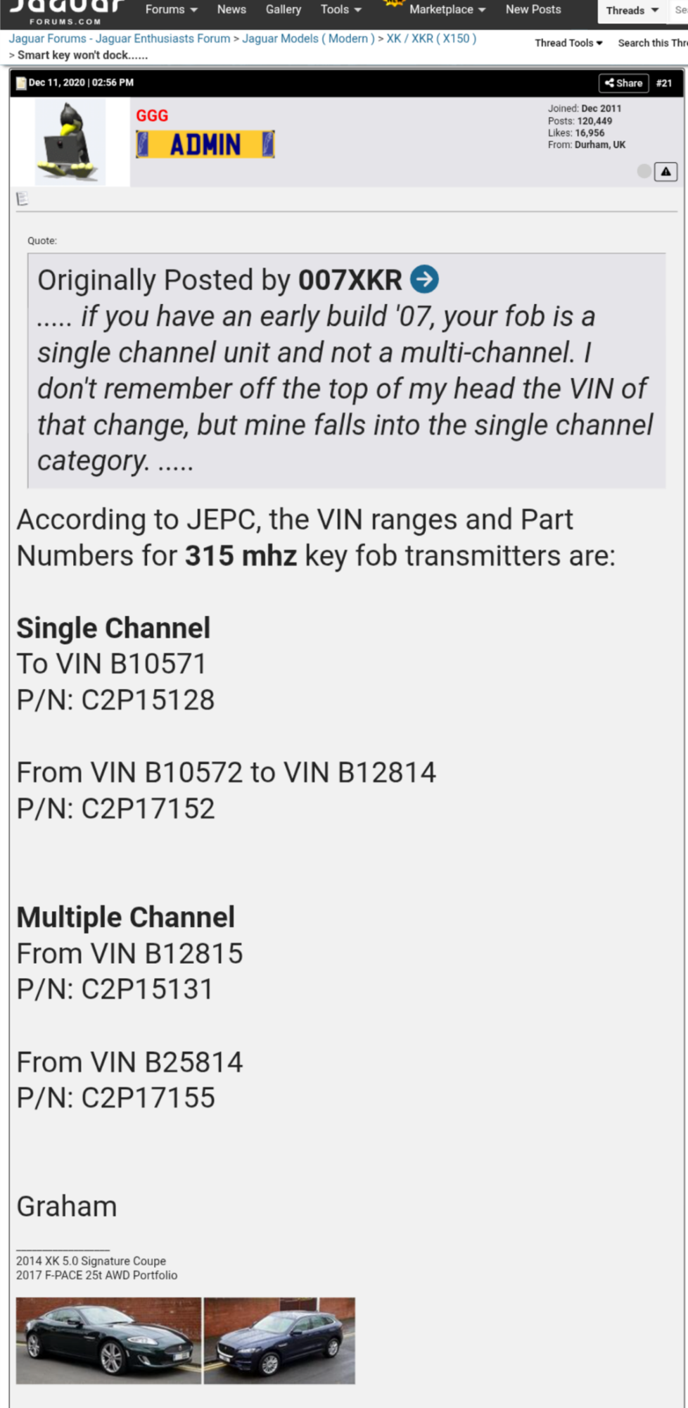

For the 2007 Model Year only, there were two different (and not interchangeable) Smartkey fobs: Single Channel and Multi-Channel. Do you know which one is yours?

Here's how to determine if your 2007 Smartkey is Single Channel or Multi-Channel:
Stuart

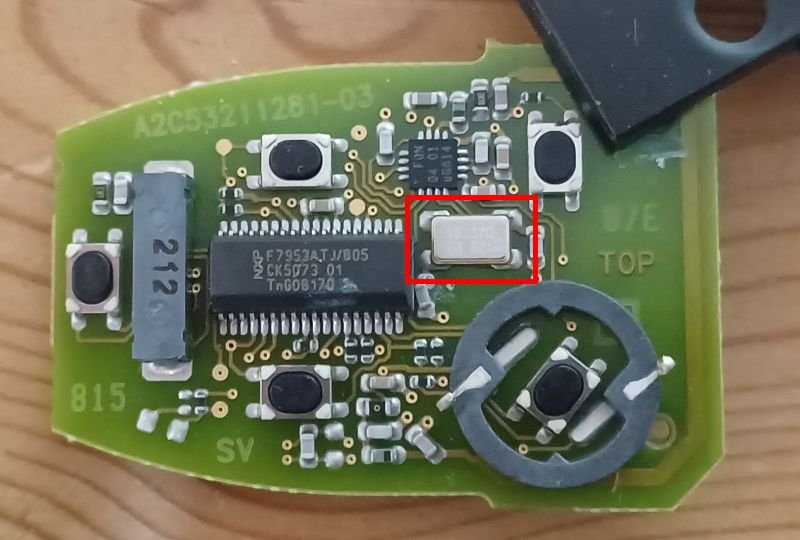

If electronics is your hobby maybe you could swap out the crystal (18.370 in mine) from the other FOB?
