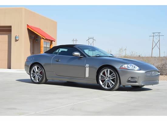

I also own a 2009 Jaguar XKR Portfolio Edition.
This model came with the 20" Selena wheels.
I currently have aftermarket custom milled wheels on my 2009 XKR PE due to the Jaguar option Alcon braking system. I retained the complete set of the Selena 20" wheels and have them boxed and wrapped. Shipping would be from Las Cruces, NM 88011 via UPS.
I have my XKR listed on eBay for sale. If the vehicle does not sell, I will keep it and may consider selling the complete set of Selena wheels for $2400 + shipping ($600 each or reasonable offer). These would also include the Jaguar OEM XKR PE Center Caps in Jaguar red. These Selena wheels were taken off the XKR PE with about 13,500 miles on them and are the OEM Jaguar wheels. Shipping would be from Las Cruces, NM 88011 via UPS. Cost to ship to Texas would not be that much, probably 2 to 3 business day delivery.
My eBay ad ends Sunday night. If you have an interest let me know.

My 2009 Jaguar XKR Portfolio Edition did not sell, so the complete set of Selena 20" wheels are available if anyone might be interested. These are the OEM Jaguar wheels.
Selena wheels as seen in Post #4 above.
