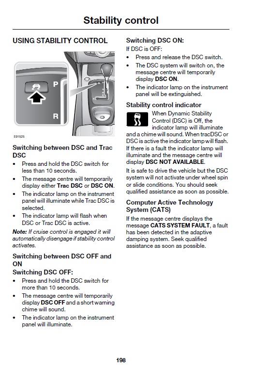

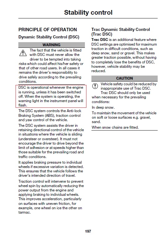

Is DSC OFF a permanent setting?
On previous models, it is ON by default and can be switched OFF but will reset to the default ON next time the engine is started.
The XK Driver's Handbook doesn't make this clear (see section boxed in red on the first page below):
(click on the images to enlarge them)
