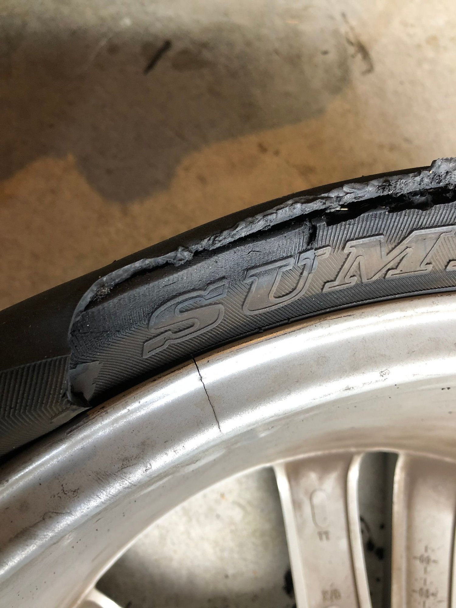

I had a tire blowout on my 2010 XK so now I have a cracked Kalimnos wheel and need to get two new tires. My other three Kalimnos wheels could stand to be refurbished due to curb rash. I could get another Kalimnos either refurbished or off eBay and refurb the other three, but I’m also looking at a couple options for a complete set of F-type take offs with wheels and tires. The F-type rear wheels will poke out about 19-20mm more than XK wheels and the fronts are about the same. I’ve seen one thread where someone put F-Type wheels on their XK. Has anyone done this with 19” Centrifuge wheels and have photos? Any other photos of 19 or 20 inch F-Type wheels on an XK/XKR are welcome.

The crack in the wheel indicates hitting something, rather than unexplained tire failure. I don't believe the tires are in any way to blame.

My wife was driving the car at the time and she didn’t recall hitting a pothole, but it could have occurred earlier... or when she drove to a gas station on the flat :-O. The tires had 17k miles on them and the rears were ready to be replaced. We haven’t driven it hard so I would have expected a little more life out of them.

AHHHH!!!!! Drove on a Flat. Yes, that would definitely split an alloy rim.

The way the pictures look it appears that the rim got cracked from a hard hit to a pot hole or something similar. I am surprised that the TPMS didn't trigger before the tire was ruined. The tire shred after driving on it. My kid had a similar problem because he didn't stop when the TPMS light came on.
