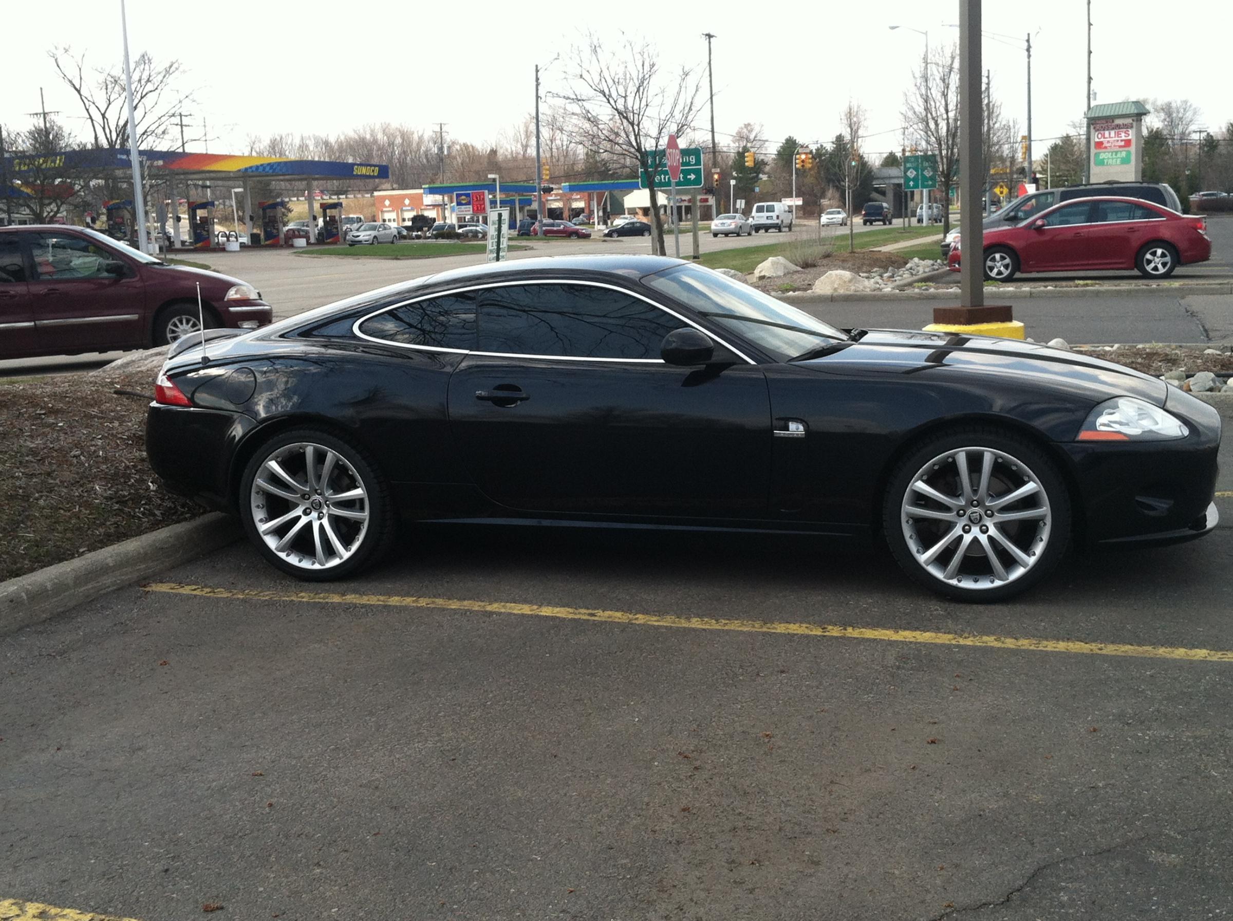

I have a 2007 Jag XK coupe and I'd like to upgrade to high performance brakes and calipers etc... Does anyone have or know of any recommendations? Thank you in advance, Chris.
