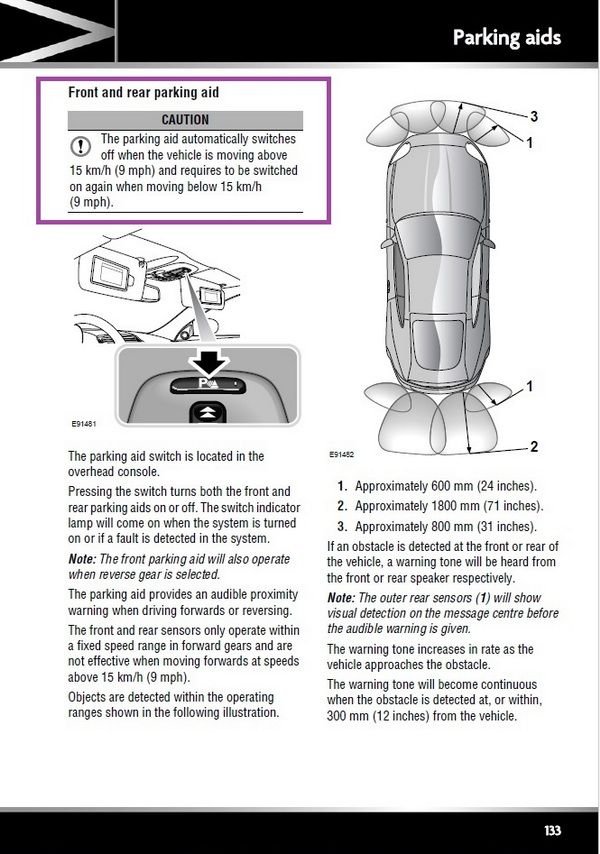

So what is the problem exactly? You stated it works as it should.... so, then what?
Your concern is that the screen picture does not change maybe? It won't, even when in Drive, until the car goes 5-7 mph.
You can also manually dismiss that screen by just touching it once. There is also a button on the roof center stack where it can be disabled and enabled.

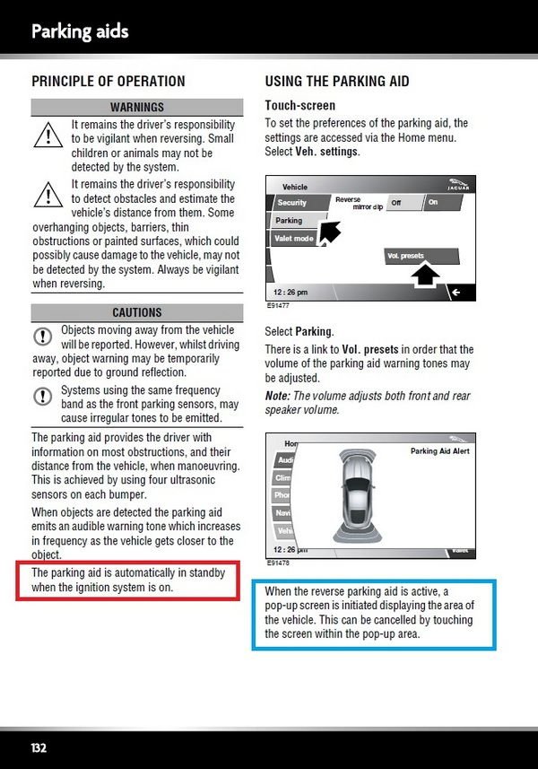

Whoever wrote the Parking Aid section of the Owner's Handbook must have a PhD in obfuscation.
It looks like:
1. the system is automatically ON when the vehicle is started (red and blue boxes)
2. it then goes OFF automatically when the vehicle exceeds 9 mph
3. it requires to be switched ON again when moving below 9 mph (see green and purple boxes)
Status is shown by the indicator light in the overhead console switch.
My reading of the above is the system is automatically activated with the first start up sequence but has to be manually activated when you come to park or it would be triggering in slow moving traffic or overtaking .....?
