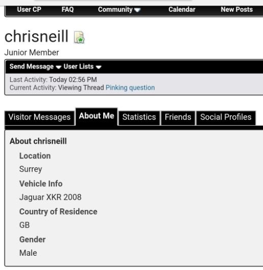

Originally Posted by chrisneill
Its an 06 XK. Unlike regular gas in US (87 RON) our regular is 95RON. Book says fine to use regular and have been doing so for 2 years hence the question.
If it's a 2006 XK, why does your Personal Profile show a 2008 XKR?
