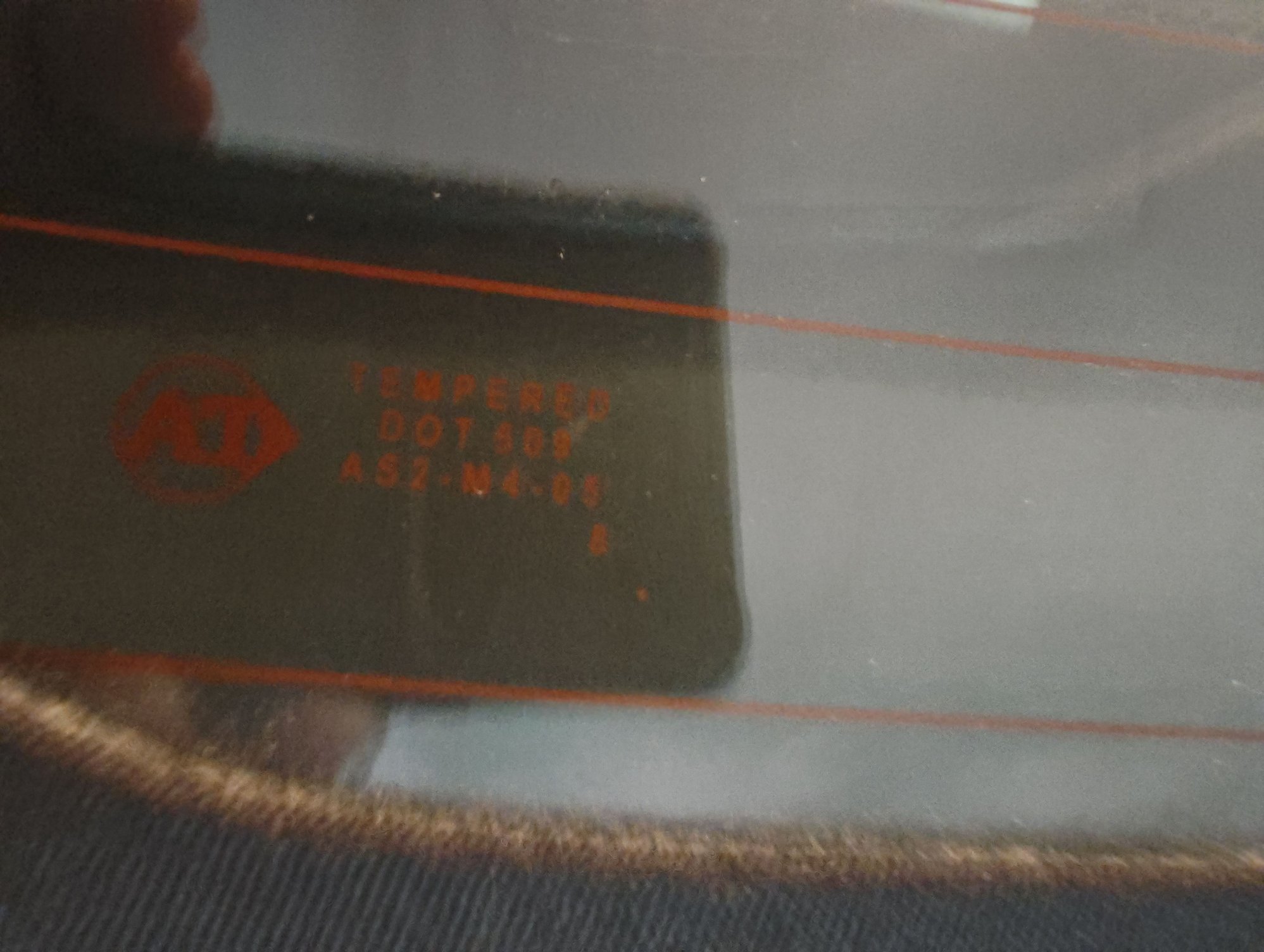

The rear window has come away from the roof lining any ideas on the best way to repair the problem
cheers
As you can see from the photo where the window has come away from the lining

There is a pretty long thread on this problem in here, try searching the forum for Rear Window Glass or similar. Also, since near total fail, it'd probably be best to replace the entire thing instead of a repair.

Sadly, your top is beyond the point of no repair because the glass is completely separated from the fabric. I have a lot of experience with prolonging the life of my top, and have successfully reattached my glass using Rhino Glue and Suck N Clamps. See:
https://www.jaguarforums.com/forum/x...-113105/page6/
https://www.jaguarforums.com/forum/x...lation-284476/
Note that replacement tops are available on the US eBay website from several vendors who ship internationally. I suggest that you compare their delivered prices to those available to you locally in the UK.
Sorry for the bad news, but convertible tops don't last forever. Good luck!

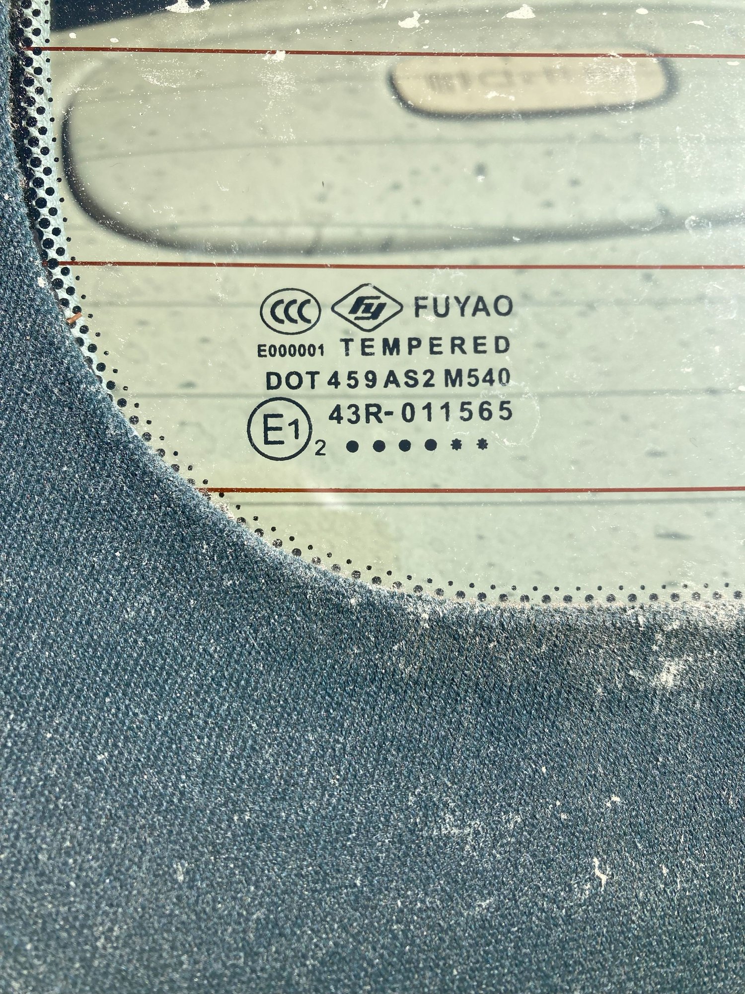

@Jaunty Please post a photo of the bottom left corner of the rear window that shows the logo. Thanks. Glad it worked out for you!

As requested, this is from the new hood. Id be interested to know what it tells you?
As requested, this is from the new hood. I'd be interested to know what it tells you?

Fuyao Glass Industry Group Co., Ltd is a Chinese manufacturer of automotive glass with factories in many countries.
https://en.m.wikipedia.org/wiki/Fuyao_Group
I'm a Veteran 🇺🇸 and Buy American whenever possible. That's why I returned the top I bought on eBay - it had a Fuyao glass window. My new top's glass is made by AutoTemp, an American company in Ohio.
