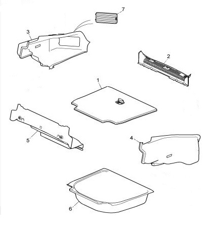

Old Dec 24, 2017 | 10:53 AM
If your XK has a spare wheel, you'll see the negative stud on the luggage compartment floor to the right of it - should be covered with a black cap.
If you don't have a spare but have the tyre repair kit instead, then you'll have to remove the carpet trim item 6 to find the negative stud:

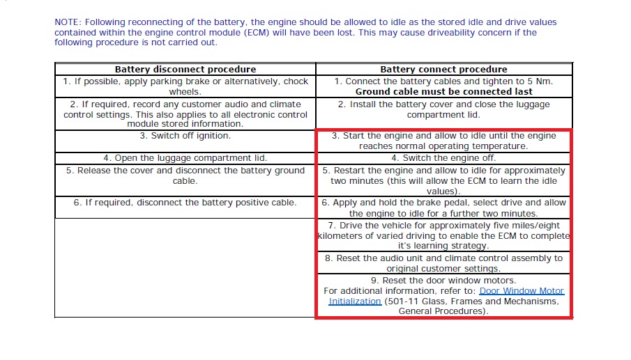

Old Dec 24, 2017 | 05:15 PM
A flat battery has a similar effect to a battery disconnect/reconnect - all the adapative settings are lost.
You should follow the same procedure as a reconnection (see red box):
As the vehicle is maintained on a CTEK, I think the battery could be failing.
