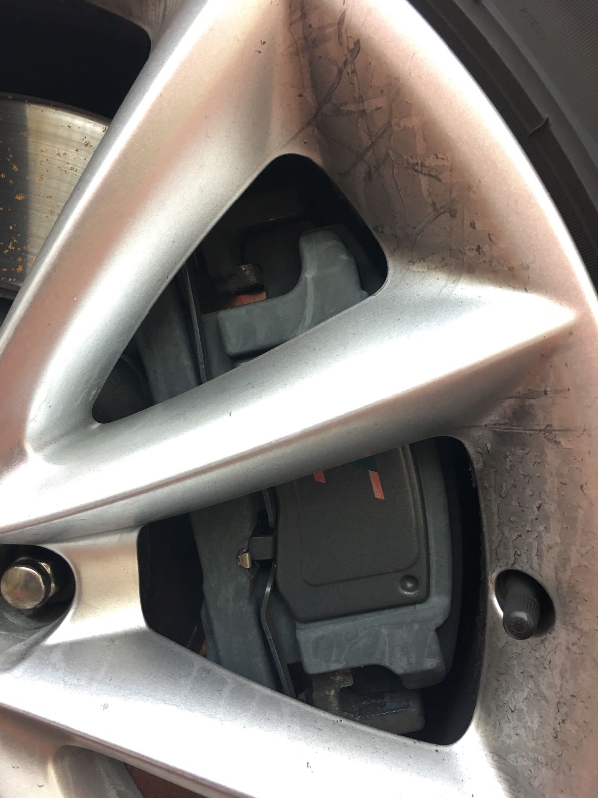

I cannot find Akebono in Europe and the big question for me is:
The ceramic pads work with the original brake rotor?
On Akebono online catalog, I can only find pads for rear axle, when I select my car.
Attached Thumbnails Type of oil and Brake pads-screen-shot-2016-10-12-21.07.09.jpg

Yeah, you won't find Akebono for the fronts on the 2010+ cars.
EBC, Centric, and TRW are popular ceramic pads.
See this thread, in which you already posted:
https://www.jaguarforums.com/forum/x...c-pads-165708/

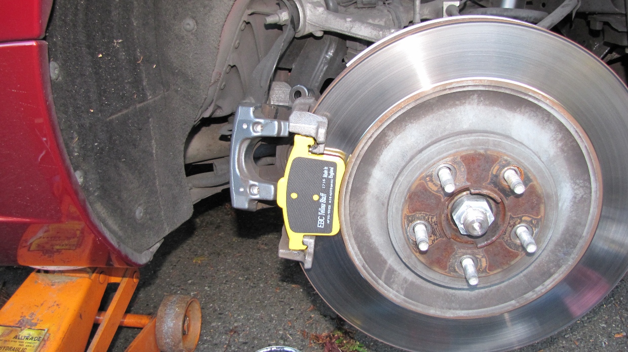

Only two rotors options for our 2010XKR, stock(ATE), and Alcons.
Not sure where the term "Not for sport package" comes to play, but ATE .vs Alcon are easy distinctions in any parts catalog.
Just tossed EBC Yellowstuff on all four corners of my 2010. It was the rears tossing the worn pad error as everyone has discovered. $141 fro the front pair, $100 for the rear. $60 for the pad wear sensor.
These are high grip pads, and pretty dusty (although not as bad as OEM)
Everything else available (Akebono, Centric, and TRW) are just basic run of the mill ceramics, which grip with heavy foot effort, and don't modulate worth a darn, but they are low dust.
If your a spirited driver, Yellowstuff is your only performance choice. Beyond that ceramic is ceramic, and any name on the box will do fine.
