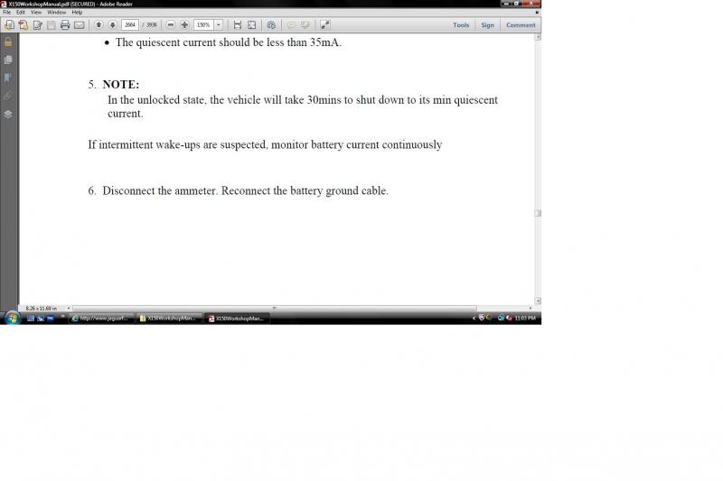

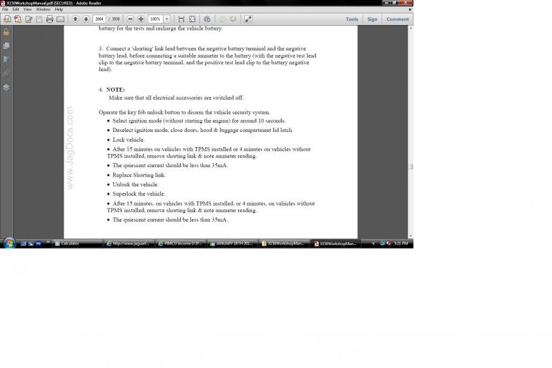

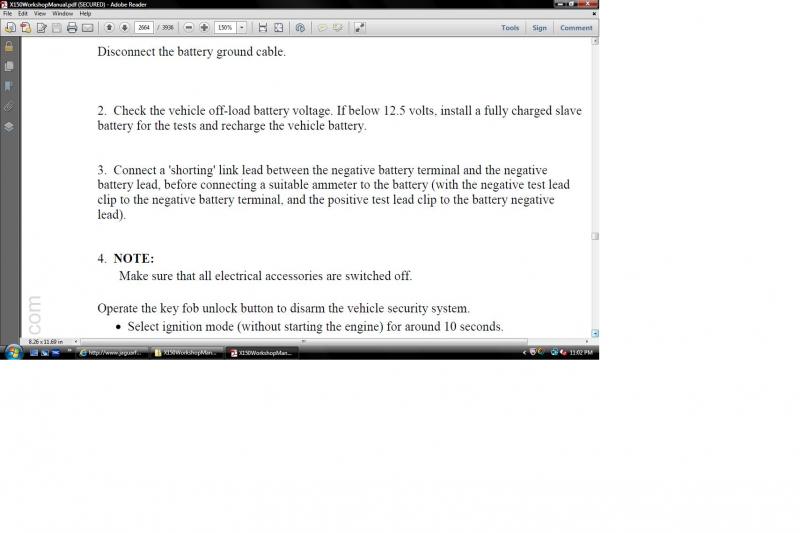

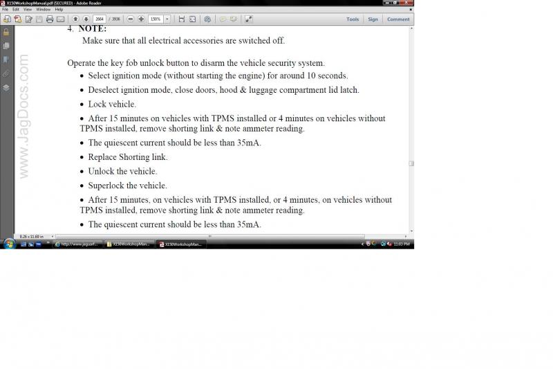

The factory manual gives a clue how to determine if the draw is too high. See the attached jpg. If you have a good meter similar to a Fluke 88 or better, you can put it inline with the battery and set it on amps and compare your readings with the manual.
Edit: I can't even read the attachments. The manual says 35ma is the draw when everything is shut off/down.
I know on my car, if the car is locked up for over fifteen minutes or so, and your just reading the battery voltage only with a meter, I see 12.22 vdc. IF you then unlock the car the meter drops down just under 12vdc (somethings working pretty hard there all of a sudden).
But actually reading the draw has to be done with a amp meter or a meter like the Fluke set on amps and set up like the second picture I attached i.e. pull the neg lead off the battery.........connect one lead of the meter to that neg lead and the other meter lead to the battery negative post. Meter set on amps as shown in the jpg. Then have the meter and it's lead outside the car and shut the trunk lid and lock the car. After a while the amps should drop to approx 35ma from then on if all is well.
EDIT: I added three more jps that can be read a little better than the first jpg.
