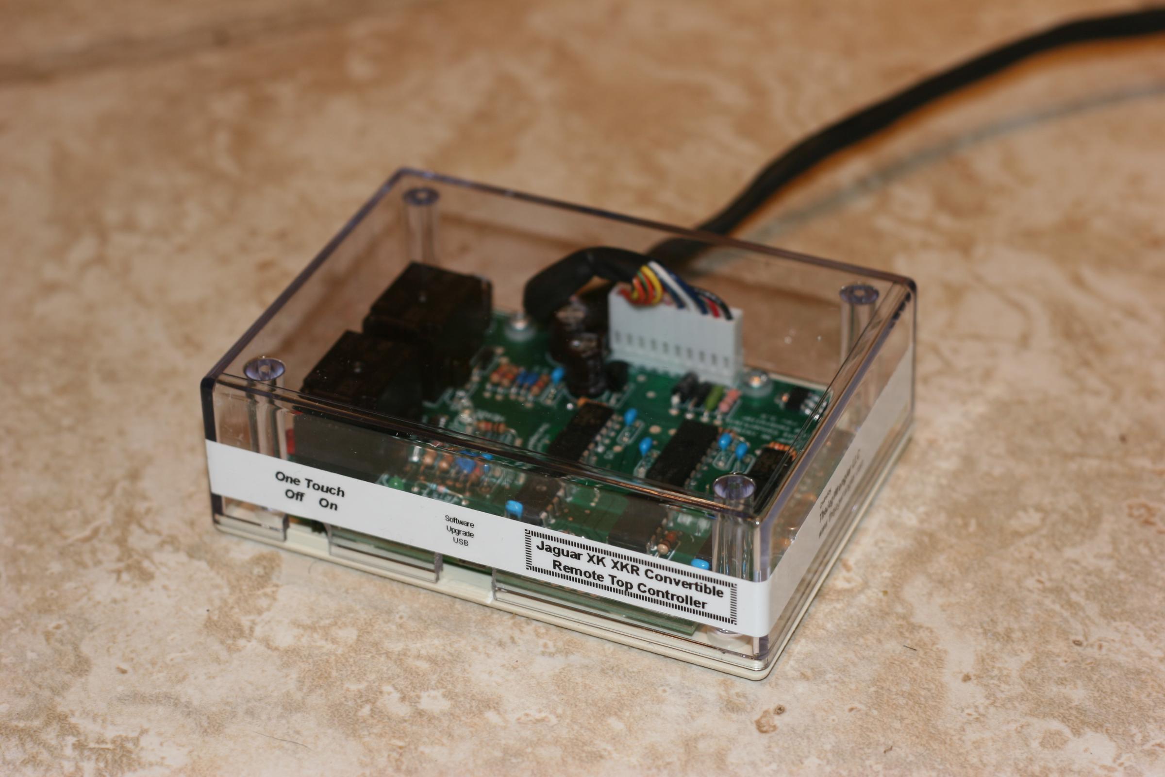

Yes. I started the project about a year ago. Quite early on, in February 2013 I posted success with a proof of concept: https://www.jaguarforums.com/forum/x...l-works-90753/.
But the devil is in the details. It took the rest of the year (OK, this is not my day job..evenings and weekends) to get this to the point of a reliable product that is straighforward to install. A big part of that was dealing with the types of special issues that Alan refers to as gracefully as possible.
To specifically answer Alan's question a second press of the lock or unlock button will stop the top in its tracks instantly. Then with another press you can continue the cycle or reverse the cycle. In other words if there is an object in the way you still have control. However, as with manual operation, you need to pay attention to what you are doing for safety. One touch operation on the console can also be disabled with a switch on the module if you have small children.
Dead battery behavior is unchanged. You need a good battery to operate the vehicle, including the top reliably. The interior top switches will work with the engine on or off now.
Some will be concerned about the impact on the battery. The module was designed to sleep after 60 seconds and provide no significant drain. A single top cycle drains approx. 0.1 to 0.2% of the battery charge. This has been well proven on the earlier XK8/R which supported top operation off of battery to not have a significant effect on battery life in typical use.
Obviously, if you stand around all day and amuse yourself by putting the top up and down it is a different story.

Very good, thanks for the information. It sounds like you did a great job with the R&D!
