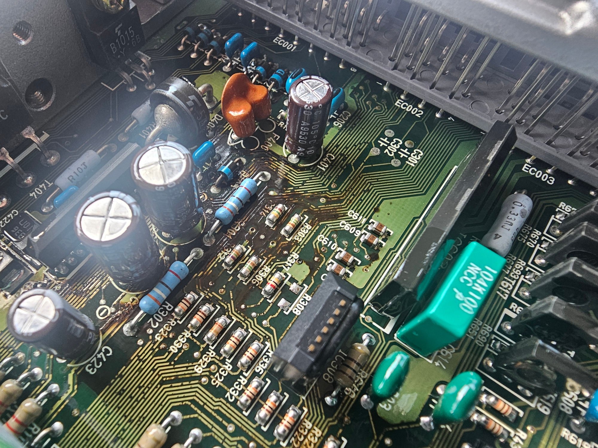

Okie dokie…. Here goes nothing…and I MEAN nothing; mechanic has NO codes to give me. Couldn’t get it to send code, so took the computer out , circuit board was wet, dried it, put it back in. Said it ran, got hot. No codes being sent. Says he’s thinking outside the box. I had absolutely no issues until dash warnings came on and I took it in next day first thing. Am preparing to offer a kidney on EBay..

....so took the computer out , circuit board was wet, dried it, put it back in. Said it ran, got hot. No codes being sent.
I wonder how on earth water got in. The electronic module is in a metal box, which is itself inside a plastic container with some degree of sealing, and then under a protective cover inside the false bulkhead.

Hi I have a 97 as well usually this kind of issue is the capacitors on the ECU if they are going bad. If you open the ecu and see bulges on top of the capacitors they are bad and can cause all kinds of random issues. The picture below shows the one capacitor bulged and leaking. This is very common on the early cars. Easy fix just have them replaced. It should be done before the capacitors pop and ready damage the tracing on the board.
