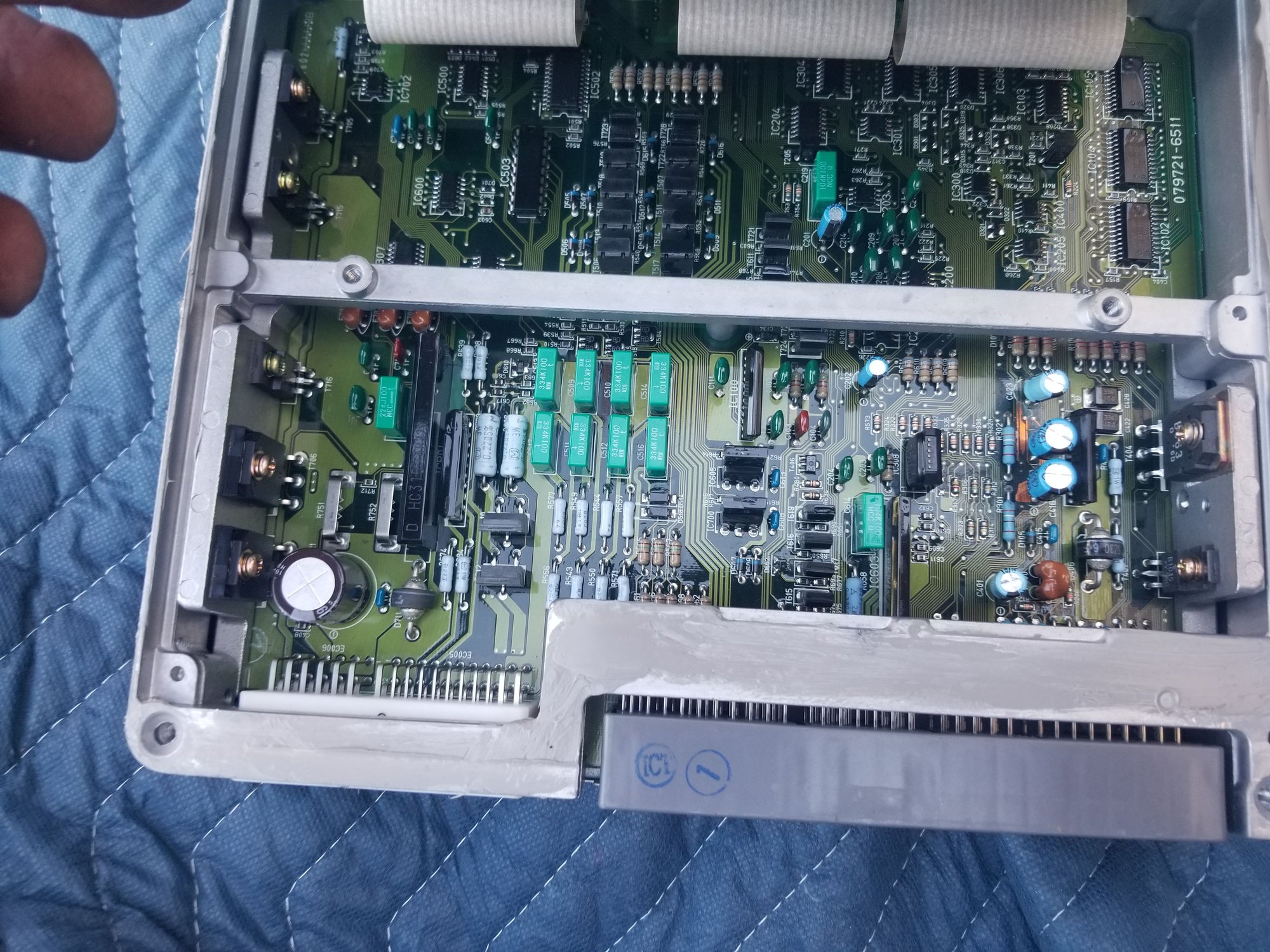

If you're intending to double-check the ECM, would you take a couple of shots of the circuit board while you're in there if there's any sign of corrosion. A shot of the capacitors, showing the date code (e.g. A9530 - week 30 of 1995 - in Dave's post above) would confirm whether they're the originals, or the ECM has been refurbed at some point.

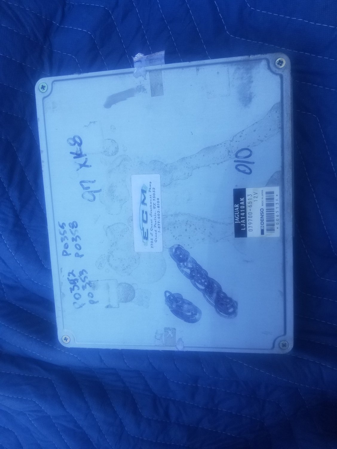

Went back to Rosevillesister today. The only issue is the coolant temperature gauge. It will be working normally at first start up. Starts on cold and moves to half way when warm. Checked data stream and it was at 181°.
Stut the car down and restart the gague was showing just a bit above cold and data showed 112°. It only when up a little bit more, maybe at 1/4, but I touched the crossove pipe near the sensor and it was very hot. Definitely more than 112°.
Took the ECM out and examined it closely, tried to upload the pics I took but couldn't get it to work. I will try again layer.

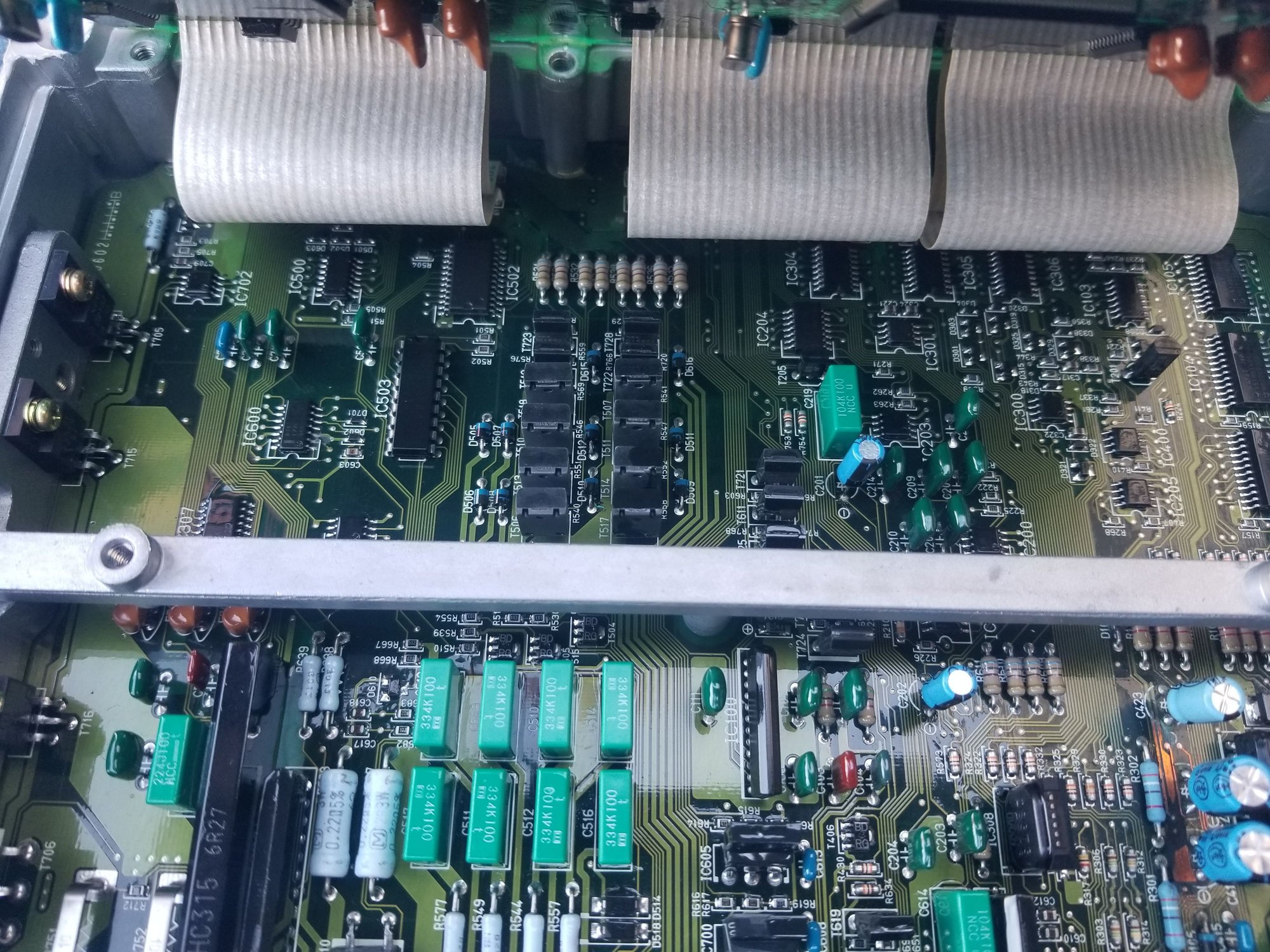

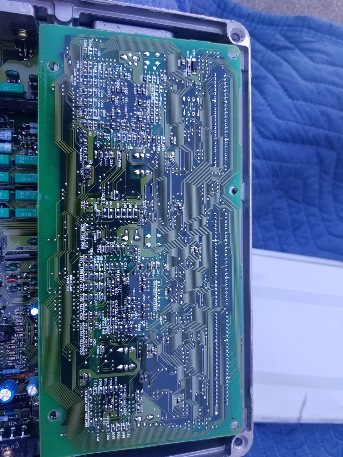

The ECM look pristine inside with no signs of water intrusion. The capacitors looked good with no leakage and no corrosion on the board anywhere.

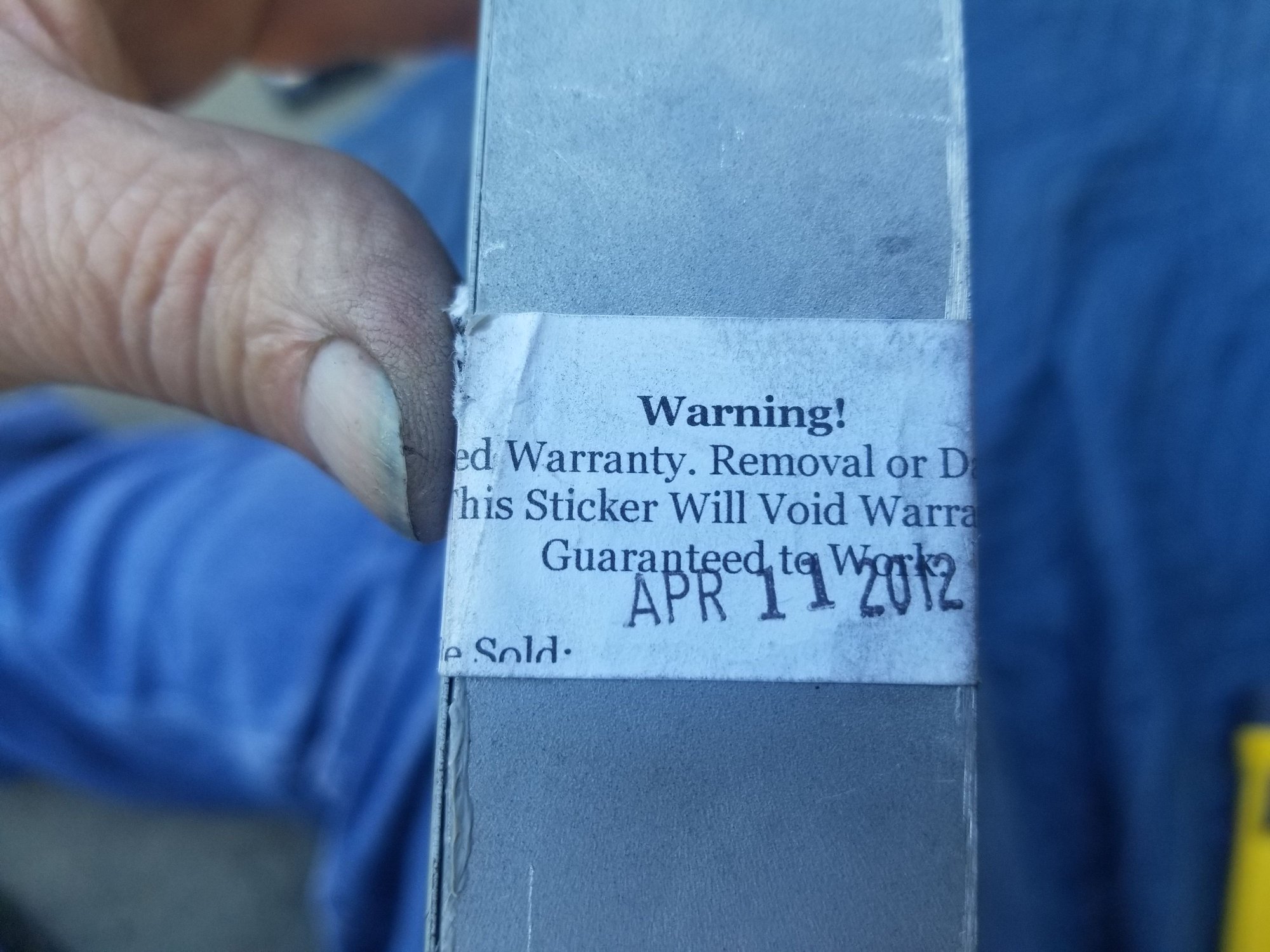

The ECM was updaed or repaired on 4/11/2014 according to a sticker on the outside. It was done by ECM of Grand Prairie, TX.

Figured out how to upload pics of ECM.
Old Mar 20, 2026 | 05:55 AM
  #28
daveb97's Avatar
Joined: May 2025
Posts: 50
Likes: 24
From: Toronto Ont Canada
It looks like all the capacitors except the big one down in the bottom left hand corner have been replaced
