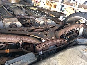

now the interesting part - sat in a garage about a mile from the ocean, and undercarriage has some rust / corrosion - I am attaching pics
it is being sold by a family member, clean car fax, original paperwork in matching name, window sticker at $88k, etc - has original tires on it that are cracked and no longer safe
I have been offered it for $3k, and have a reputable guy w/ a lift standing by to work on the bottom side to treat and paint / stop parts of the rust

In my opinion the rust will give you headaches in the future. I think it's not a matter of if, it's just a matter of when. The ocean or salt is not the real problem. Salt is only bad with water. I think Hawaii is pretty humid, isn't it?
At any rate, just by looking at the photos I can see rust seems to have contaminated the car. I seem to be able to see rust in cracks, screws and gaps. This is normally a sign that it's rotting underneath. As a teenager I worked at a bodyshop and cars that looked like that were a telling sign of eminent rust problems or downright horror underneath.

For the rust, the mechanical parts are not necessarily terrifying. The whole rear subframe comes off and I suppose could be restored (sandblasting, primed, painted, etc). The exhaust could be replaced with stainless steel ($$$), etc. My superficial understanding is that the major weakness area in the coupe is the seam area under the driver/passenger doors. Something to do with 2 layers of metal allowing for a gap. I believe the convertible design is a bit different there. Some have that area so far compromised that doors seem to sag, when in reality the whole unibody is compromised. Our UK members seem to be well versed in rust challenges. In short, it's not for everyone...

The common rot areas are well documented on this forum and elsewhere. I see some surface rust on the rear subframe & front suspension brace, and around the floor pan needs a closer look, but - provided it hasn't been flooded - nothing horrendous.
Have a trusted advisor review the underbody and go from there.

That rust looks like the typical Florida, California car salt spray + fog rust you get from parking the car in a carport less than 10 miles from the coast, instead of a garage.
That takes many years to eat painted body panels, unlike road salt rust.

Are you kidding us? Poke around the floor pan with a sharp screwdriver and see if there is any rust-through. If not, you just have surface rust that can be treated, painted and rust-proofed. There are no codes? What you seem to have is a low miles XKR $3,000.00 bargain! Then you can sell it for $13,000.00 and invest the profits. My car with 95,000 miles in New England winters has about the same appearance underneath and I have not bothered to repaint any of it. The exhaust is mostly S/S and still in great shape.

When it goes in for tyres, have a good look at the inside of the rims. They will need cleaning for a thorough inspection.
I had a 2005 XK8 4.2-S on Sepangs which spent the first six years in Ayr on the west coast of Scotland next to the Atlantic Ocean. It had some surface rust on the underside but not as extensive as your photos. However, the insides of the front wheel rims were badly corroding. They had to be stripped, repaired and refinished. The rears were affected too but not as much.
The car was fitted with aluminium Brembo brake calipers which also needed refurbishing where significant areas of the surface had just turned to powder.
