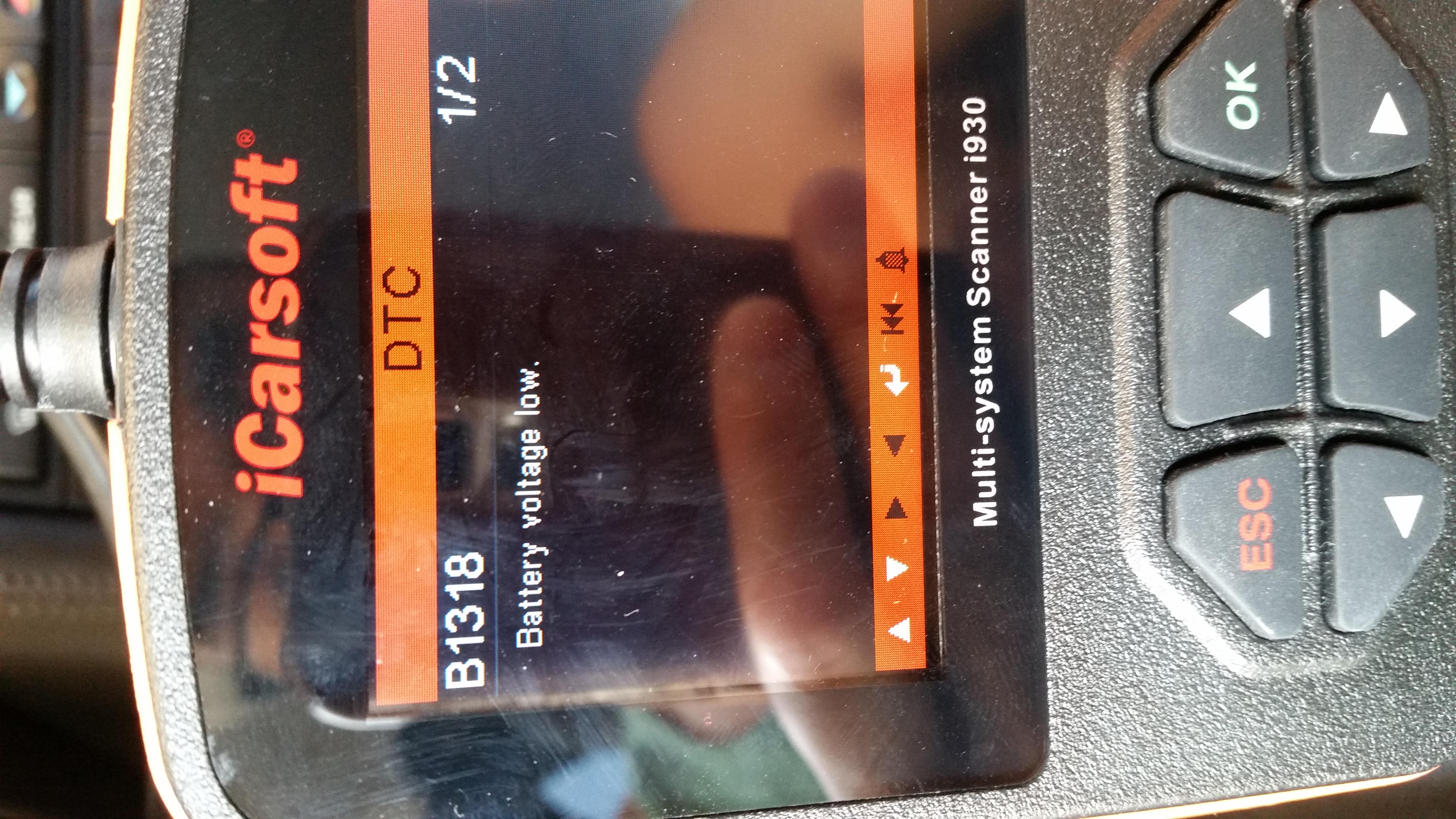

Hi guys,
My airbag lights was on since last week.... it was fine the first 15 minutes and then the light blinks 3x and 2x and then constant on until I turn off the engine...I pulled 2 codes with my icarsoft
Any idea, how do I diagnose this?
My battery was replaced January 2016 so I don't think it's the battery.
ALSO does anyone know any good independent Jag close to Thousand Oak California??
Attached Thumbnails 05 XK8 srs airbag light on-20170716_113501.jpg   05 XK8 srs airbag light on-20170716_113452.jpg

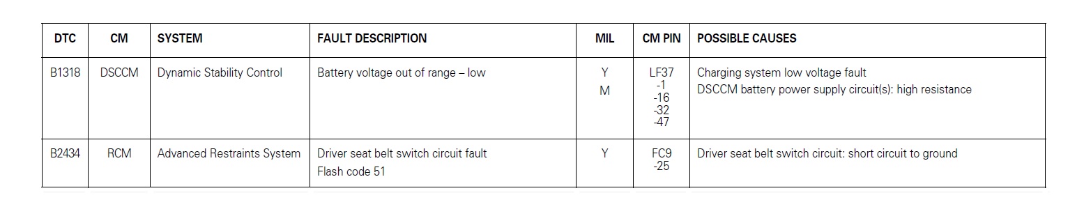

Regardless of what you use to read codes on a Jaguar, the only reliable decode is the Jaguar DTC listing. Here's the extract for the two codes you reported:
B1318 is not related to the SRS and B2434 should be accompanied by Flash Code 51.
Check your Flash Code count again. Possibly misread or you may have additional SRS issues.

My SRS Flash Code lookup doesn't list 41. The additional information for 51 + B2434 possible causes is:
Connectors: FC009, SD001, SD020. Driver Safety Belt Buckle Switch.
Harnesses: Instrument Panel. Driver Seat
