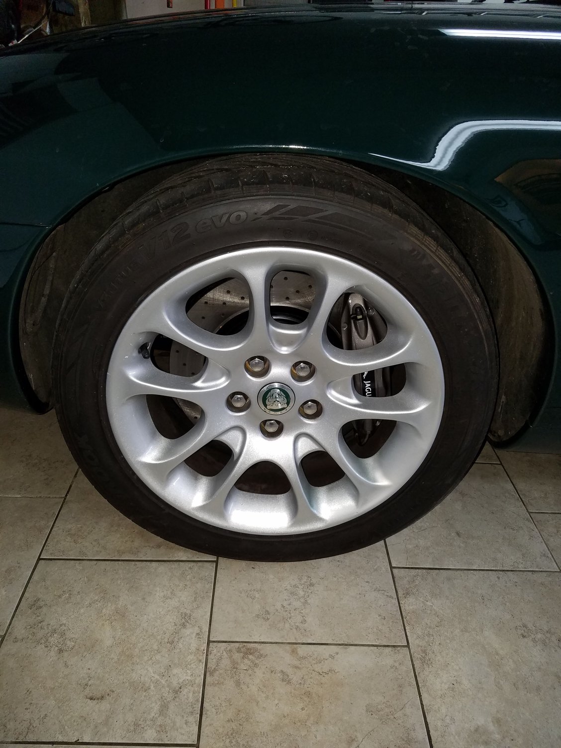

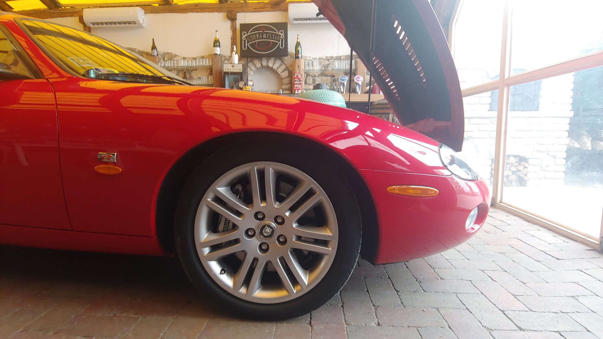

1. Yes 18" Hydra (14spoke) is working with the 355 brembo discs and big brembo calipers up front without problem !
This attached photos is a good example : 2003 XKR convertible - with 18" Hydra wheels + Brembo big brakes
