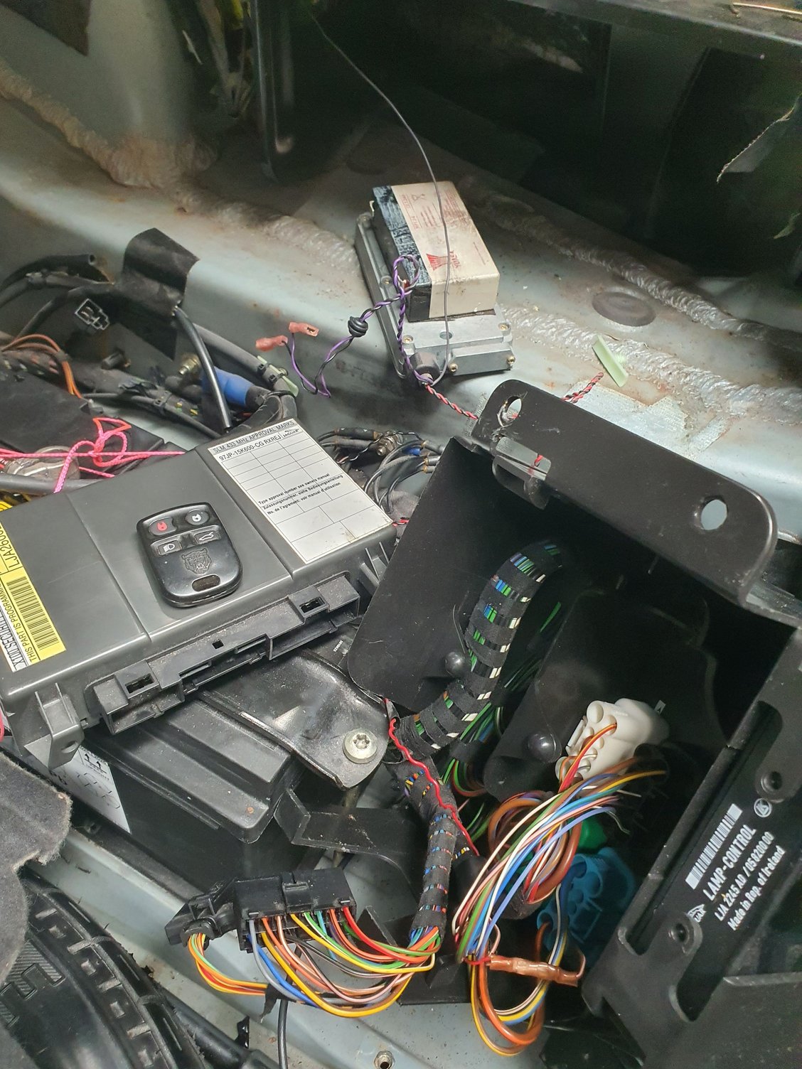

It arrived with no key fob so locking and unlocking by key was fine as long as long as I got the key in the ignition before 10 seconds to prevent the alarm going off.
I've just had it in at Fonte Motors in Perth for a few jobs and they bought a second hand key fob from Roadbend Jaguar to fix this problem but they could not program the keyfob to the SLM. ( The keyfob has been tested and is transmitting 433mhz).
I've just removed the SLM to get it tested , not sure where yet but while I was in there I noticed this little battery (dead) stuck onto some kind of module??
Any pointers on where in Perth I can get it tested?
Any pointers to what else in the security set up needs testing?

That is the wrong key fob for your car, so you can put your SLM back:-
https://www.jaguarforums.com/forum/x...t-next-285730/
That module is probably an aftermarket tracker You might want to check where the wires go to be sure that it isn't some kind of immobiliser also.

Hi Dibbit,
You are correct re the module with the 6V battery. It is indeed a Tracker.
Still no resolution found for the remote control units. Seems no one has a fix.
I import various bits and bobs from China and visit regularly. Im thinking if its worthwhile taking the Module to Shenzen to see if they can produce something that will do the job.
