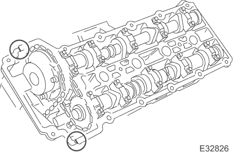

This is where WhiteXRK was commenting on for sealant, it's the only place and if you have the chance after this you can post pics with your comments to show what he showed you ;-) (you might need a min # of post like 10 or so before you can)

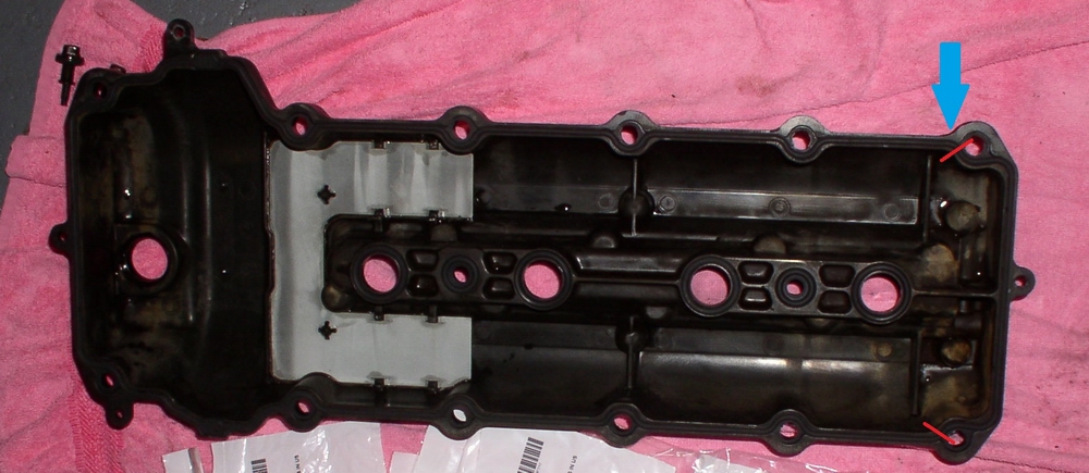

I've come across a few with an annoying leak onto the hot manifold which I'm sure, as others have said, is the result of careless over torquing. The problem is once taken off, it's very difficult to see any crack in the Cam Cover because it's no longer under tension.
The ones I've seen have had crack at the places marked with a red line in the photo.
Cracks in metal such as cylinder heads or block is usually easy to find with a UV crack detection spray but if an equivalent product is available for plastic then I haven't found it yet.

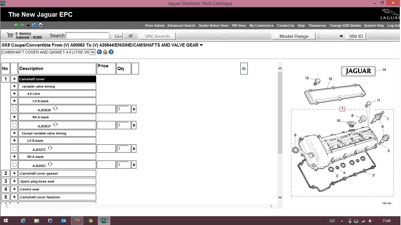

I was also wondering if anyone knows the part number for the driver's side valve cover. I have found a few different ones and I'm a bit confused. Thanks all around.
Old Feb 28, 2015 | 11:53 AM
Originally Posted by Axiom
..........I was also wondering if anyone knows the part number for the driver's side valve cover. I have found a few different ones and I'm a bit confused. Thanks all around.

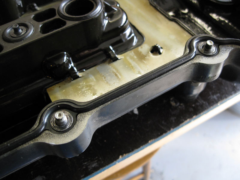

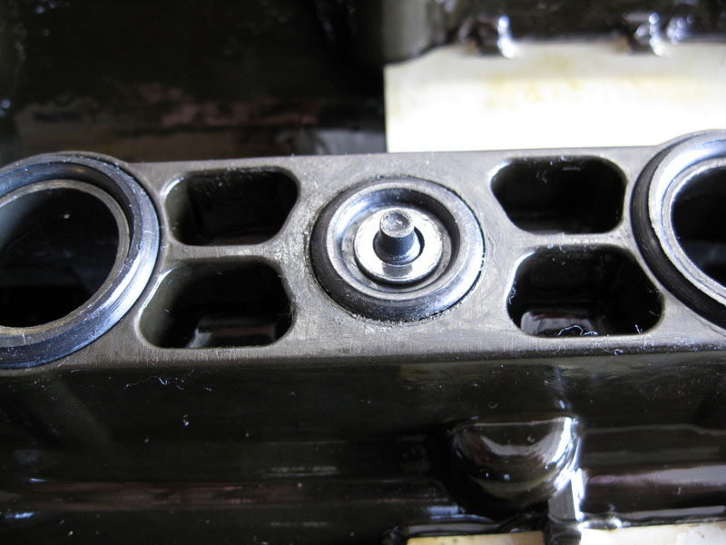

I recently removed both my valve/cam covers and reinstalled new gaskets. I found that all the bolts have shims on them that prevents you from over torqueing the bolts on the cover with the exception of one bolt in the back on the top on both sides and it is different for a reason.
When I was installing the new gasket I found that you must have the bolts in the cover and you need to push the gasket behind the shim of the bolt if you do not do this you will have a leak. I would also recommend that you clean and make dry any place your new gasket is in contact with for a proper seal.
Attached Thumbnails 2000 xkr valve cover gasket leak-img_2648-2.jpg   2000 xkr valve cover gasket leak-img_2649-2.jpg
