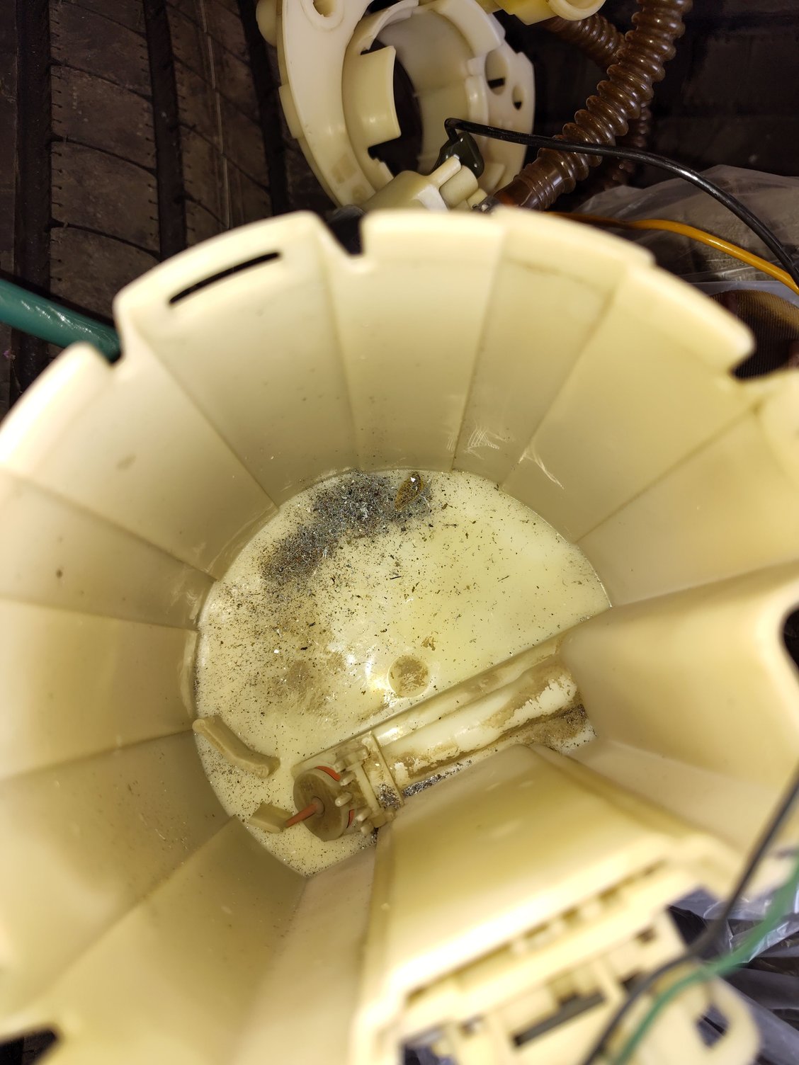

After having driven the car a lot more since the last post was made. A lot of lack of power has become an issue, most of which was due to the car still having the original fuel filter and the fuel pump going out as a cause of that putting too much pressure on it. I have done a new set of ignition coils and plugs clean the map and replaced the air filter all of which seems to have helped the car but I'm still having a lot of hesitation/misfire in the mid-range of my throttle pedal if I slowly ease into the throttle even up to full throttle at that point I don't have any issues if I go straight to full throttle I don't normally tend to have any issues. That being said I know the throttle body needs cleaned it's got a lot of junk in there which is next on the to-do list any pointers or tips for that job would be greatly appreciated. But since replacing the fuel pump I have started getting misfire codes for all cylinders with multiple cylinder misfire code as well as p1313 p1314 and p1316 codes even after changing the fuel filter these codes are still coming but they do not stay lit the car will go into limp mode for roughly 30 seconds and then the check light will turn off the car will come out of limp mode and go right back to running great no noticeable missing at idle unless you're revenant and like I said you've got some hesitation / missing at mid-range of the pedal. Any other ideas that anyone may think could be causing this I'll be all ears hopefully the throttle body is vast majority of the problem. I will be cutting the fuel filter apart and posting pics soon.

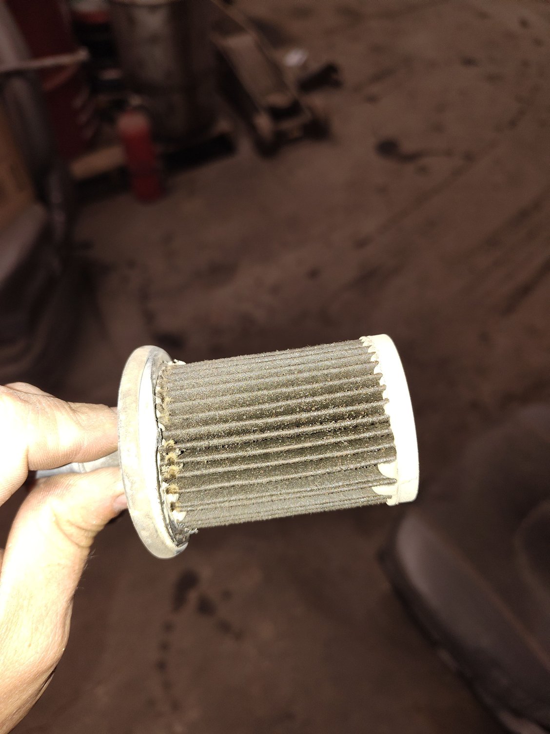

Here is the pics of the fuel filter as well as inside the fuel pump housing.
There was a lot of metal shavings inside both. The fuel that came out of the filter was almost solid black.

My guess is that the metal shavings resulted from you cutting open your fuel filter. Unless your fuel pump is actually disintegrating inside....
