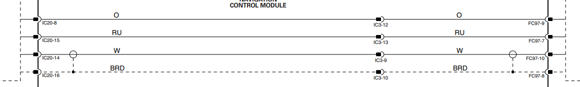

Using the GBS-8100, I've managed to inject RGB+S video to the original navigation screen, but I've encountered my first hurdle: The stock navigation screen will not power on unless the original headunit is plugged into the yellow 26 pin 185879-1 connector and multilock power. The headunit and nav screeen have 3 wires between them and I've identified that the Pin 8 Orange wire wakes up the nav screen, but it is not a simple ignition feed or a line being pulled to ground. The screen does not seem to care whether its original DVD navigation unit is plugged in either, it seems the stock headunit holds the cards in this case.
Message #58 on this post here alludes to someone being able to keep their screen powered up even without the headunit. Any insight about this from the hive mind would be appreciated!

Sounds like an interesting project. I ditched the OEM screen for a Garmin sat nav as I felt it was the easiest way to upgrade the screen.
Are you absolutely sure that pin 8 is the essential connection? If it isn't a straightforward switched ground or power, then is it the data line from AI-NET? I think I would go back at this point and double check everything, because I'm not sure why the head unit would be controlling the sat nav.

From what I've tried so far, if I pull the three wires that go between the head unit and nav screen, the orange pin 8 wire is the only one that tells the screen to wake up. Interestingly the on/off button works when pin 8 is plugged in too. I need to get a scope on it and check out what it's doing.
There is no AI-NET connection between the headunit and nav screen, and the screen doesn't seem to care about the nav DVD unit not being plugged in.
There are two lines that go to the dimmer control module, these seem to be wired directly to the distribution point rather than through the head unit. There are two additional lines that went between the screen and DVD unit, likely to pass on the button presses.

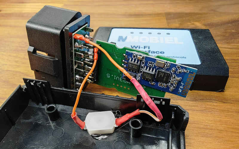

For the OBD dongle you can rewire it to use the switched B+ that Jaguar added as one of the vendor option pins in the OBD connector. Your dongle will come on and off with the ignition:-
https://www.jaguarforums.com/forum/x...0/#post2891978

Regarding the nav screen, turns out it was something obvious I was missing. When I was probing the rear of the head unit, I was doing so with the 26 pin connector disconnected. I probed the back again with some needle probes whilst the 26 pin was plugged in this time.
It turns out pin 14 is some sort of control bus between the nav screen and head unit, so without it being present, the head unit was not outputting 12v on Pin 8.
It appears whatever bus is that is on pin 14 carries some of the controls, at least the ON/OFF button from the nav screen. When the ON/OFF button is pressed, the head unit toggles 12v on pin 8 on and off.
All I need to do is just wire up Pin 8 to a switch that is fed off an ignition feed, then I can turn it off and on when I want. If I wanted to go down the fancy route I could open up the screen and connect the ON/OFF button to a latching relay but that would be overkill for what I want to do.

I can now confirm that the pin 14 is the control bus for all the buttons, so I'm guessing the radio puts it on the AI-Net bus and communicates back to the nav unit that way.

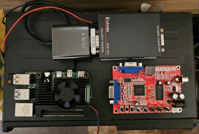

Here's the Pi booting into a premade image of Android. I've ended up going with a different android build now, as I wanted the GPIO exposed as I need to have a script that monitors the cars ignition line to safely shutdown the Pi when ignition is off. The Pi shuts down quickly enough that it can be powered by an 10 second timer relay, so sequence of operation is as follows:
Ignition>timer relay engages>Pi powers up>monitor script starts monitoring ignition via GPIO pins>ignition off>script executes shutdown>after 10 seconds relay disengages and standby power to Pi and ancillaries is cut.
I'm not an expert at coding so Claude AI has been a big help in modifying an existing script to support my use case and compiling it on the Pi itself.
I've gone with @dibbit suggestion of getting a Wifi OBD2 dongle instead, so that's in the post. It will stick out a bit too much, but I've got an OBD2 harness left over from a tracker from an ex-lease car, so will find somewhere to stuff the dongle out of sight.
The parts will squeeze into the CD changer, I'll stack the DC converters on top. I may also need to add a filter if alternator whine is an issue, hopefully not. I'll make up a VGA lead from some bare D-Sub connectors as no way an off-the-shelf one will fit. Mounting the connectors will be a bit irritiating due to the housing design that used to accomodate the shock absorbers, but I'm sure I'll find a way. The CD changer sliding door will become a useful access hatch to swap the SD card or access the USBs on the Pi. The EDID emulator was an unexpected addition, but the Pi did not want to output without it as the GBS-8100 does not supply EDID like a monitor would.
I'm also going to run a HDMI and USB cable from the dash to the boot, as this screen matches the dimensions of the stock Sharp unit very closesly, and I have a feeling I'm going to want to swap it out at some point. Only downside is it's glossy, not matt finish. With some modification, it can take an external PWM signal and I can use a £3 DC to PWM board to convert the car's illumination/dimmer line to allow the screen to dim with the controls as the stock one does. You can probably tell I'm questioning my decision to retain the stock screen now!

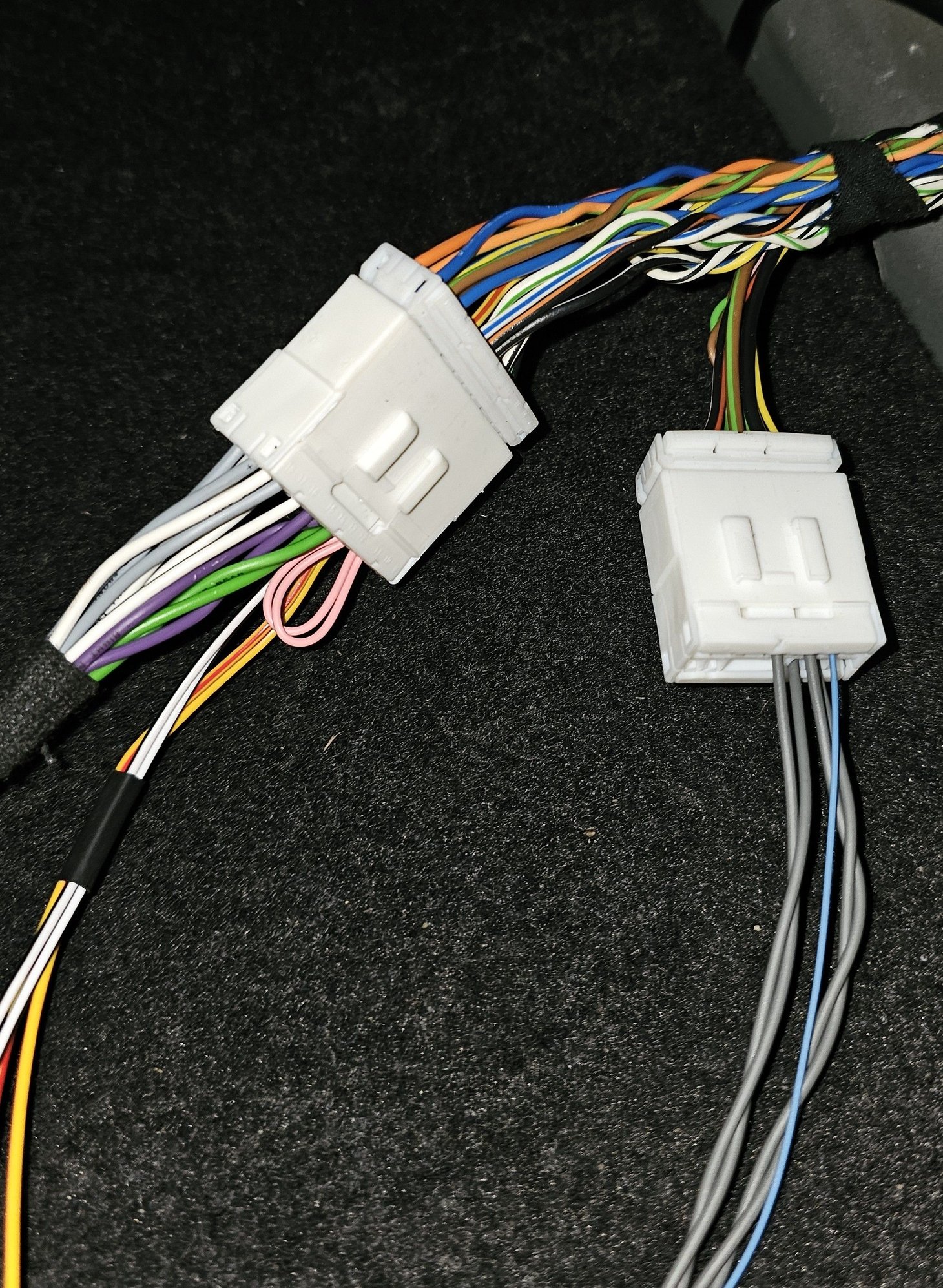

On the radio side I'm still waiting for my connectors to come from Mouser, but I've at least figured out that I need to also link pin 20 of the yellow 26 way connector to the illumination wire on my new radio in order to get the dimming function to work properly. The incartec harness connects the illumination line to the parallel 12V ignition feed so the radio was staying permanently dimmed when plugged in initially. Note, TE are axing the AMP Multilock series, so soon all we will have are questionable clone connectors.
I wanted to fit the DAB aerial at the very top on the drivers side of the rear screen, so I ended up removing the rear quarter panels in additon to the rear bench seats. The headlining, rear parcel shelf and A pillars are getting re-ulphostered soon, so it looks like I've done half the interior removal for them. I also stripped out the PSE to centre console harness, the long dead PSE and BTUM module, JAGCD-HF BT module and harness, so maybe 1kg weight reduction
I'll steal the PSE harness centre console connector to get the mic hooked up with the stock wiring. The new mic fit in the original housing better than the original, since it didn't have a PCB. Mic quality is adequate from what I've tested so far.

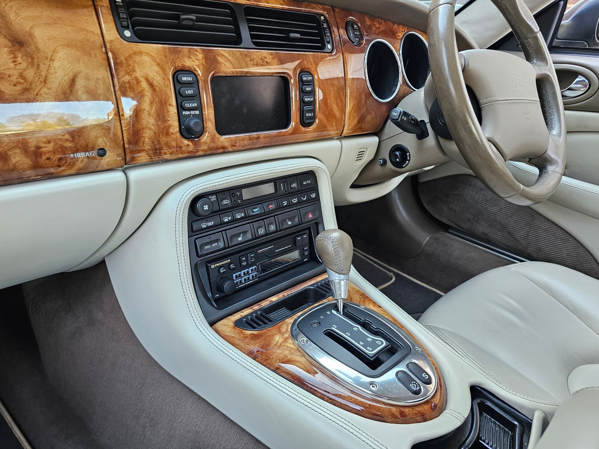

Work has been crazy for the past month or so and will continue to be for a while, but the weather has been nice recently so I had to at least get the stereo working!
It matches the interior really nicely, unlike some of the modern single DIN units you'll find. The lights are also adjustable so it matches the stock lighting at night perfectly.

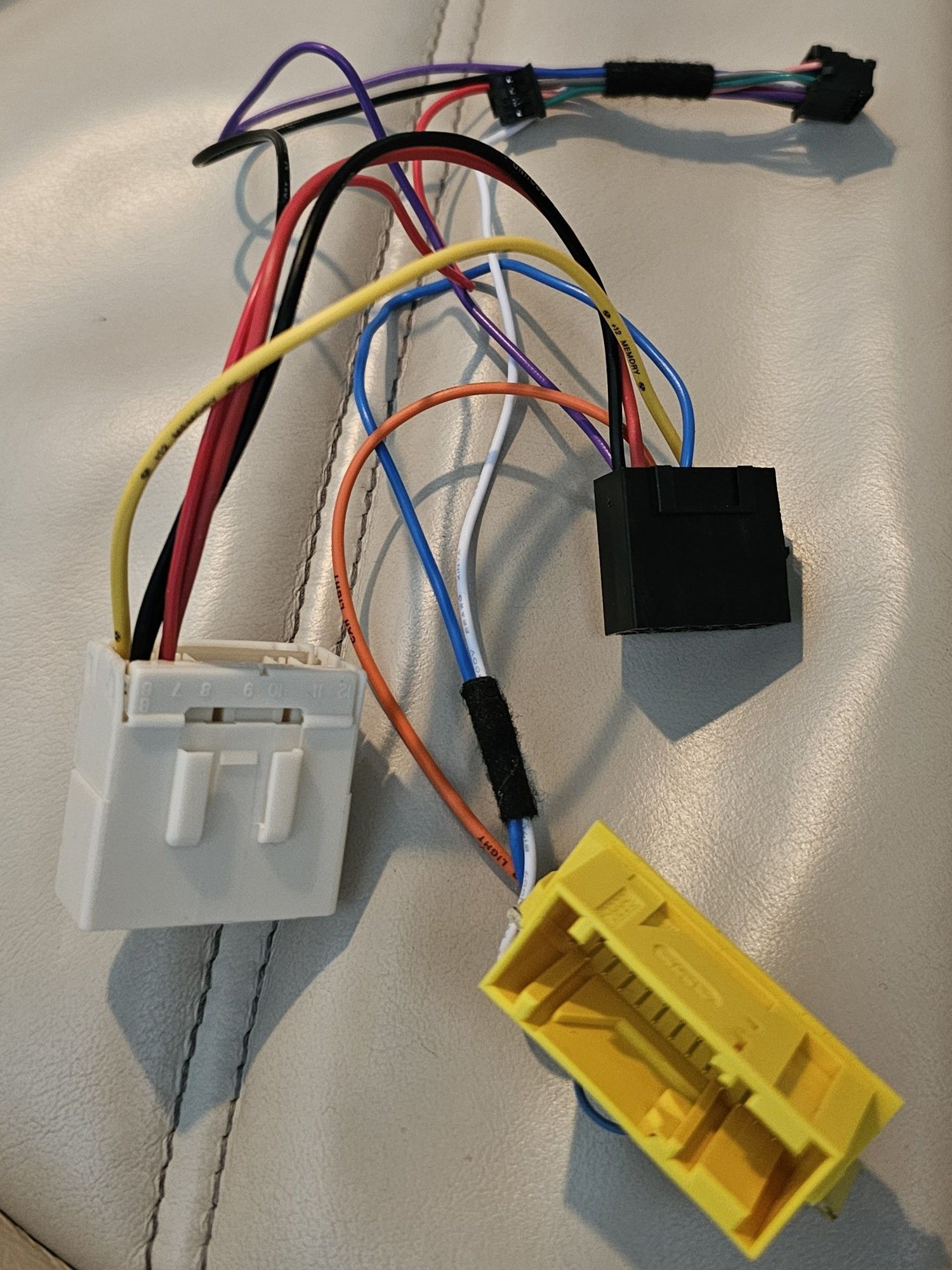

Behind the scenes, I have a few adapter harnesses that I made up so I didn't have to touch the stock wiring.
First, we have the 20 way radio connector, this connects to a Perfboard mounted connector where I've linked out various pins which do the following:
- Send the IGN II signal to the back where the Pi will be
- Illumination control (not wired on the incartec harness)
- Steering wheel controls
- Antenna power
- Subwoofer power
- Nav screen power switch
All of the extra functions are using the now spare telephone wires on this connector that run front to back.
Not pictured, a plug to replace the phone harness under the centre console. This:
- Has a pigtail that runs to the microphone port on the radio, uses the factory wiring/location for the new mic in old housing.
- Loops the IGN II Run power that used to be provided to the phone module, back to the radio harness then through to the Pi in the rear.
- Connects to a switch in the centre console that controls the Nav monitor.

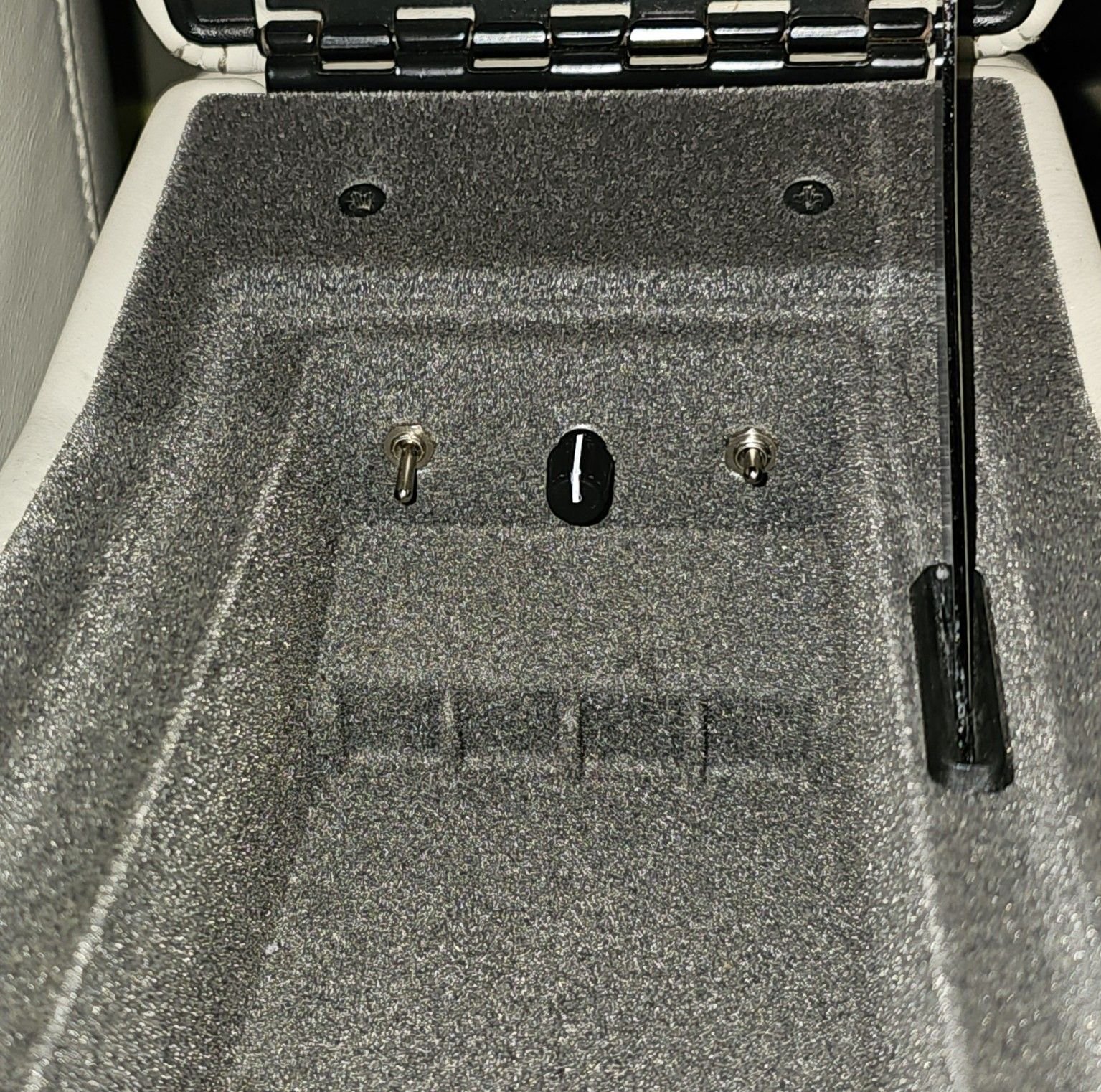

Centre Console, left to right:
- Antenna control
- Subwoofer Gain (A nicer knurled pot. knob is in the post)
- Nav Monitor On/Off

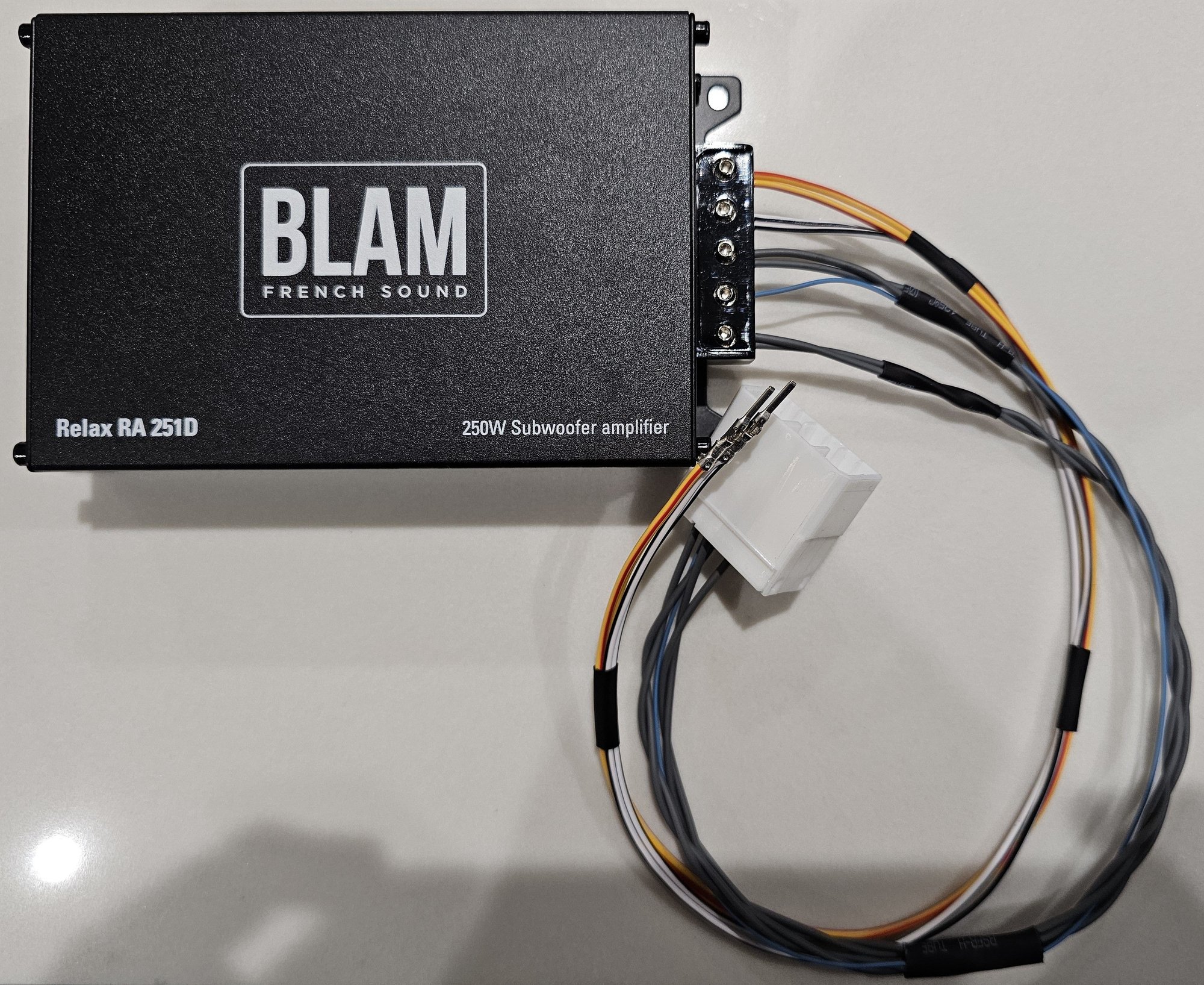

Subwoofer amplifer:
I'll have to pull a feed from the battery when this gets swapped for the DSP amplifier, but the stock 30A feed will more than suffice for now. The subwoofer coils are linked in series (pink loop on amp connector) as I wanted to give the amp a 4 ohm load.
