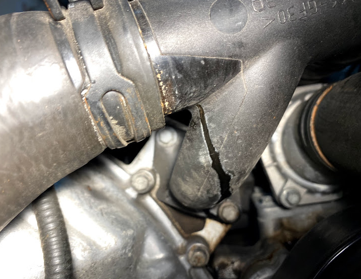

Originally Posted by Gus
Look at your pump and crossover pipe. Both pressure and temperature is a factor in the leak. The pump has a weep hole Located under the pump.
Link to pump and crossover R&R http://www.jagrepair.com/WaterPumpCrossoverPipexk8.htm
GOT IT IN ONE! What a champ.
I really appreciate this community, the folk at MBWorld are substantially less knowledgeable/helpful, and the fact that the classifieds aren't separated from the vehicle subforums means you're always trying to slog through people trying to hawk their wares...
