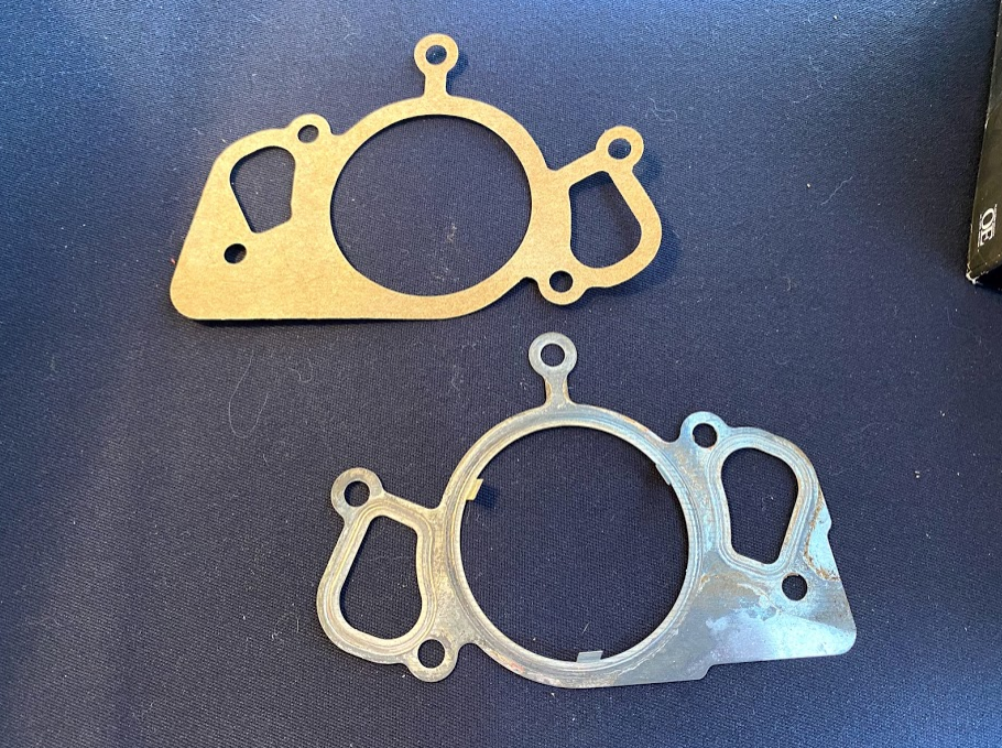

Today's the day to put the new water pump in; thank you Gus for this input:
Originally Posted by Gus
I have in the past reused the metal gasket but know to check it for leaks after the install. That is provided it is not bent or damaged.
Here are the gaskets I have; new paper gasket on top, old metal gasket on the bottom:
Old one has a bit of corrosion but maybe it can be scrubbed away...?
To recap on the situation; the new pump came with only the paper gasket, the old pump was removed from the engine with the metal gasket shown.
I have a tube of Hylomar Blue, my assumption on the correct application would be to apply the Hylomar to both sides of the gasket, and then sandwich the gasket between the pump & engine.
Does anyone else have any opinions on which gasket to use, and if my Hylomar use is correct? Cheers

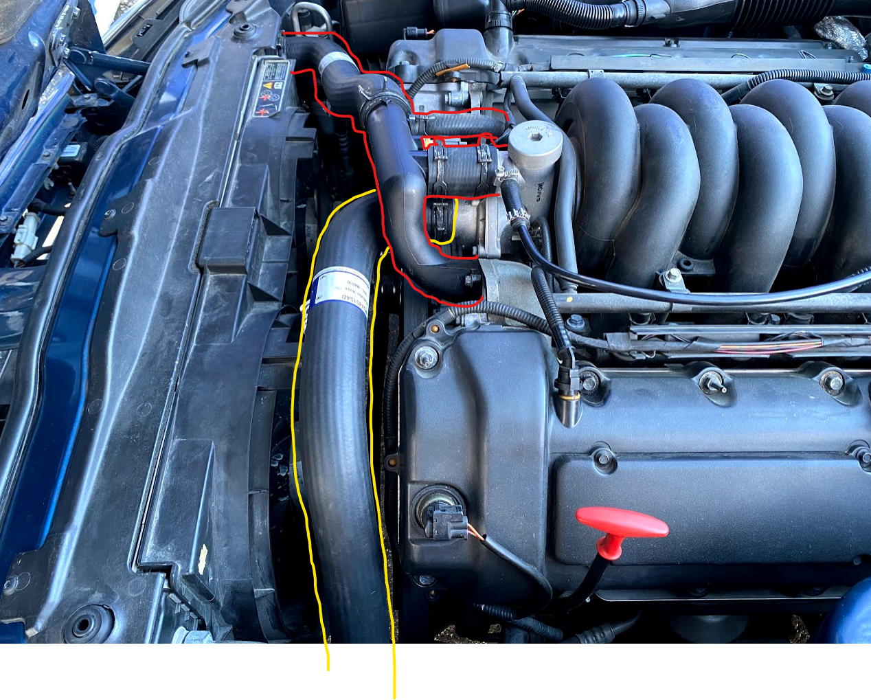

OK, water pump replaced, crossover replaced, front hoses replaced. Odd thermostat question:
I've driven the car around a number of times for short trips (running a coolant flush through over a period of days).
So far I've struggled to get the car past 203F; most of the time it's high 180s-mid 190s. Fans have come on only one time.
After a drive, the parts highlighted in red are too hot to touch for even a moment - but the hose highlighted in yellow I can comfortably rest my hand on. I'm assuming this means that the engine hasn't got hot enough yet, thus the thermostat hasn't opened, and thus the fans haven't come on. Am I being concerned about nothing here, or does the thermostat potentially need replacing?
It's less than 3 years old, was replaced when I replaced the shitty plastic thermostat tower with an aluminium one...

A new thermostat sounds .. In order.. do yo uh have a cheap heat gun to take temps wit hbk to confirm.. because I believe your system should be cycling at a temperature lower than one that should be able to burn your hand to the touch of a hose...
for a few bucks and a few minutes of your time ... change the thermostat and see whts up from there three years is definitely long enough to justify a new one imo
Good luck Tom
