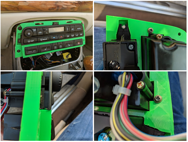

Just did a first test fit with the printed piece; some gaps on either side of the accessory buttons that I'm not fond of (and as mentioned, no "chin" at the bottom) but overall, I think it's looking good!

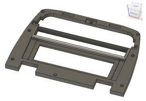

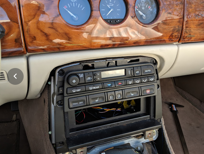

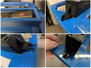

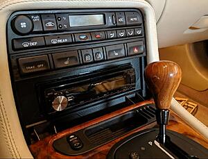

Working on a variant of my 3D-printed stereo/CC bracket - in this iteration I have a small door that can be lowered in front of an aftermarket stereo (will cover that either with walnut burl or a similar tone of leather) so that I can still have a modern stereo, but I don't have to look at it. Given that I have steering wheel controls in place I already have most of the functionality I need without needing to access the unit directly.
You can see the small gap above the radio, and the pegs on either side that would allow the fascia to be slid back in place above the stereo.
Could someone with a stock stereo please take a photo of your vehicle at these two angles so I can compare the gaps above/around the climate control unit, and between the stock radio and the leather surround? Also interested if you have an aftermarket stereo - could you please take a photo of where your bracket fits against the walnut burl shifter surround at the bottom. Cheers!
Also this print was done at too high a temperature and I've done no finishing whatsoever (think of this as a draft-quality print) so I am aware the stepping around the middle row of buttons looks a bit crap

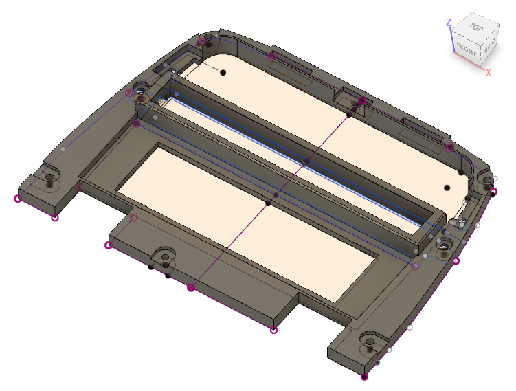

Oh, here's what the bracket looks like in Fusion 360 at the moment -

Originally Posted by Tom Baker
Could someone with a stock stereo please take a photo of your vehicle at these two angles so I can compare the gaps above/around the climate control unit, and between the stock radio and the leather surround? Also interested if you have an aftermarket stereo - could you please take a photo of where your bracket fits against the walnut burl shifter surround at the bottom. Cheers! ...
Tom I shot several pics and put them in this album for you. Let me know if you need any more specific.
