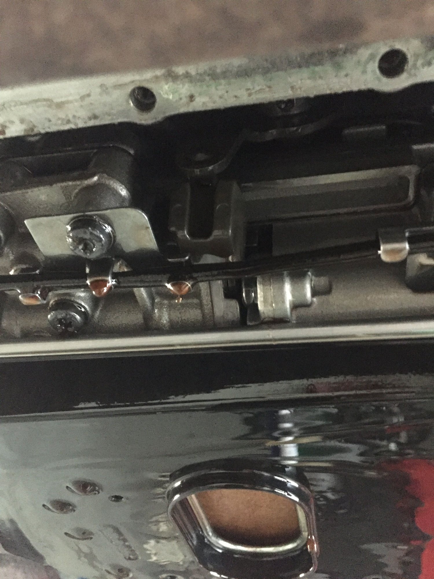

Default ZF5HP24 ATF changed and Transgo PR Valve in
Many thanks to this forum, both past and present members, as after months of planning, I finally got stuck into changing out the gearbox transmission fluid and installing the Transgo pressure relief valve.
Temperatures are climbing in the Middle East, as summer approaches, and I'm sometimes driving all day, from one meeting to another, all over the island of Bahrain. When the XK8 is on a freeway, going uphill into traffic, the gearbox would occasionally stutter going down from 5 to 4, and then sometimes stutter from 2 to 1 to a stop. That made me want to sort out the ATF change this weekend. Good rule of thumb I find in life, don't let small problems get large.
There's a lot of info on this forum on this Automatic Transmission Fluid (ATF) change job, and I also had the Transgo pressure relief valve to install as I'm in that area of the car doing the ATF change. As I didn't have access to the usual ATF supplies, like ZF ifeguard 5 or Mercon SP etc., I went with LiquiMoly ATF 1200 for the fluid change. I bought 8L (and finally used 7.5L more on that later).
This weekend, I persuaded a local indy Bahraini garage specializing in Land Rovers, to let me have their 2 post car lift for Saturday morning. I really didn't want to be on the flat of my back under the car, like Rev Sam's Youtube video, as you also need the engine running when you refill the sump. I had my wife's friend's young boy to help, as I've been persuaded that it's beneficial to teach this smart young kid about cars. He was absolutely fascinated with the job, and he'll probably not see this type of job for another 10 years. Working with hands above your head at my age can be really tiring so a second set of hands was useful.
I checked I could remove the filler bolt before draining. There's not much space between the ZF gearbox filler plug and the exhaust. Note for future people, it's best for your skin to do this job from cold, but that was not really practical for me as I drove the car to the garage. The old ATF fluid was black and obviously hadn't been changed in eons, and removing the corroded T27 sump pan bolts wasn't easy, but I had a set of new bolts to replace the old. The old sump pan gasket was totally shot and broke into pieces. as I removed it.
However the garage had a smart little tool, to fit the filler cap, that fit between the gap between the gear box and the exhaust pipe, that made things a lot easier.
There's a lot of T27 bolts to remove both in the sump pan and the valve body so I would advise to have at least 2nr T27 torque bits as you can easily strip the tool.
Transgo had given this forum the instructions in PDF (copy attached with this thread for ease of reference). My advice would be put the Transgo paper plan in a plastic cover, as the dripping ATF fluid really makes a mess as you try to compare the bolt pattern on the paper plan with your view of the car. I have 2 further hints to add to the info on this forum.
1. There's a guide pin connecting the top and bottom halves of the valve body which means even with all the bolts out, it's a mm by mm wiggle to remove the front lower valve body part.
2. Take note of the gear selector rod location, and make sure when you re-install the valve body it's properly attached in the right location. I found that out to my horror, when I tried cycling the gears during the initial refill, that the gear stick wouldn't move. I had to go backwards, drain again, take off the sump pan & filter, loosen the valve body bolts, to get enough wiggle room, to attach the valve body's selector rod to the pin.
If I didn't have the selector rod issue the entire job would have taken 4 hours and it was long overdue in my car. Initially I put in 6L of the new ATF, but due to the selector rod issue, I ended up re-filling with total 7.5L.
On a long test drive all went well without any crashes/bangs/stutters from the gear box. Seems that job done!
