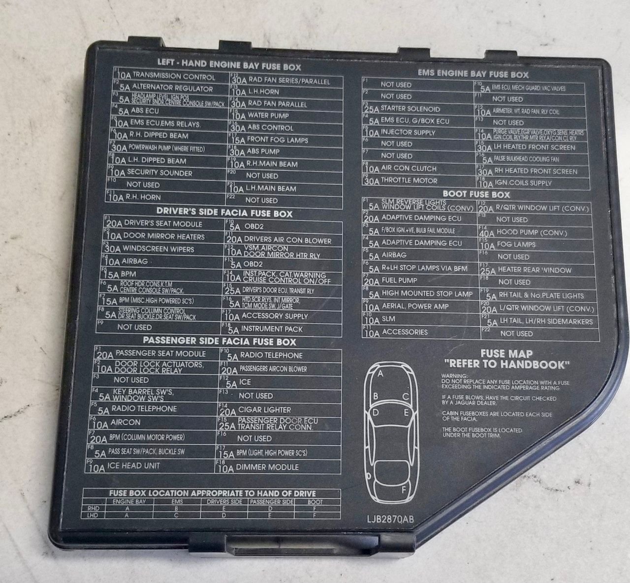

I can't help to notice you didn't mention checking the fuses...
Good catch.
I checked every 5a fuse just to be extra certain!

Just to confirm, there are two 5A circuits for your brake (“stop”) lights in the boot fuse box.

The Stop Lamp Relay powers the LEFT/RIGHT stop lamps and the HMSL BOTH but through different fuses.
If fuses are good, then the HMSL or the wiring is faulty.
