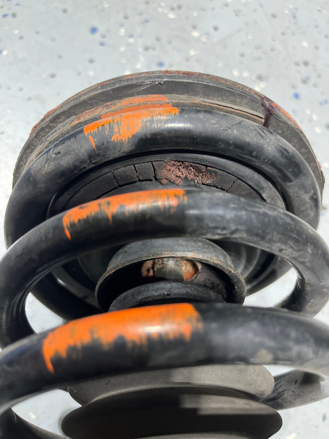

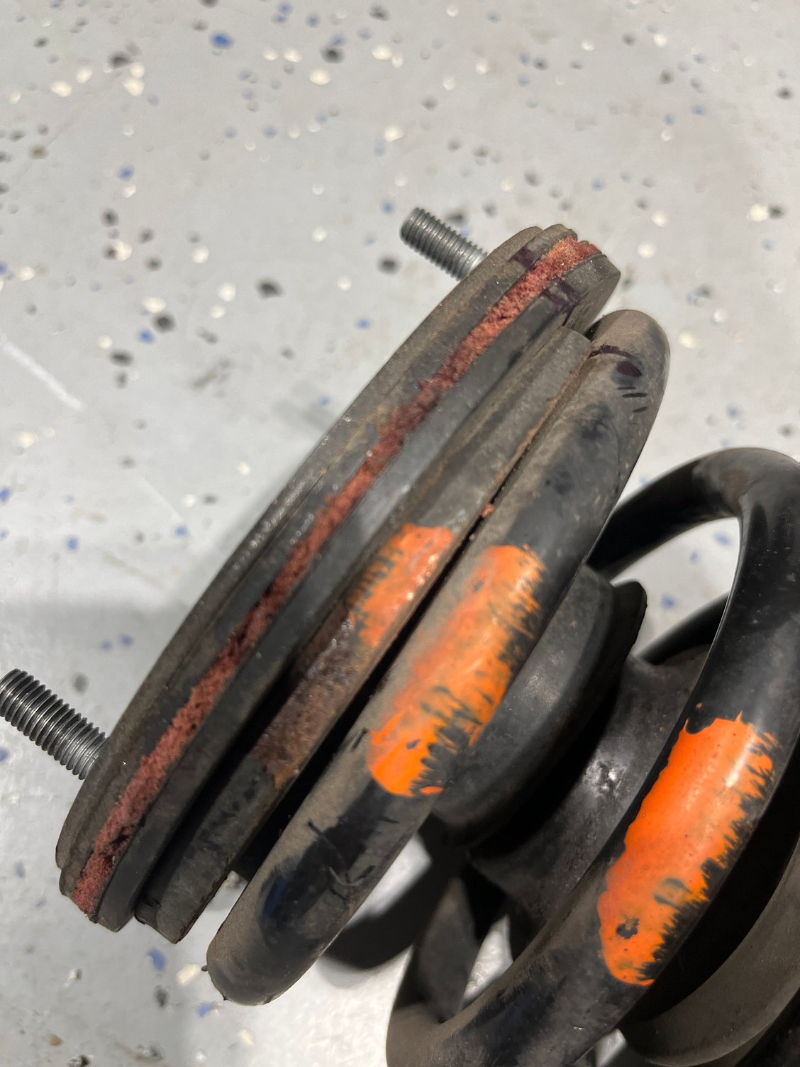

ship, I don’t wanna wait that long. I wire brushed the head of the bolt and it’s marked with “atlas m 8.8” original part number I found for the bolt is “fb110171j” . Could I just get a flanged bolt of 8.8 grade zinc coated same dia and length at ace hardware and move on? Any thoughts welcome. I’ll toss in a few pics of why I’m doing all of this, for anyone who needs a giggle or a cringe or is wondering why they hear a “clunk” sound hitting bumps….

Any 8.8 bolts with the same proportions will be fine.
Those isolation mounts are really bad. Are they the originals? How many miles has the car done?

As far as I know they are originals. It’s a 97 xk8 69000 mi. I’ve been updating everything I can, replaced original timing chains tensioners and guides, I still have the nikisil lined motor but it’s doing just fine. I even replaced the original fuel filter when I got it lol. I have new billestin shocks and mount bushings from PHOBMAN to go in, as well as tie rod end, all control arm bushings, and upper and lower ball joints, now I just need to get new bearings.

The same year as my XK8. I believe that the original isolation mounts usually last longer than 69k but I agree that yours are definitely living on borrowed time.

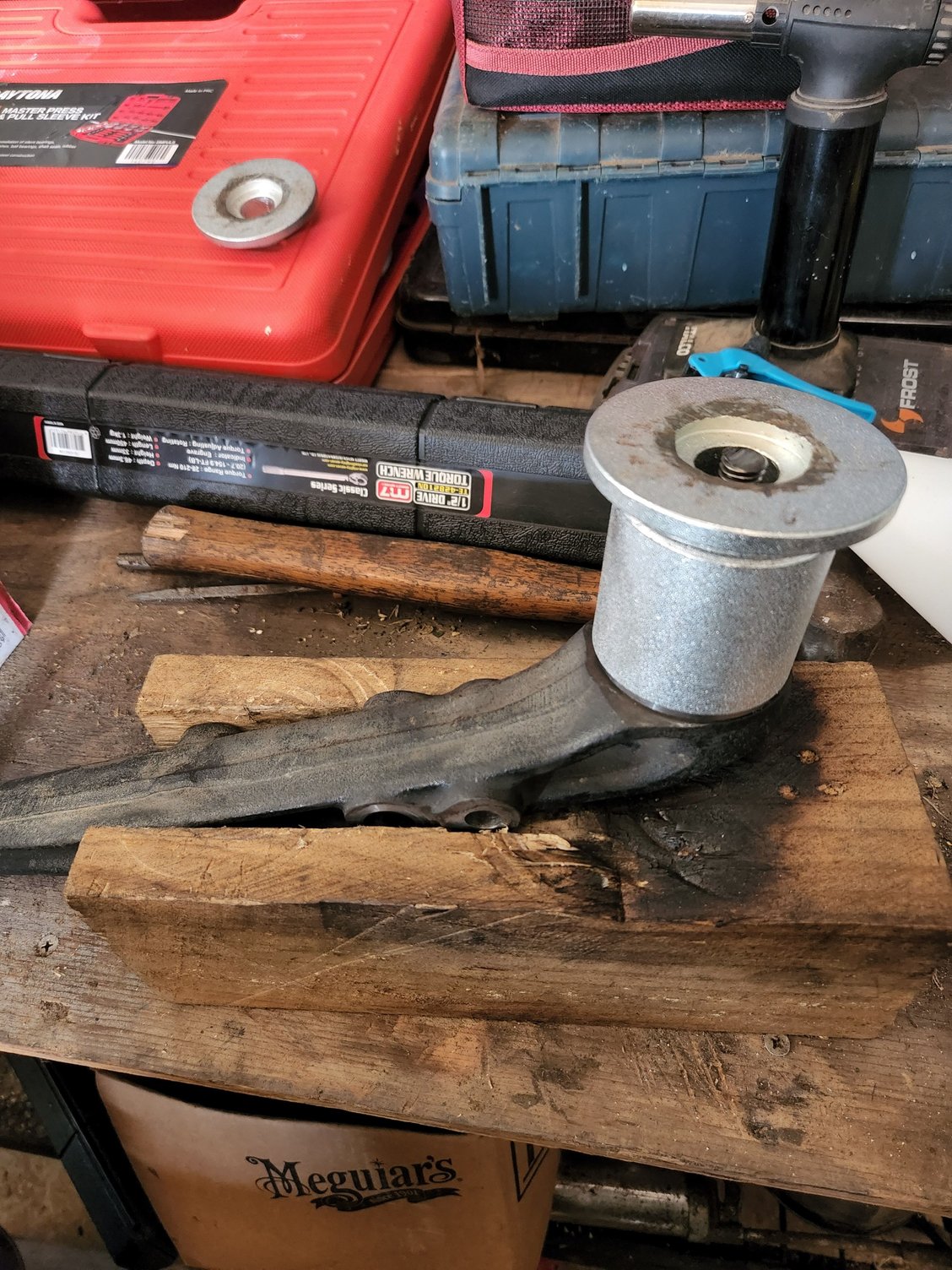

I fitted my lower ball joint by fabricating a crude cradle out of a piece of pine post to hold the arm. I froze the ball joint overnight and heated up the eye of the arm then used a press tool to hammer the ball joint home. Worked a treat.
