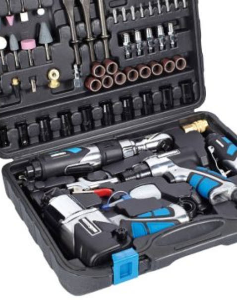

I bought a set similar to this one, that way I always have more tool than I need.
