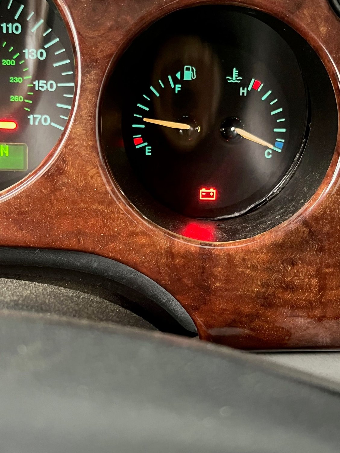

Old Jan 22, 2026 | 08:55 PM
Pantera928's Avatar
Joined: Aug 2015
Posts: 377
Likes: 41
From: georgia
This is what i keep seeing. Not sure if this is related but I keep hearing a series of 5 beeps coming from the dash area periodically.
Old Jan 23, 2026 | 02:41 AM
dibbit's Avatar
Joined: Oct 2010
Posts: 2,064
Likes: 1,024
From: Spain
This seemingly unrelated thread explains how the battery light works - there is a separate output from the alternator which controls the light:-
https://www.jaguarforums.com/forum/x...1/#post2895376
